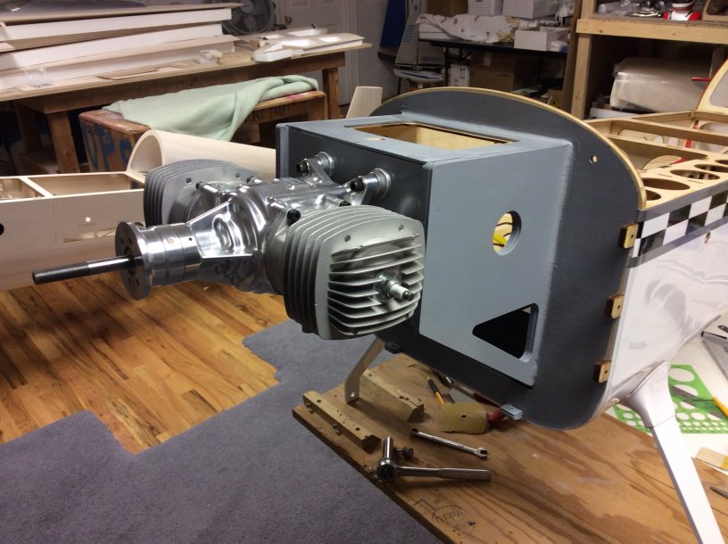

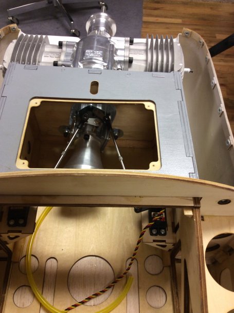

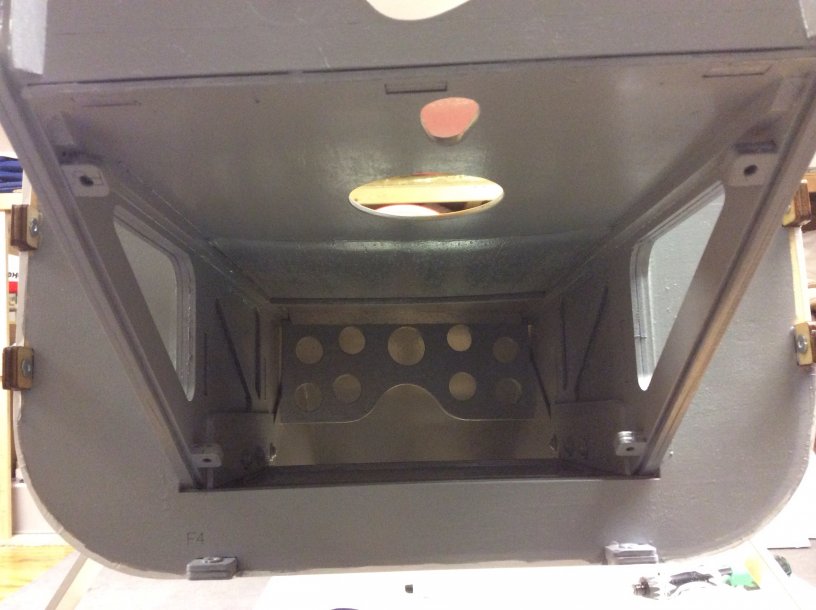

The rudder is finished and I have moved onto finishing the motor. I built the mount for the JMB canister. I took a piece of light ply and curved the back of the canister tunnel. I then filled in the side voids with 1/8 balsa. When that was all done I painted it grey with a clear coat.

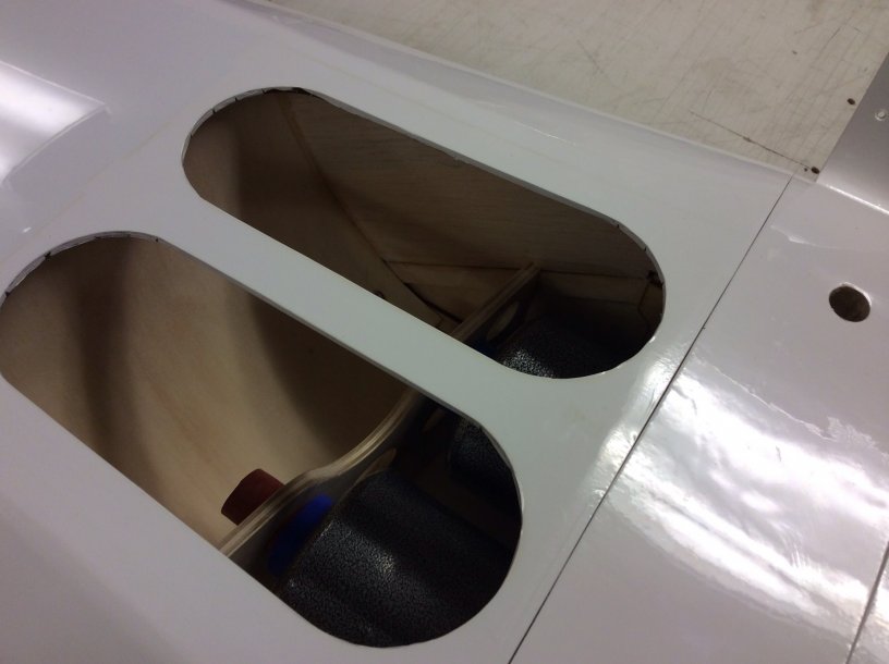

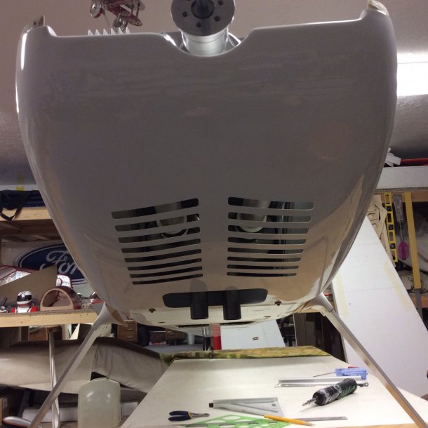

My good friend Jim came over and while we hung out he cut all of the lower air vents in the cowling for me. He did a great job, thanks!

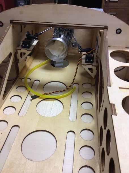

Used the aero works factory servo mounts and a 4 1/2 inch turn buckle so that I can get it programmed and adjusted perfect. I have been using turn buckles for some time now and really like the adjustability, resulting in a more precise programming .
