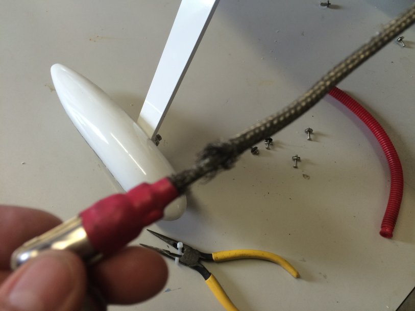

kork
I have replaced everything.
tried brand new powersafe receiver
2 new tech aero's
switched from pulse lipos to taildrager 123
new plug
tightened the spring on the cap
The only thing left I will try this morning is direct 123 to the ignition.
I run the same set up in 2 other planes and have no problems.
It has to be the ignition, my guess
I just want my AW freestyle back... ug
wasted a whole day farting around at the field.

kork
I guess I owe GSN members an apology.
I came out to the shop to try straight battery to ignition. I took off my plastic loom and walah....
I found my high speed miss and also my brown out/crash a month ago....
I will try replacing the boot but I think I still may want a new ignition.
I feel like MORON now
