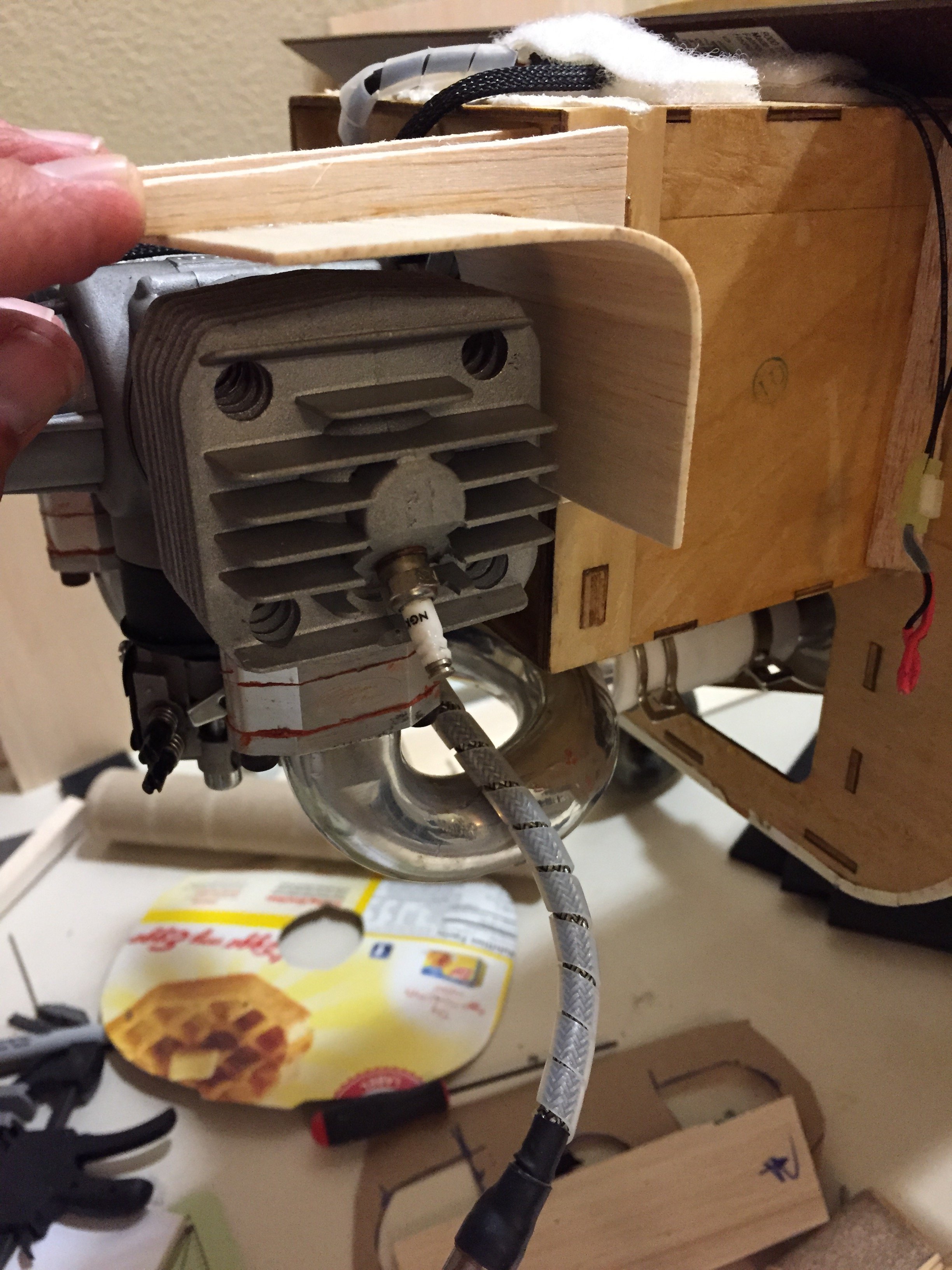

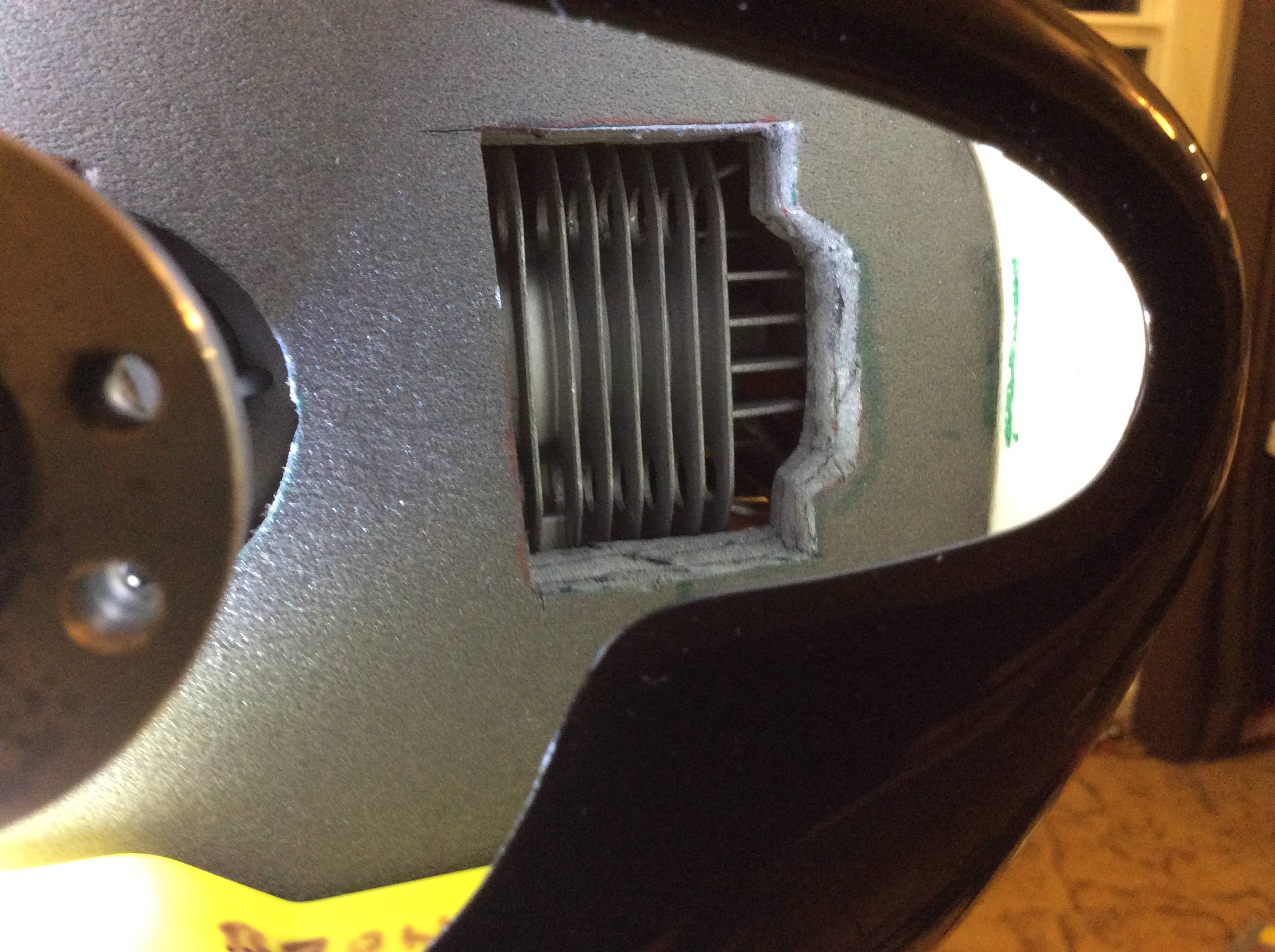

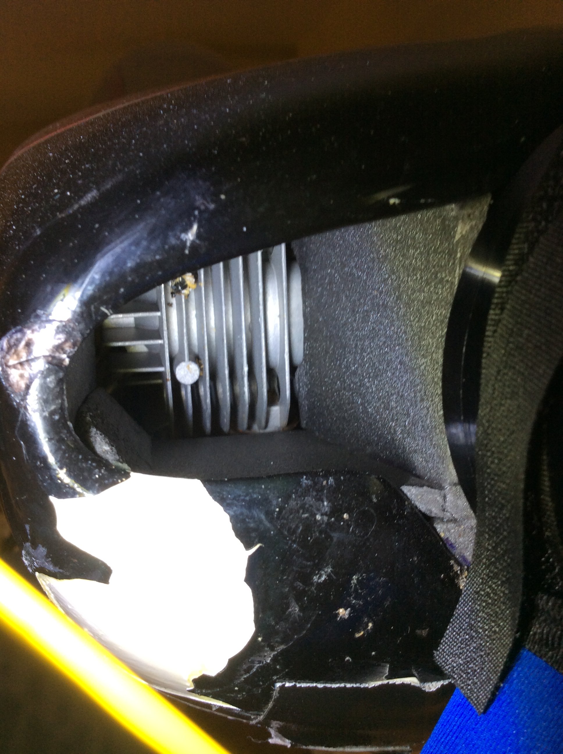

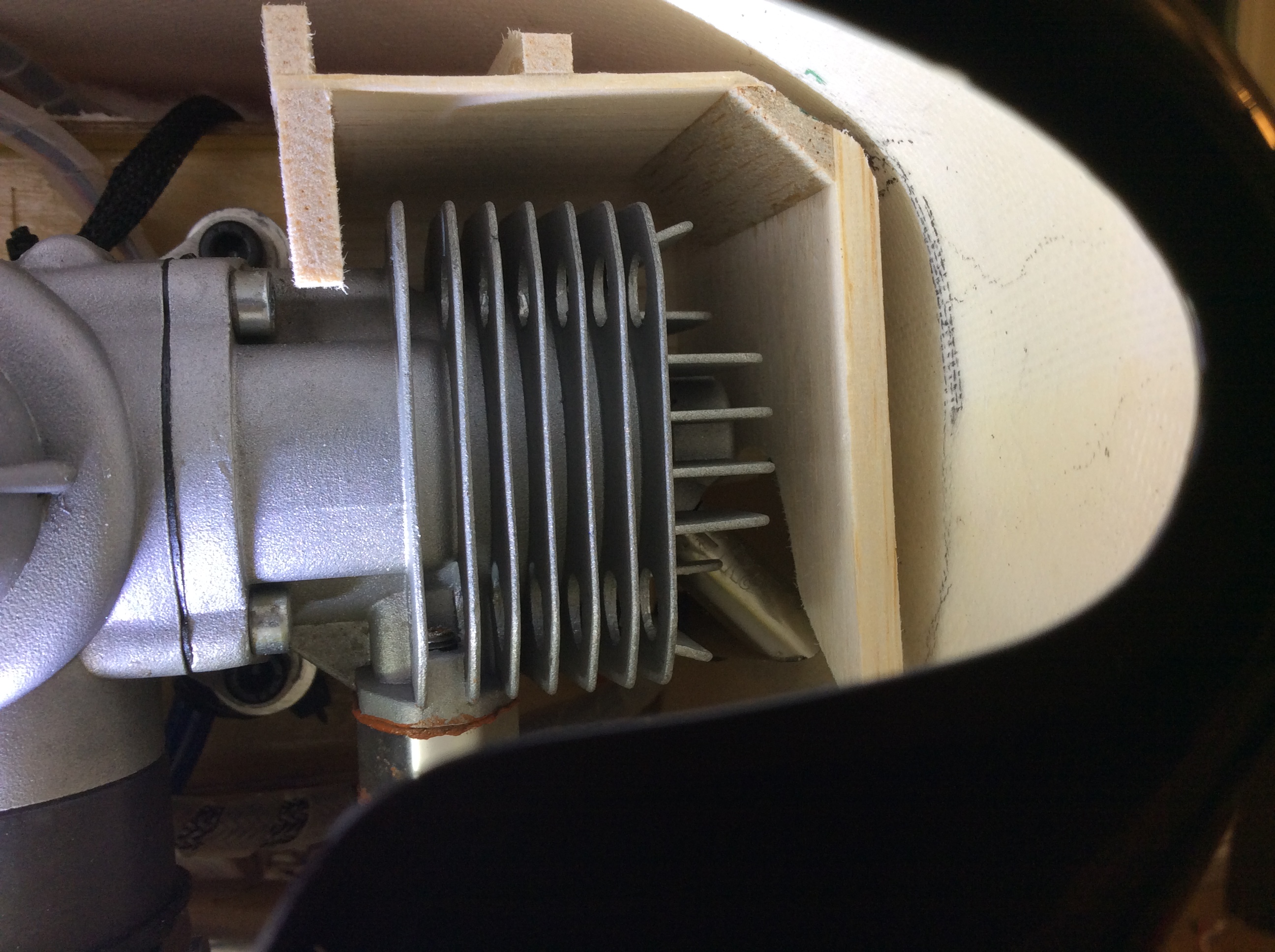

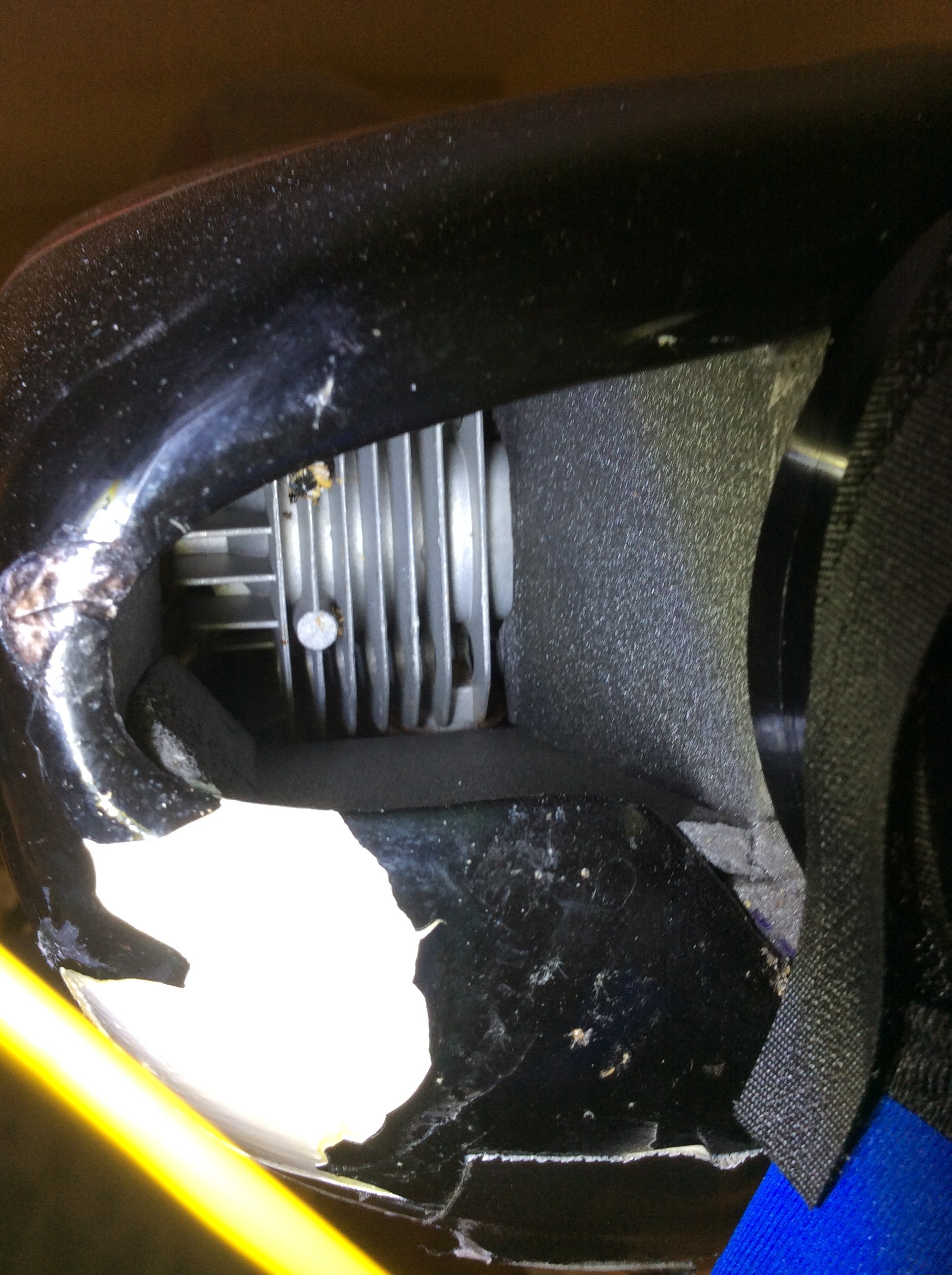

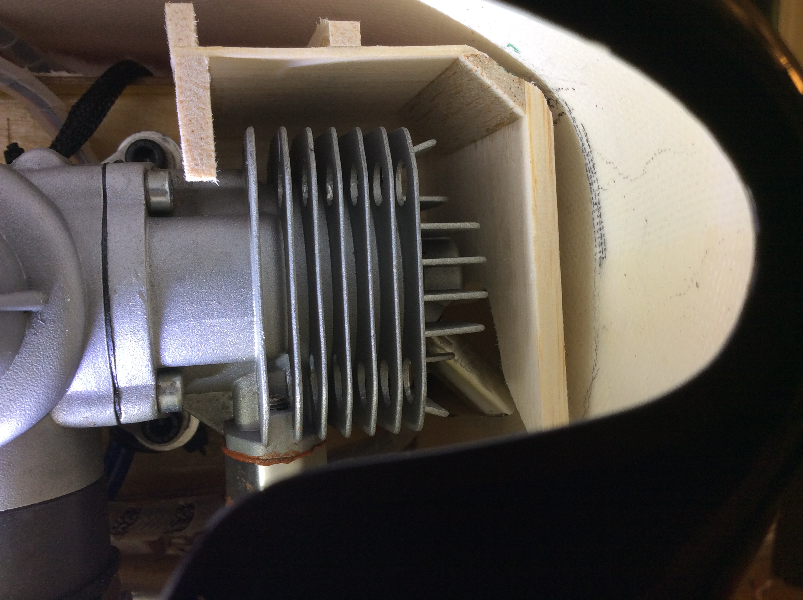

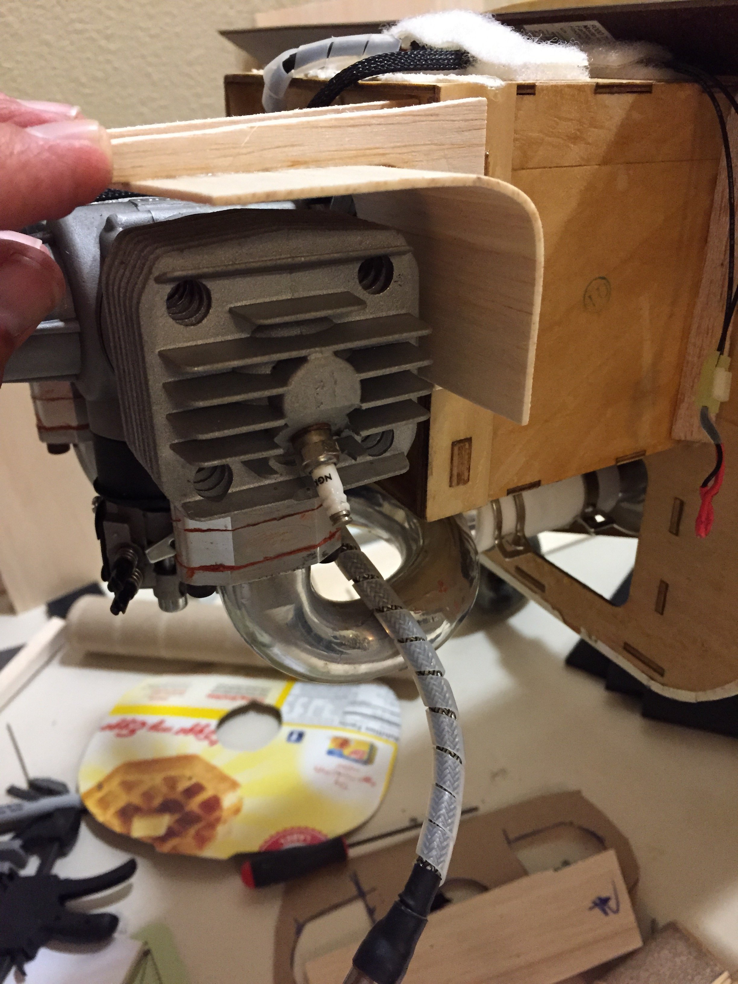

Just looking at the hole in front of the carb on the EF 78” extra and the VVRC 40. This was in 2014 when only the inlet holes were directed to the cylinders (typical baffling). Peak temps were 323F. Putting tape over the hole in front of the carb resulted in peak temps of 296F (27 degree reduction). I later changed the baffling to go around the cylinders (see pics below). While the peak temps didn’t change much, I saw a significant change in temps during slower less aggressive flying. Down to the 240F range (previously was in the 270-285 range). The best outlet condition I found was with the dam furthest forward on the cowl. I also tried Louvers over the area just in front of the landing gear. Again, most of the outlet data preceded the latest baffling of the engine. Also, my notes don’t show a significant change in peak temps regarding the different outlet conditions. Only a few degrees. Hope that helps.
Original baffling - directed to cylinder head:
Examples of different outlet conditions tried:

Latest generation of baffling that was the most effective:
D7452F3C-1D26-4AE5-933C-AF035DFF4DB5.jpeg A9DA50E3-54F8-4C0B-B606-88E4FDE71480.jpeg A4E332E5-EAB3-49E0-928B-00000E47A71D.jpeg
