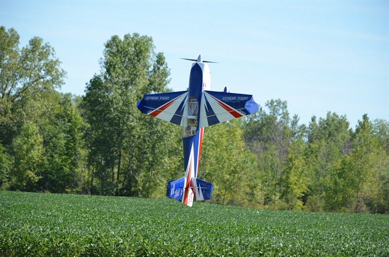

As a matter of fact I flew mine today. It makes me look good. Tracked on rails. I have about 3 gallons of fuel through the motor.
