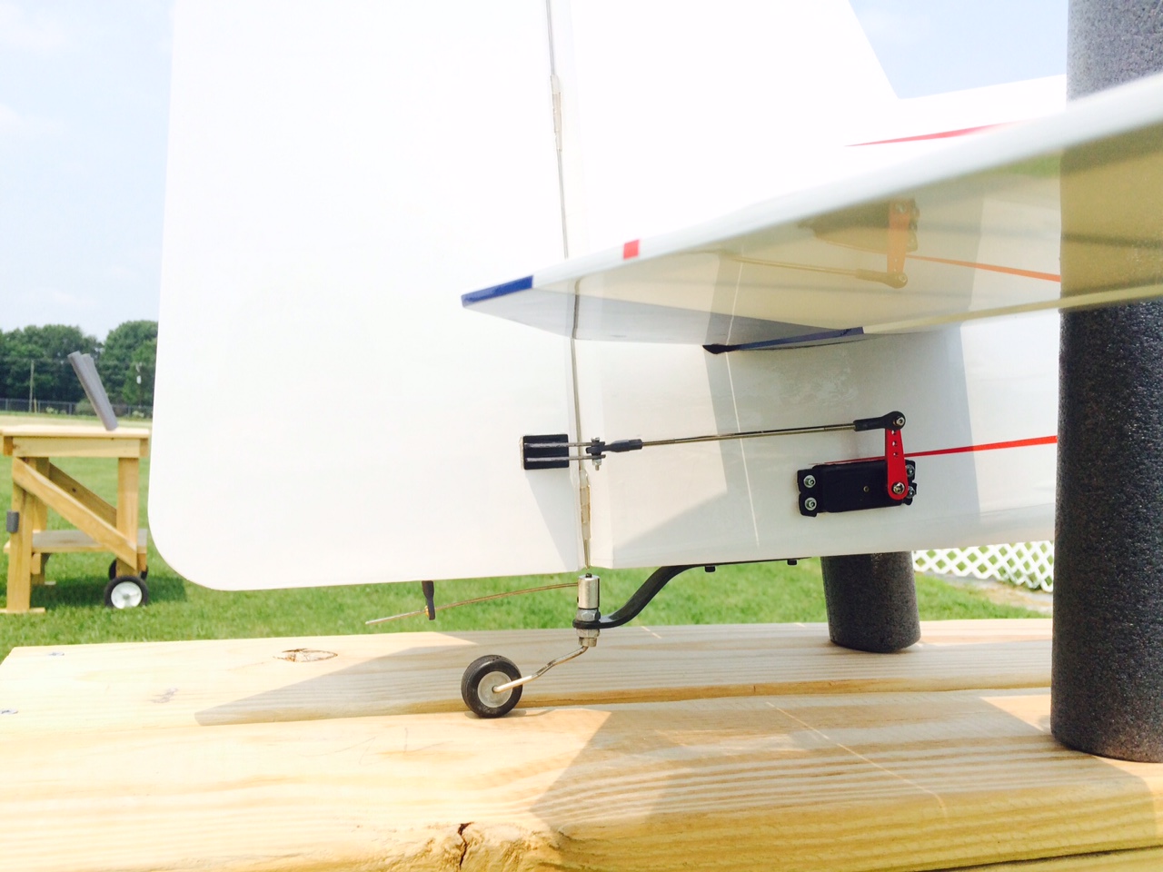

I'm in the process of building mine (v2)....I'm going with a tail mounted servo (Savox 1270tg) for the rudder and elevator, anyone have any thoughts?
Suds
Depends on your build to see if the CG works out for you. I mounted everything but the rudder servo and then attached it with masking tape to verify that it would work. It did for my build.
