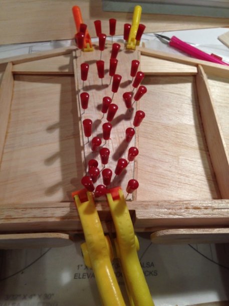

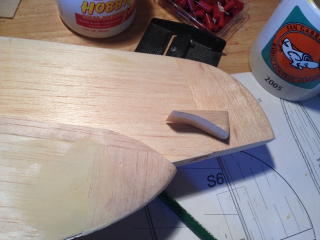

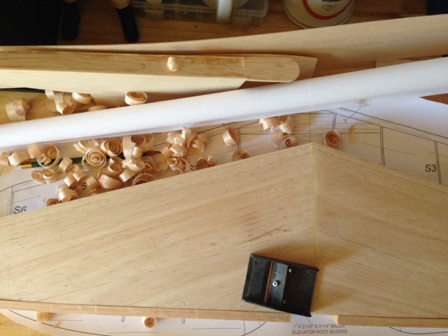

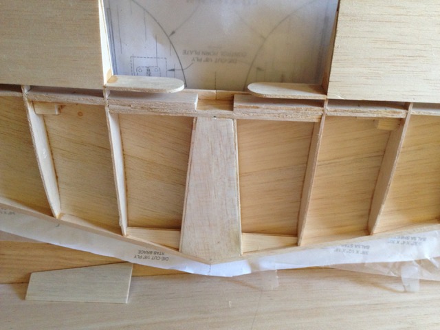

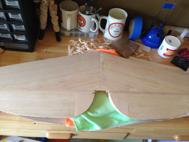

A photo with the extra balsa added for the center section. Looks like I just tossed pins on it! Feel better about it now. Skinned the bottom so now it's fully sheeted.

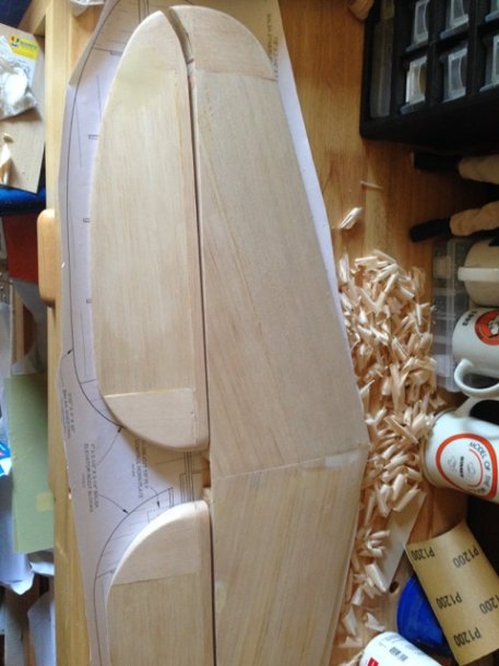

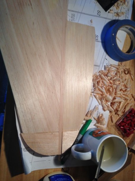

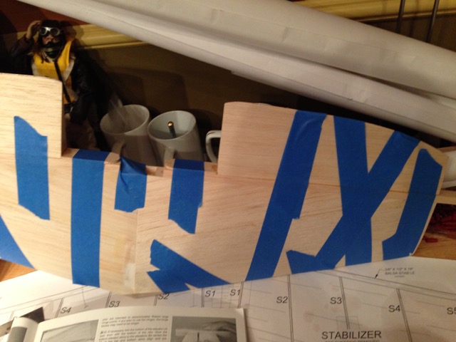

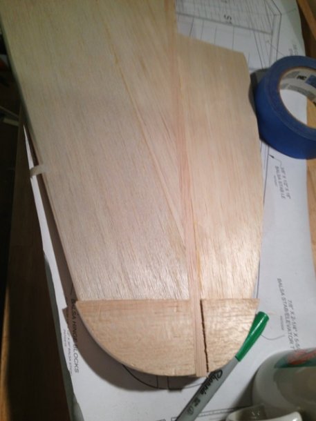

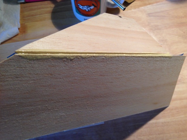

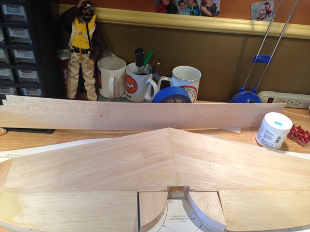

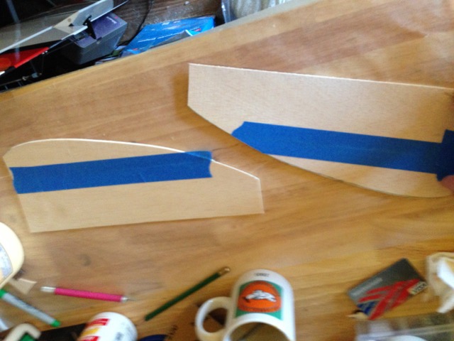

Glued the elevator leading edge to the stab with a couple drops of CA. This will be removed later. One of my favorite tools the razor plane was used to level it out. Then the elevators were glued to that with Titebond.
