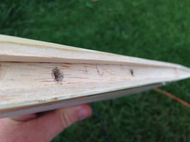

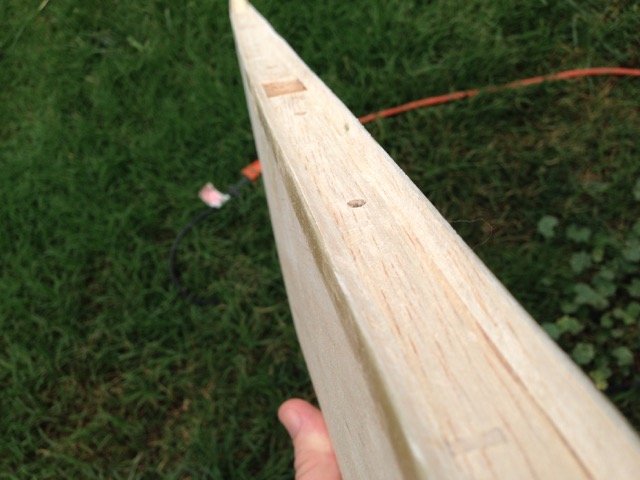

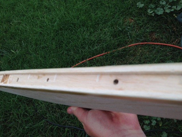

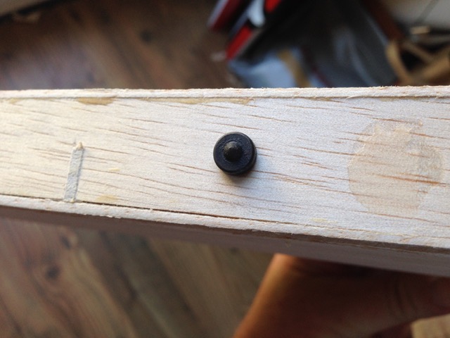

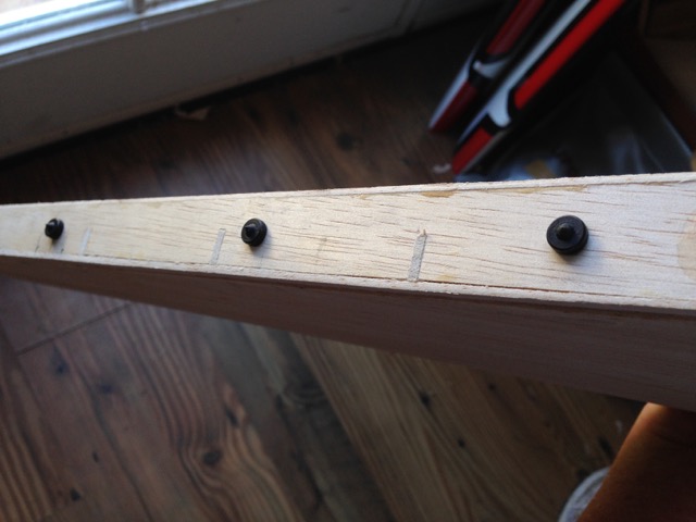

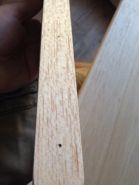

Now I needed to match up the holes with the elevators. Knowing this will most likely present some issues I put my thinking cap on and found some center punches at McMaster Carr. They were 3/16 holes and they had some 3/16 center punches. Worked great! Then I used the Robart guide to drill the holes. Doubt I am the only one to think of this but never seen it before.

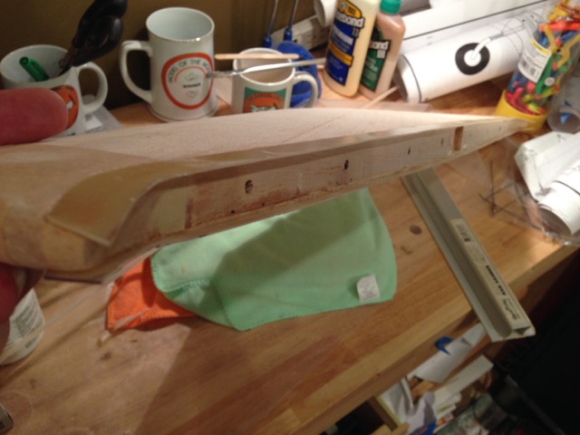

Cut some G10 to fit on the recess I made. This is for the shroud that is at the elevator leading edge.
On the real one on the inside it has a slight curve where the elevator attaches. So cut some balsa strips for that and tried to think of some whizz bang idea to sand a curve in it.

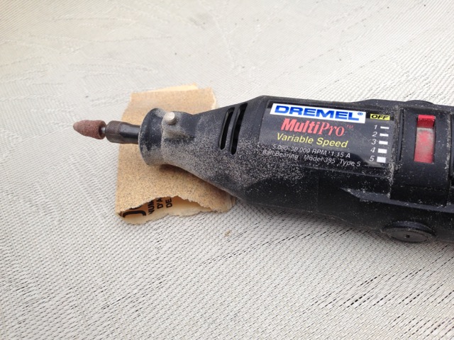

Tried to make some fancy hand sanding block with a dowel then remembered (usually after the fact) that I had a whole bunch of bits for my Dremel that have probably never been used. Found the one below and it made the perfect curve and was done in 15 minutes.

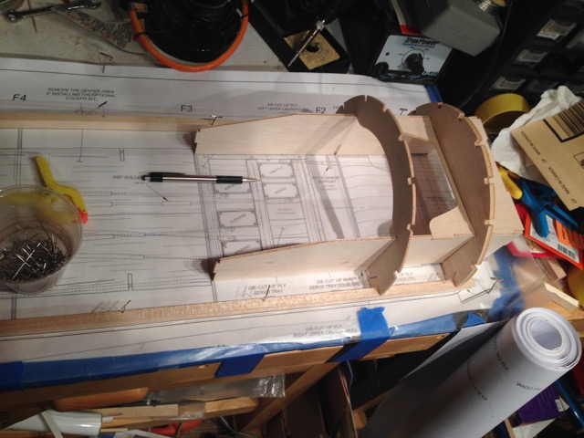

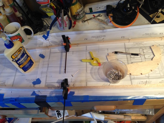

Got tired of looking at the tail so decided to start the fuse. Ran out of T-pins so had to run up to Jo-Annes to get some more. Funny how they manage to disappear. My son must have a stash of all my things missing somewhere.
