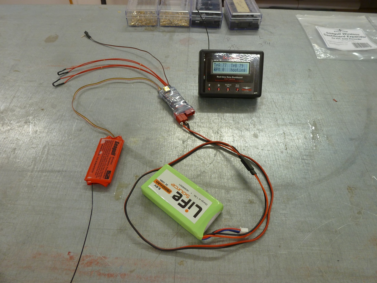

The Tele stuff arrived, spent a couple hours programming it, now to install it in the Laser.

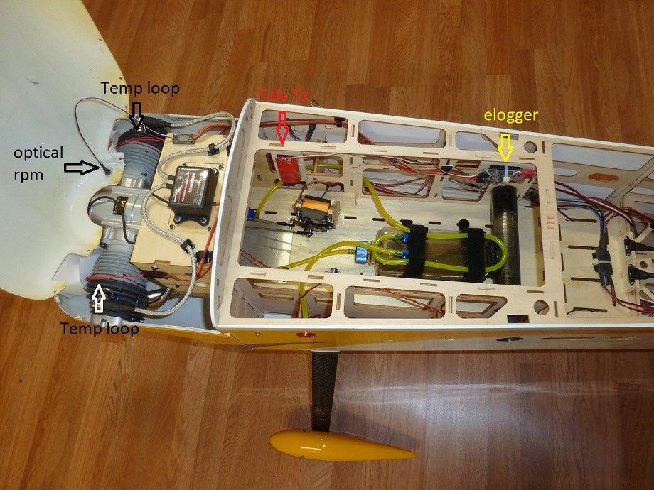

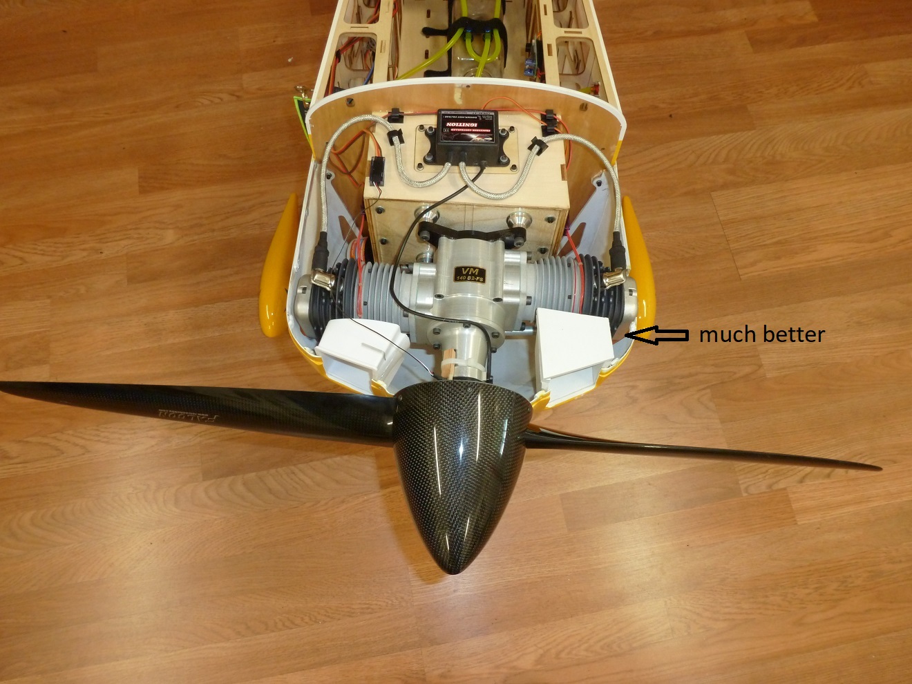

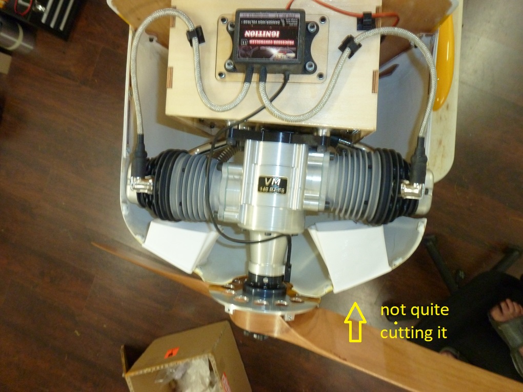

I have got six flights with the telemetry and everything is just as I thought. The baffles I bought are designed around a 120 two stroke and when installed put one directing the airflow a little to far inward. So I pulled that baffle and built a new one with that foam sheet stuff. The temps were running in an acceptable range, left 220° to 240° and the right 200° to 220°, the new baffle should make them even. The Falcon 32x12 is perfect but will get smaller as it breaks in, then I will switch to a 32x14. It still blows my mind at how balanced the prop and spinner was right out of the box, Tim is the man for sure.
And in case I have not mentioned it, I love telemetry! My spotter tells me what I want to know from the hand held Dashboard and later I download the recording to view on the LT.
