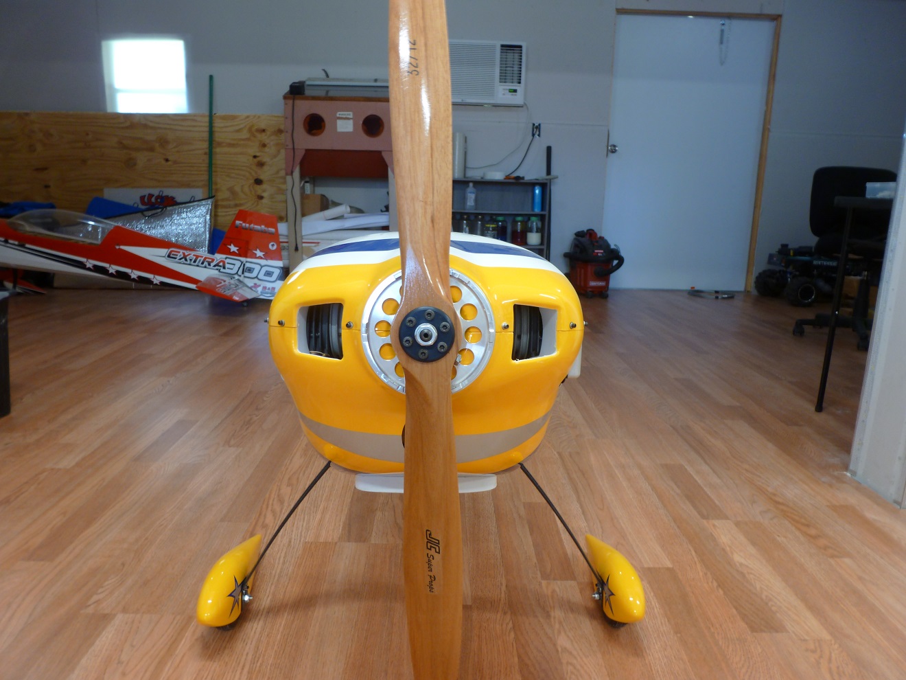

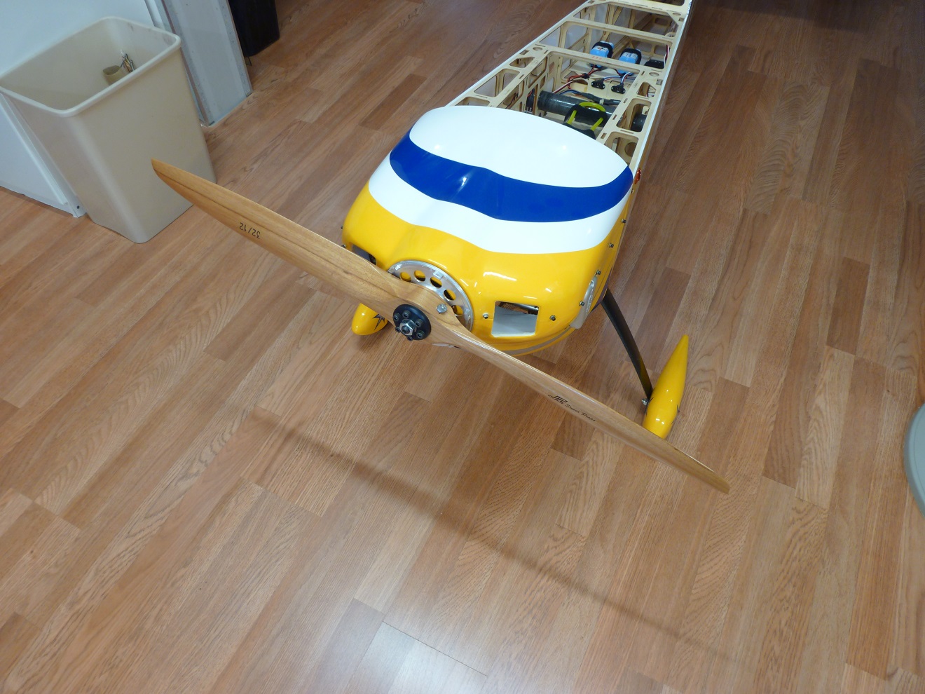

Here is a shot of the air intakes opened up. I sanded them back to the baffles, about an 1/8" around the perimeter but every little bit counts.
I noticed on the run yesterday that it felt like the prop was not balanced, after checking it I assume I forgot to do it. A couple coats clear on one blade and a small weight screwed to the hub and it is ready to go.
