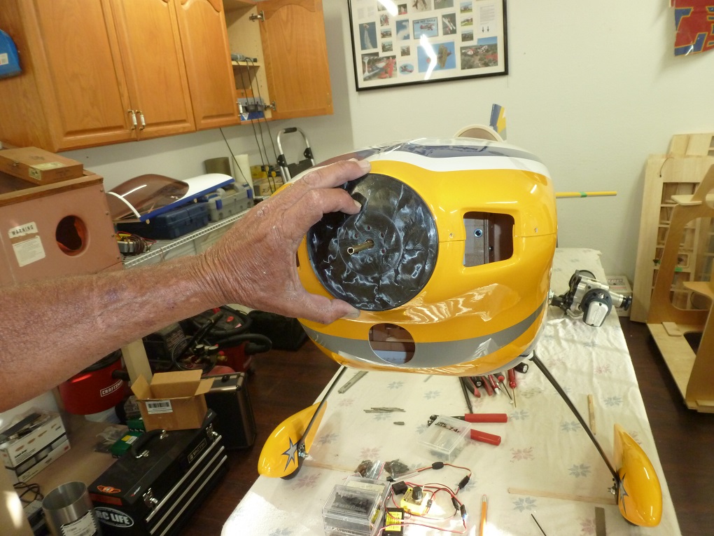

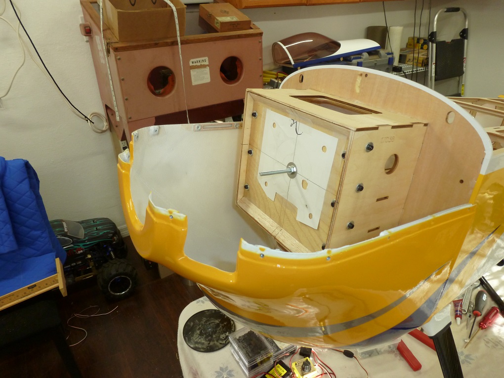

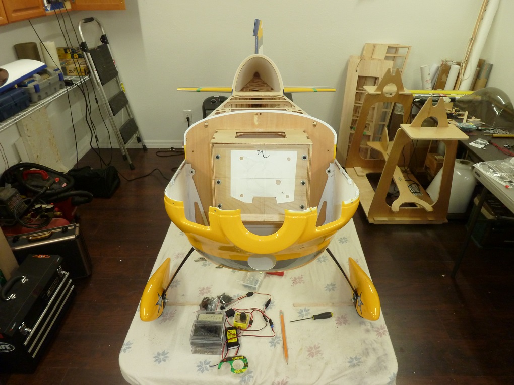

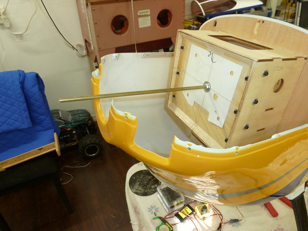

I made the engine mount template and taped it in place. Then I commenced to measuring, squaring, checking everything in every way. The final check that I like to do to is drill a 10-32 hole on center, then thread a 3" 10-32 bolt with washer and lock it in place with a washer and nut. Then I thread a piece of brass tube onto the bolt and check the alignment of the spinner, came out pretty much dead on.

Like your method of finding the centre of the spinner. It always amazes me how all do things a little differently but all come to the same results. Like your method hope to remember it when I do my next one thanks for shearing.
Have a question like the way you use the 10-32 with a brass tube to check if you got it correct but how did you get to locate the template or did you just use what the manufacturer suggested location .

I clamp construction paper to the engine mount plate then use an Exacto #11 to cut the bolt hole's, then I use a piece of aluminum (an old Exacto handle) with the end rounded to rub the plate's perimeter and any inner marking. The inner markings help to find the center lines and aluminum will leave a burnish mark kind of like a pencil in color and it does not take much pressure to do it.
