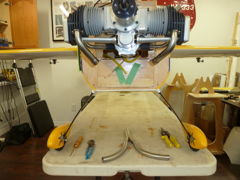

All the electronics, throws, and rate's have been completed. Working on the exhaust now and probably will be most of the evening. The green tape is where the two will become one and exit the cowl.
That is one positive thing about four stroke engines the exhaust is simple and light. And most of all sound good no mater how you pipe it. Looking good getting there slowly.
