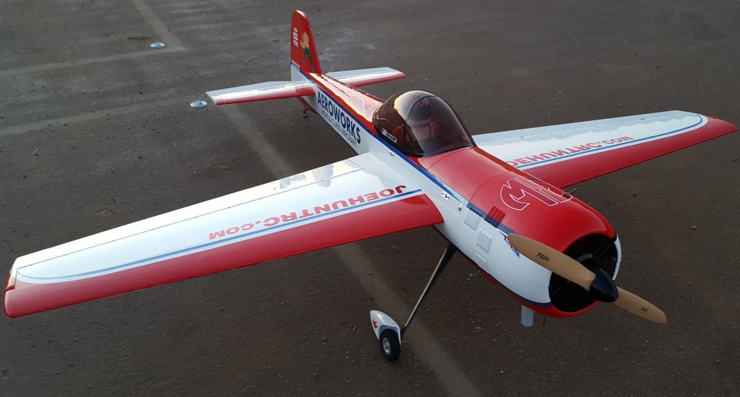

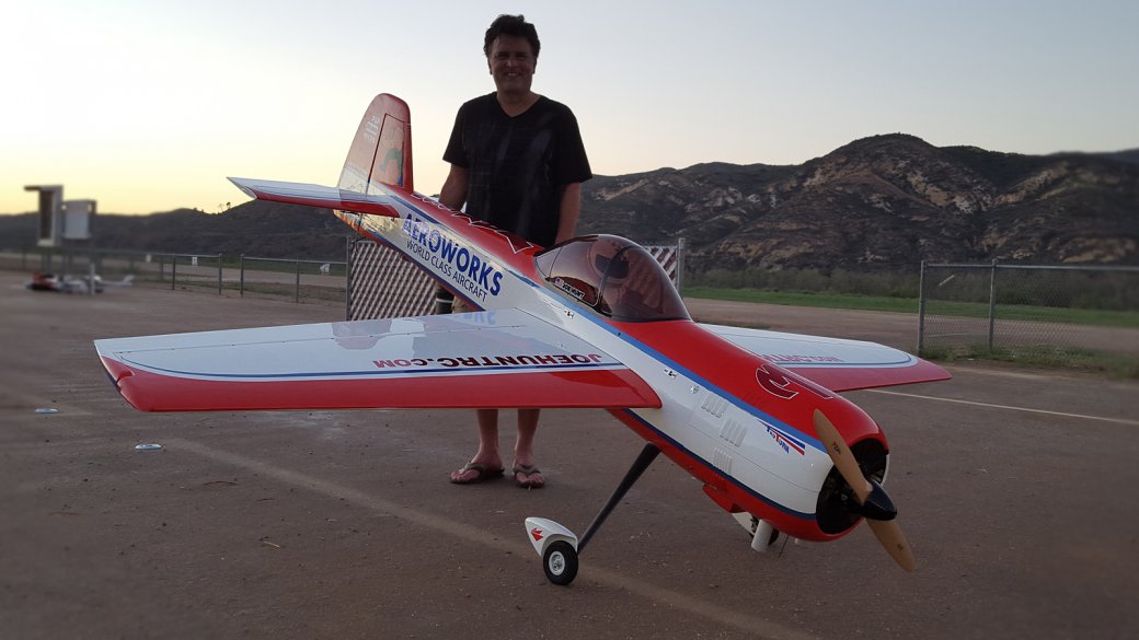

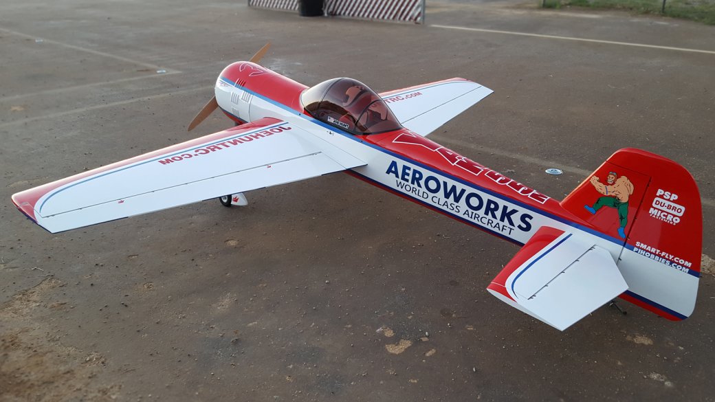

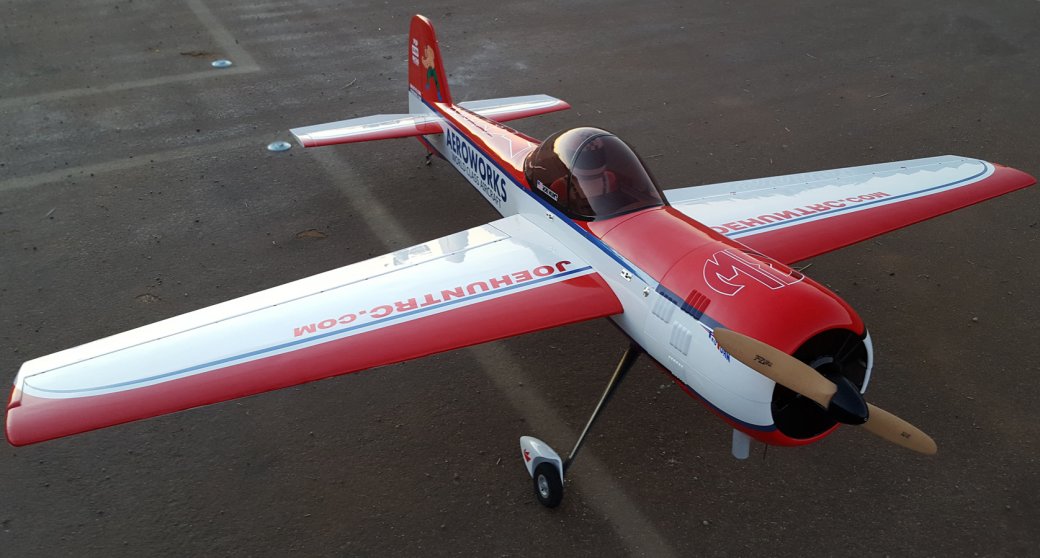

Some observations:
1) the plane, she is nose heavy, just about right for precision, but maybe even a little nose heavy for that. If you're thinking about a DA-200 you definitely gotta go push/pull rudder and move everything back as far as possible. I might even have to do that. haha I taped a 5cell NiCad pack on the tailwheel and it barely helped. The plane is still way too nose heavy for me, right now. This video is of the 5th flight. I was alone and didn't figure to get any video until tomorrow (when Smok'n Joe shows up with the good cameras), but a club member showed up and took a video of this flight with my pocket camera. He hasn't done much of this before but was starting to catch on towards the end of the flight.
2) the servos, they are nice and draw little current, but they are their rated selves. What I'm getting at is that to me I still need two on each stab and three on each aileron... for freestyle. For precision I think a guy would be just fine with one servo per elevator half and two on the wings. That is as long as he used short servo arms and setup good mechanical advantage. Just my observations and opinions, for what little they are worth. haha
3) Even nose heavy the plane hovers and torque rolls as easy as any plane. Not all planes are easy to torque roll, and most are pretty darty when they are nose heavy. This plane is one of the really easy to torque roll planes, even when really nose heavy.
Hope to get some nice video and pictures tomorrow.
