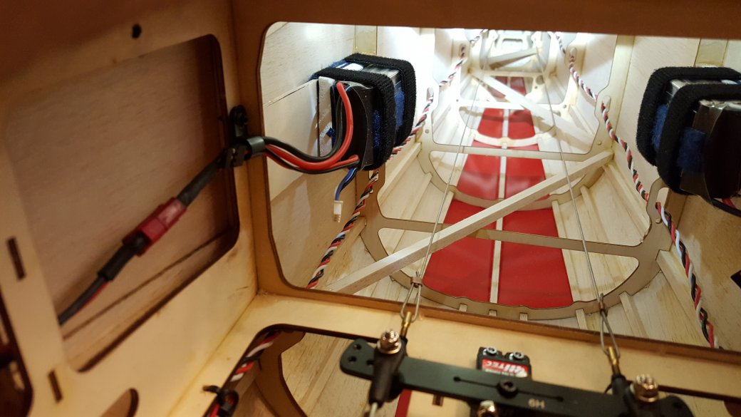

I just moved the batteries back to help with the nose heavy condition:
