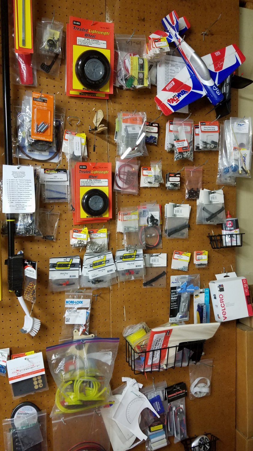

It looks even cooler than the 12, but the 12 looked more versatile for using with other receivers, for instance. And, the 12 has the two channels that have two servo ports on them, which I'm using for my ailerons. But, the biggest reason is that I already had a 12 in stock... the 12 was on "the wall".
