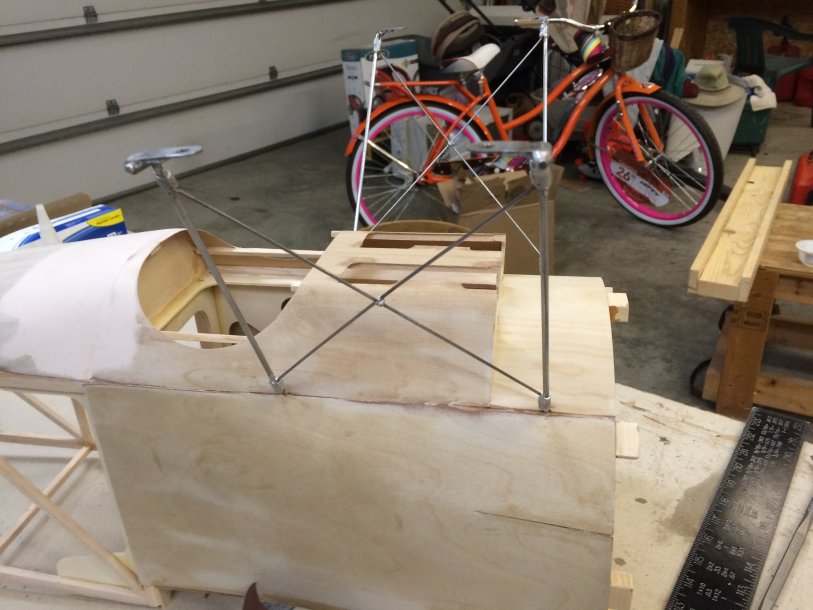

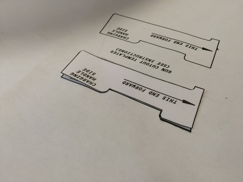

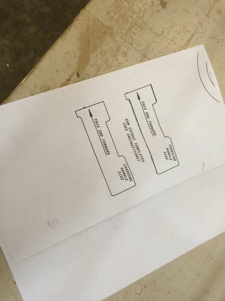

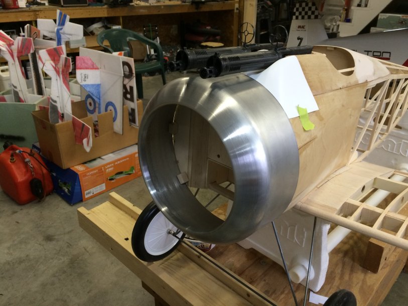

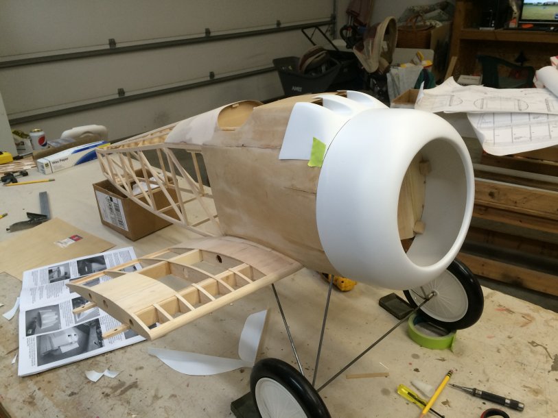

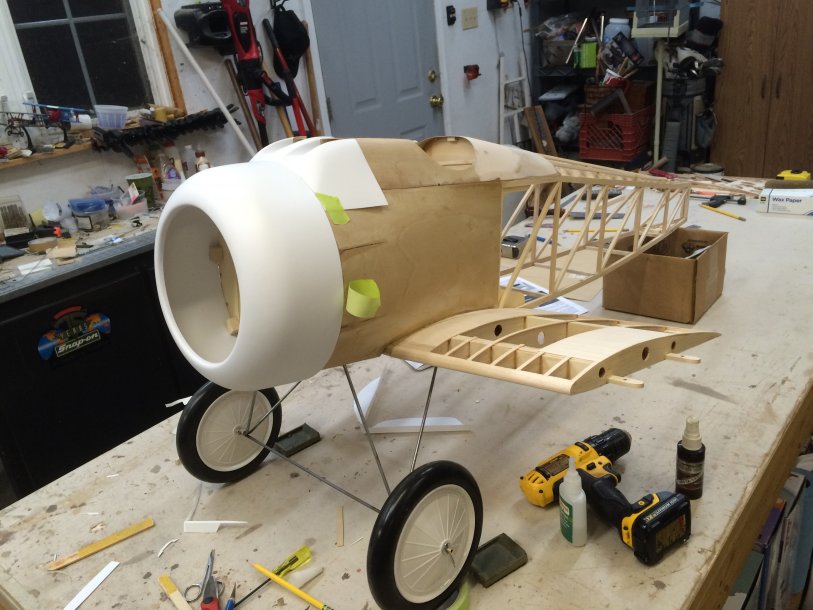

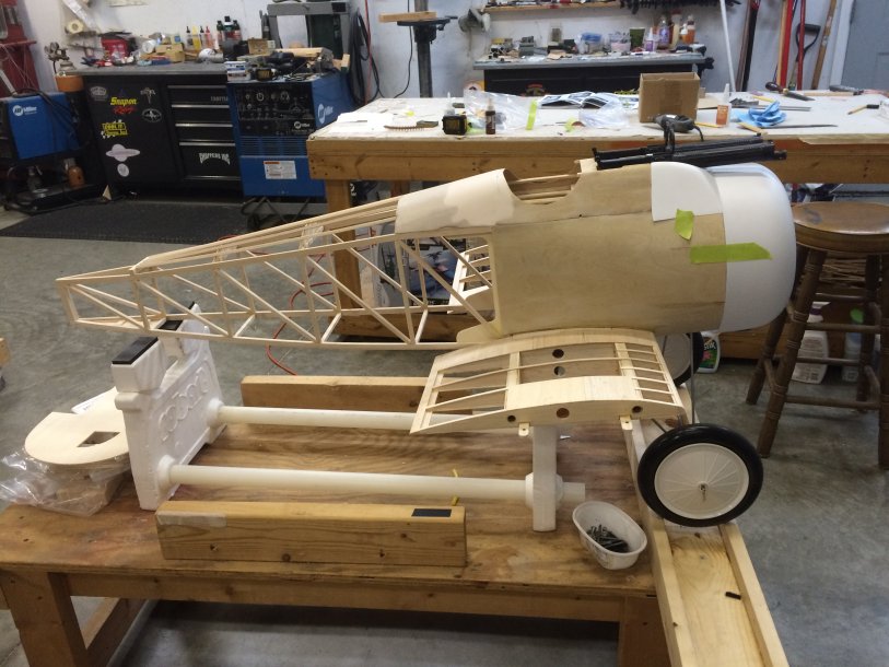

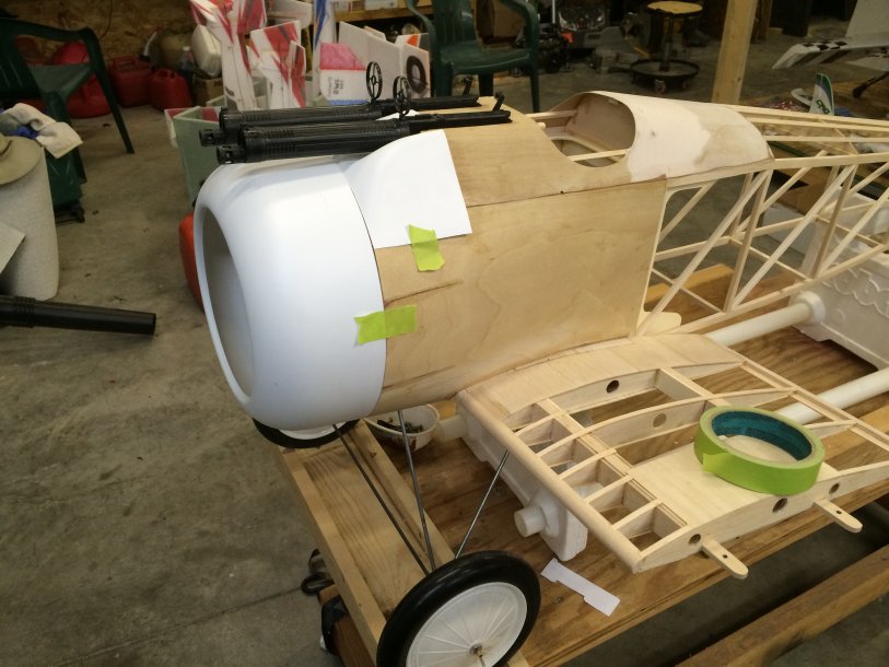

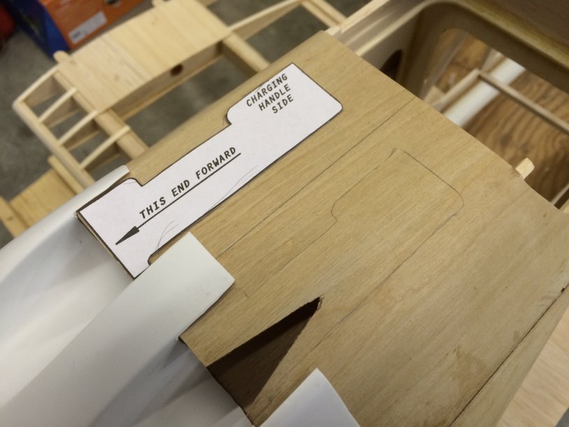

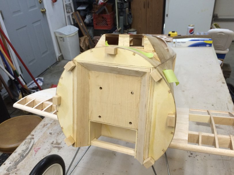

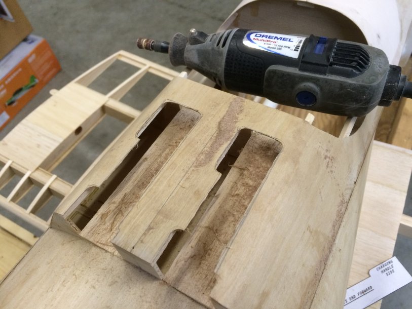

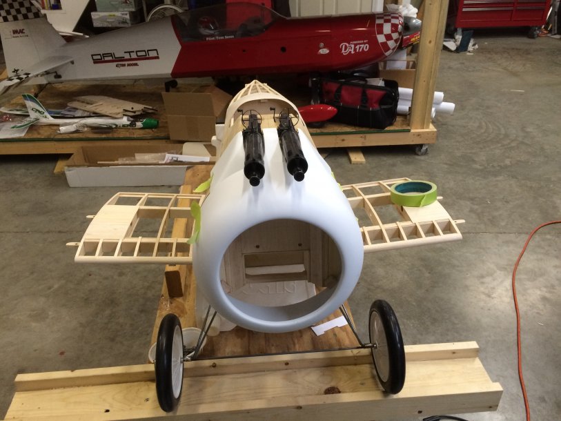

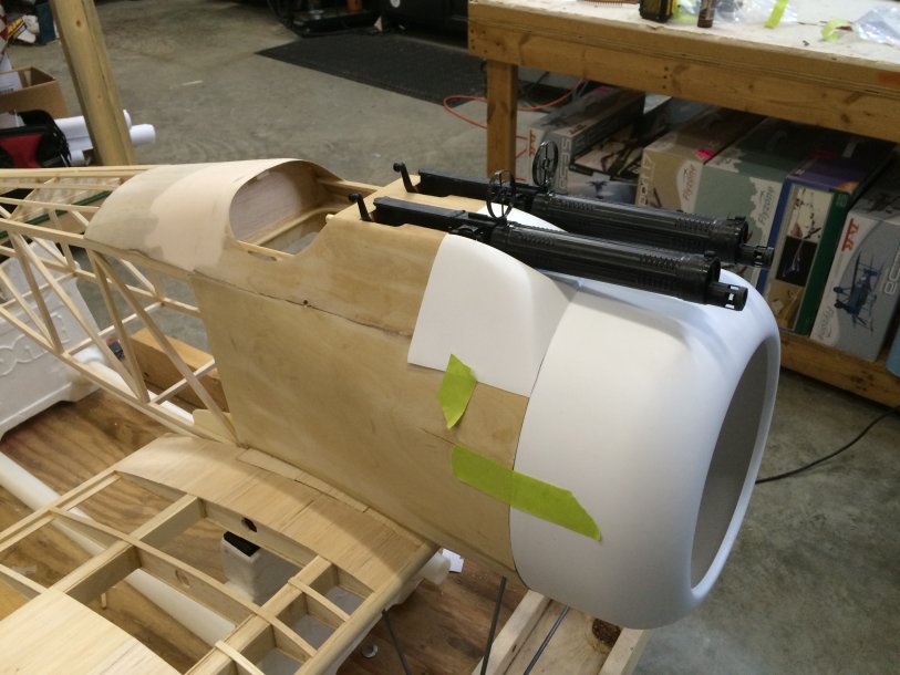

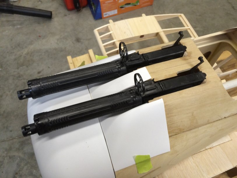

Sometime we get motivation from the strangest places. In this case it's a Thunderstorm Dec. 23 in Indiana. 62F today. No white Christmas around here. I got trapped in the shop by a downpour and decided to find something i could do on the Camel. Glued on the Cowl mounts. Cut out the plastic hump and the opening for the Guns. Rough fit the Gun Opening. If your using the Sulivan plastic Guns. Be prepared to modify it to fit in the opening. A little belt sanding on the bottom was all it took.

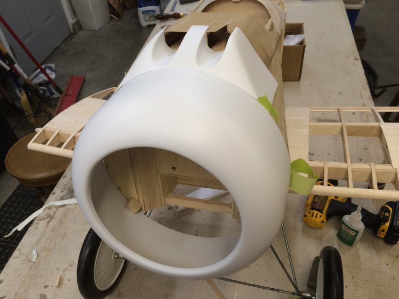

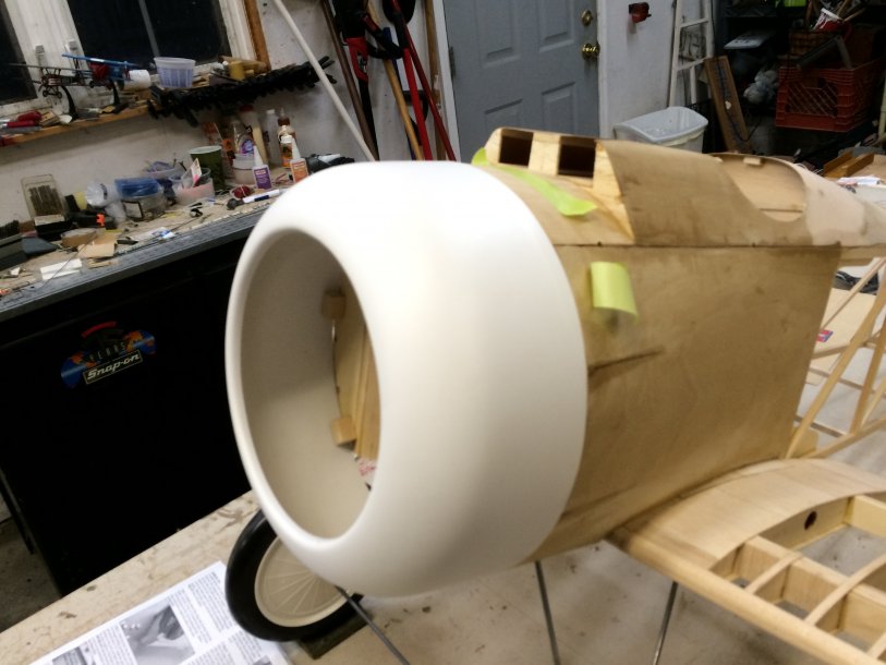

I got the Aluminum Cowl yesterday and I had to see what it looks like. I like it but it's a little bigger then the plastic cowl.
