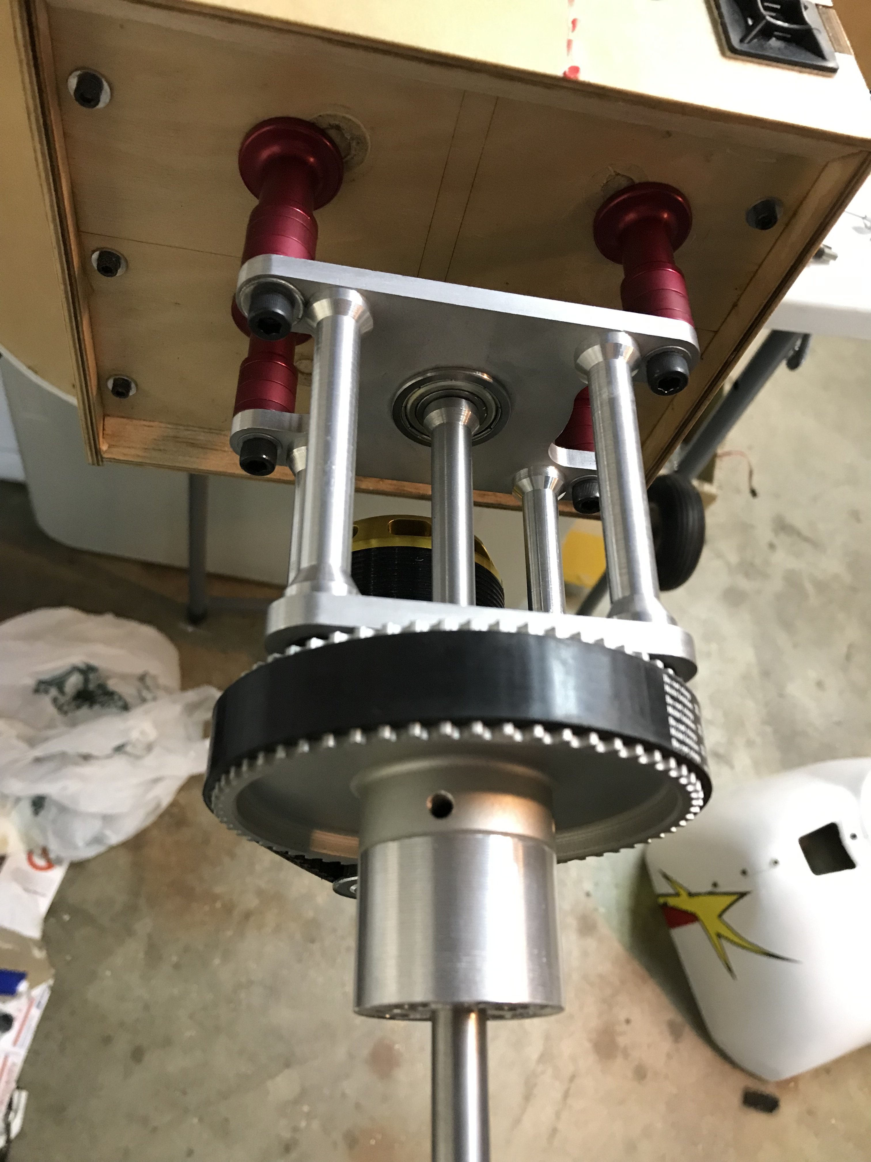

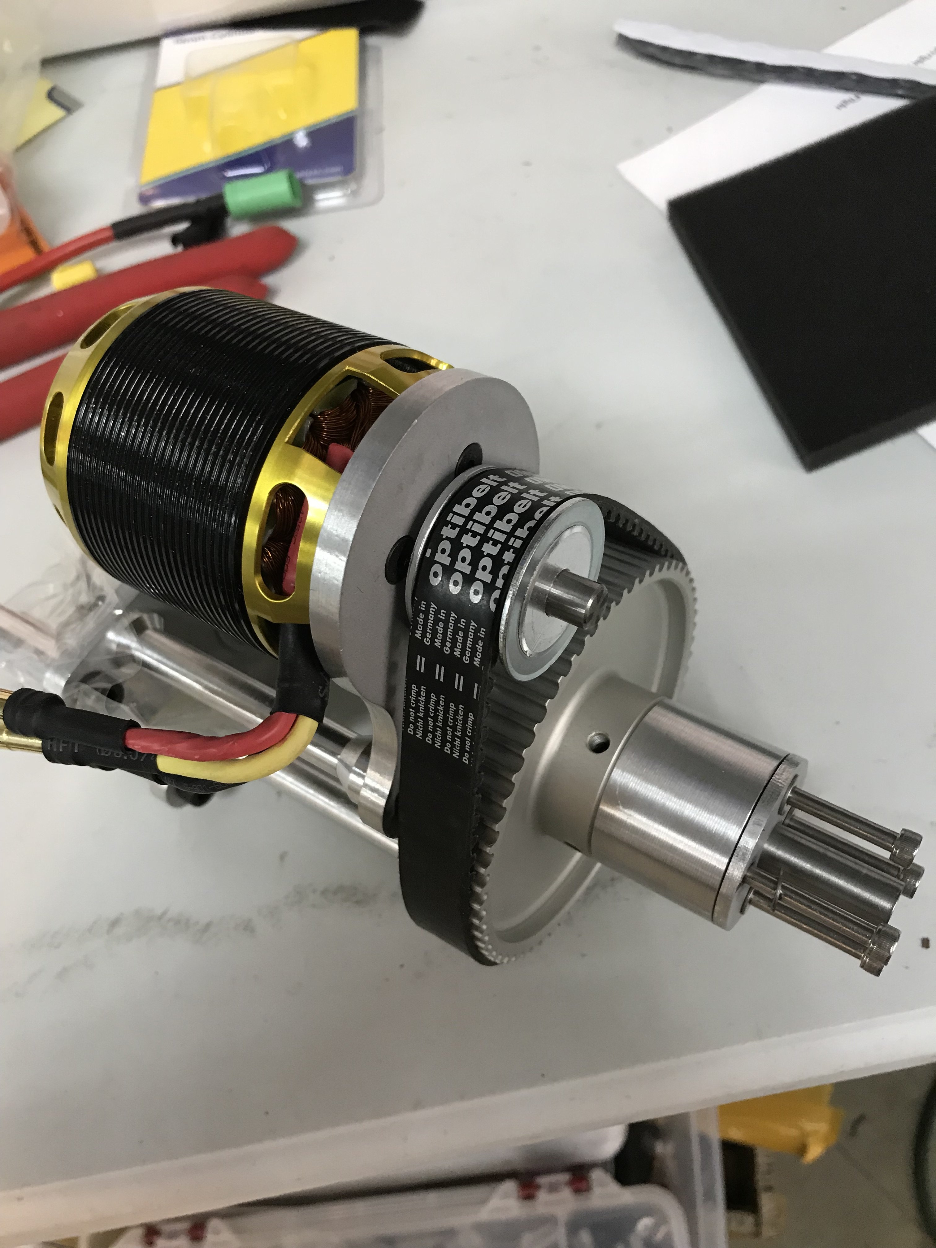

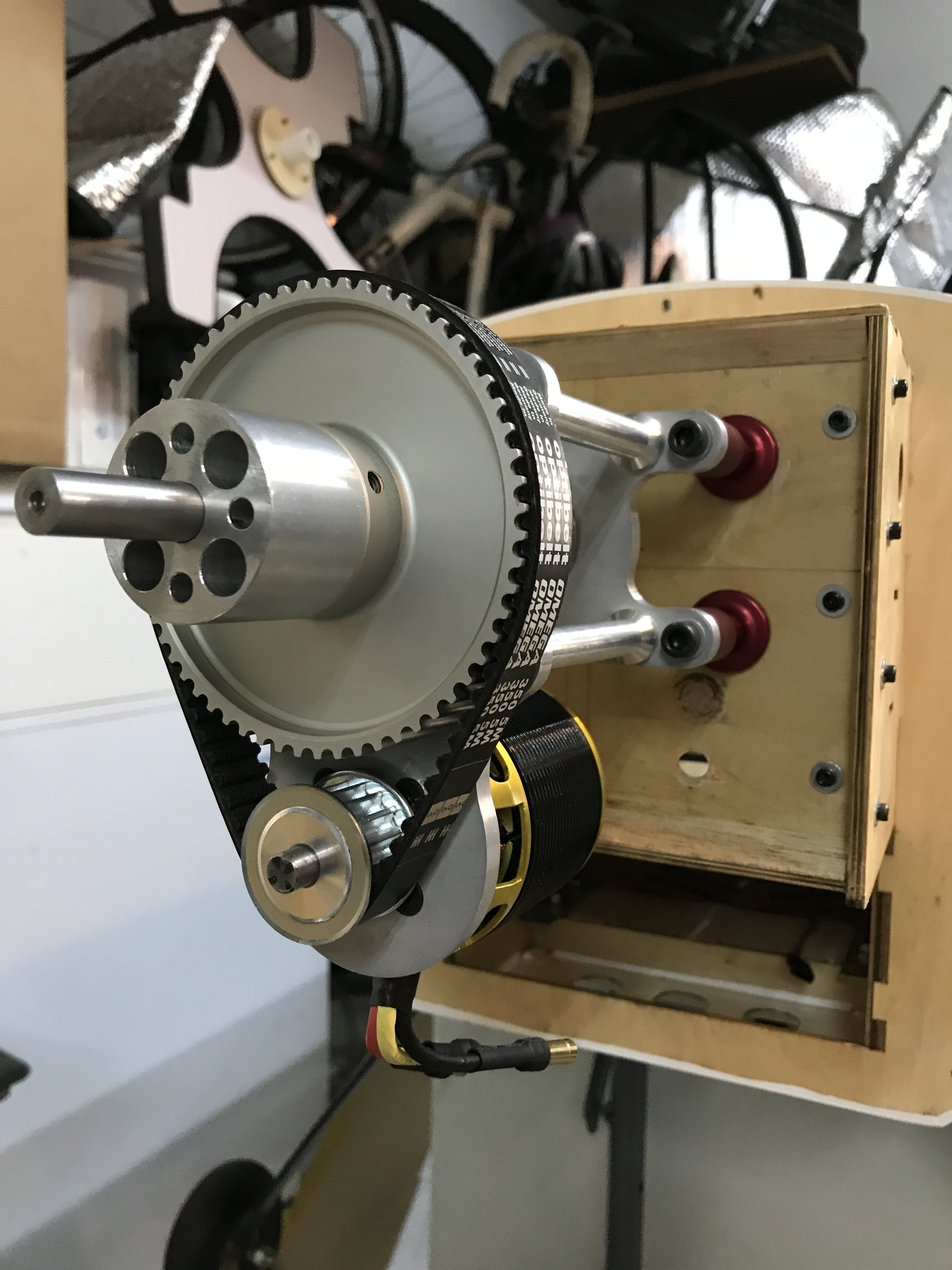

Up to a 120cc size electric now.
Utilizing a custom belt driven gear reduction unit and a Scorpion 800-size heli motor.
I managed to get video of 3 different pilots flying the electrified 105" AJ Laser. None of them IMAC style flying although Alex Barron did perform a number of high speed snaps. Amazing flying by these three considering it was their one flight on the plane - not always easy considering everyone has different radio and plane setup preferences. I was happy that the electric setup felt pretty natural to these pilots that normally fly 120cc gas.
