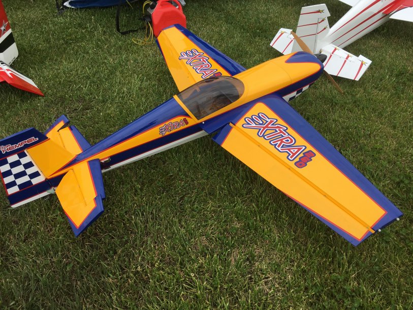

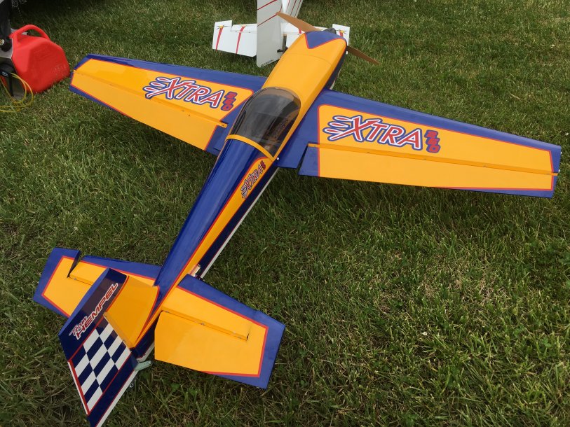

Added two washers to the left side stand-offs for a little right thrust and and some vinyl graphics to dress up this bird. Really flying nice now. Had it up in 14-20mph crosswinds and it performed great and the graphics popped in the air.
