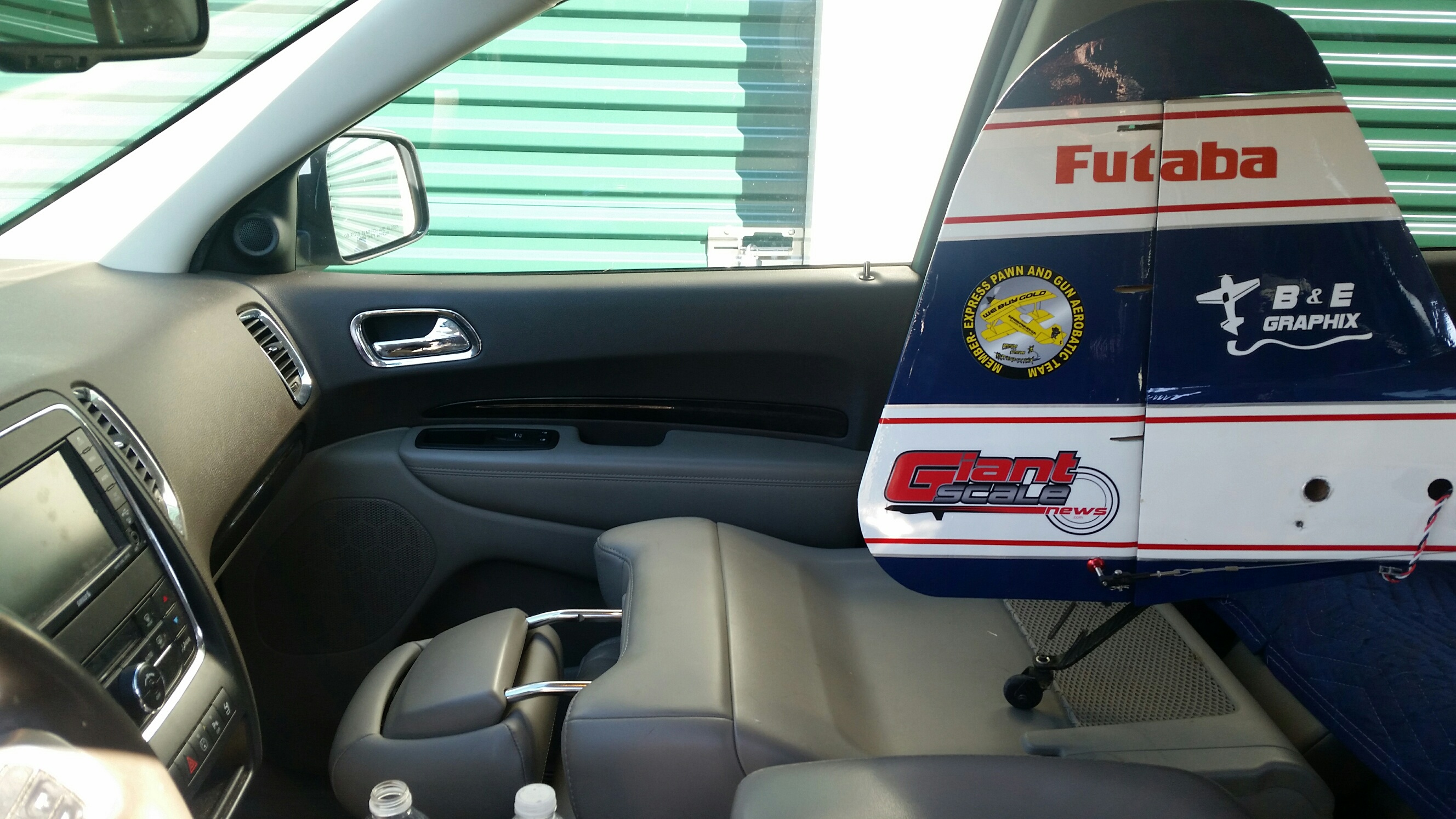

Hey @Snoopy1 , I apologize for the late response, but I did get a picture of the Yak in my Durango from the front seat.
The cowl and prop were not on the plane, but as you can see, there is still plenty of room. One thing I may have failed to mention previously is that my Durango is the "Crew" version that has seating for 7 people which helps explain why I have the extra room for the plane.
