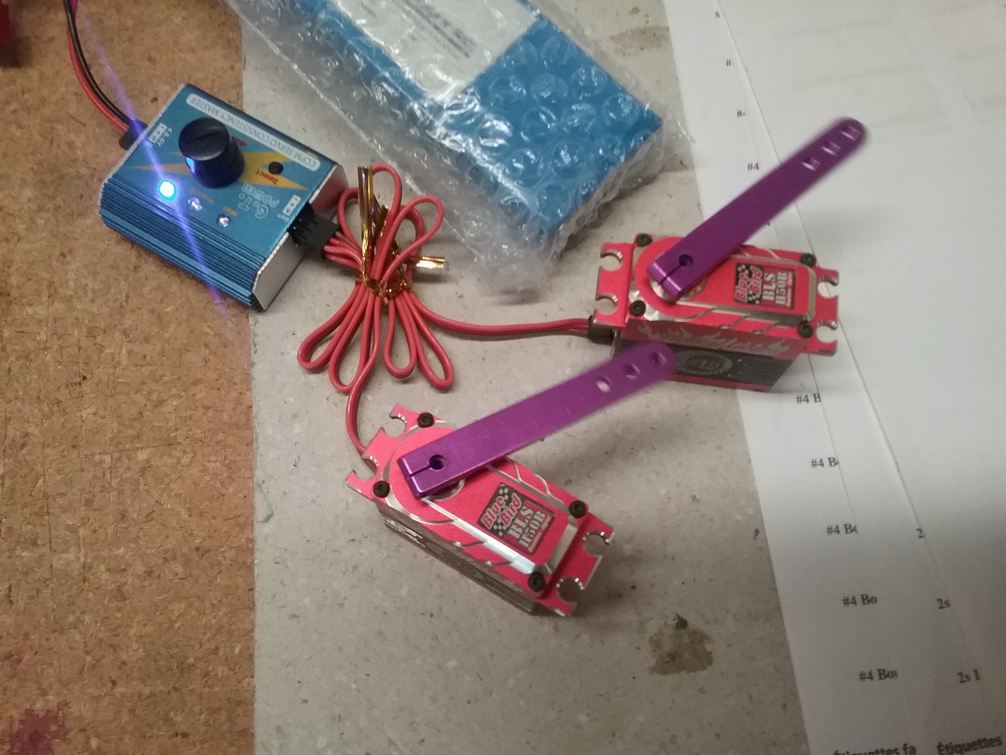

After reading this today I ran 2 new bls hb50b on a servo cycler for close to an hour. No load just arms and me applying force here and there physically. Servos got hot to the touch but no effect in performance.

Plus, excercising servos on a servo cycler only proves that they work. I feel that they shouldnt be cycled more than just a few minutes. They have aluminum cases, and with a little bit of airflow over the case, temps will be normal.
Anything that has to do with power/electricity will generate heat, naturally. So, yes, I would expect to see a nearly melted servo connector if the servo was cycled for say, 45 mins at full travel. Our servo plugs are rated for 3A cont, and a peak of around 5A.
I have yet to see a 520kV electric motor run cool just on the bench.
