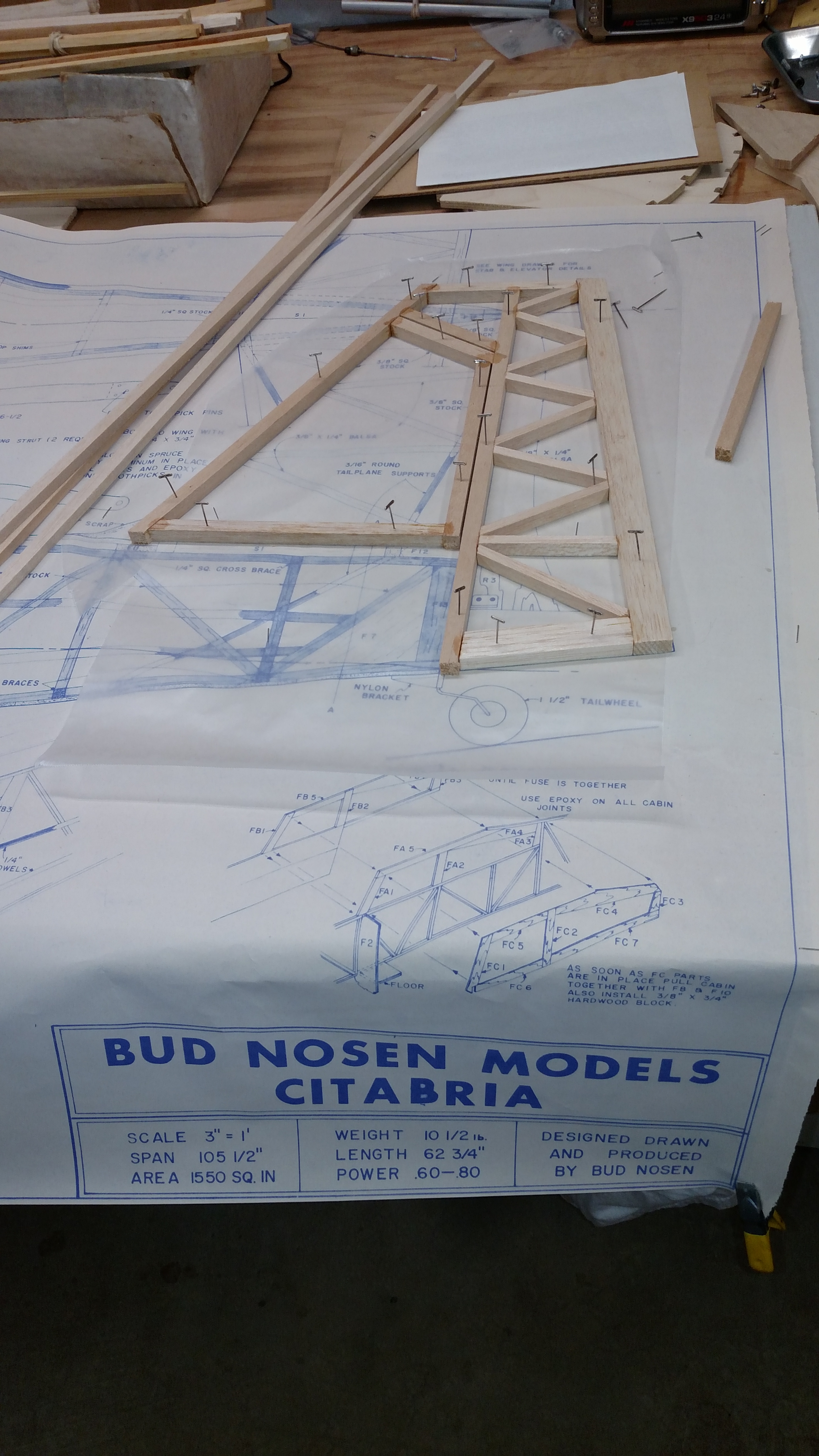

Today's work so far has been meant to re-introduce yours truly to cutting and gluing balsa while staying within the plans lines. It's gone ok so far.
Pretty standard balsa stick construction except for the exceptional joinery. :banana-dance:

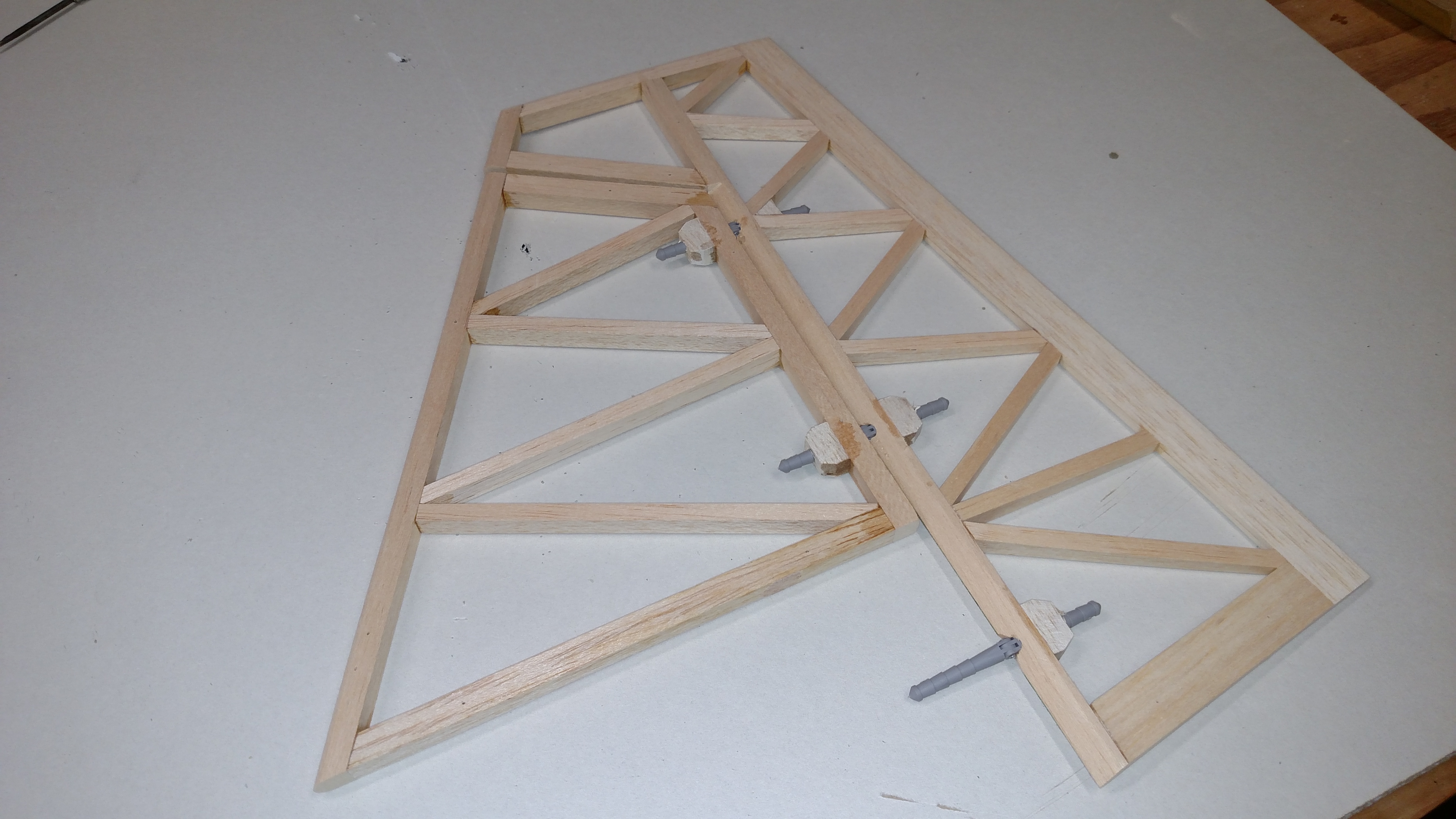

And here is the complete Rudder and Fin which together comprise the Vertical Stabilizer. The plans don't specify a particular hinge so I'm using Robart pin hinges mostly because I had a bunch in my tool box. I added the balsa blocks for the hinges and I'll figure out where the rudder control horn needs to be located and add some blocking for that at a later date. The rudder has been tapered, I'm not sure if the real plane's rudder is tapered, maybe when the weather gets better I'll go take a look.

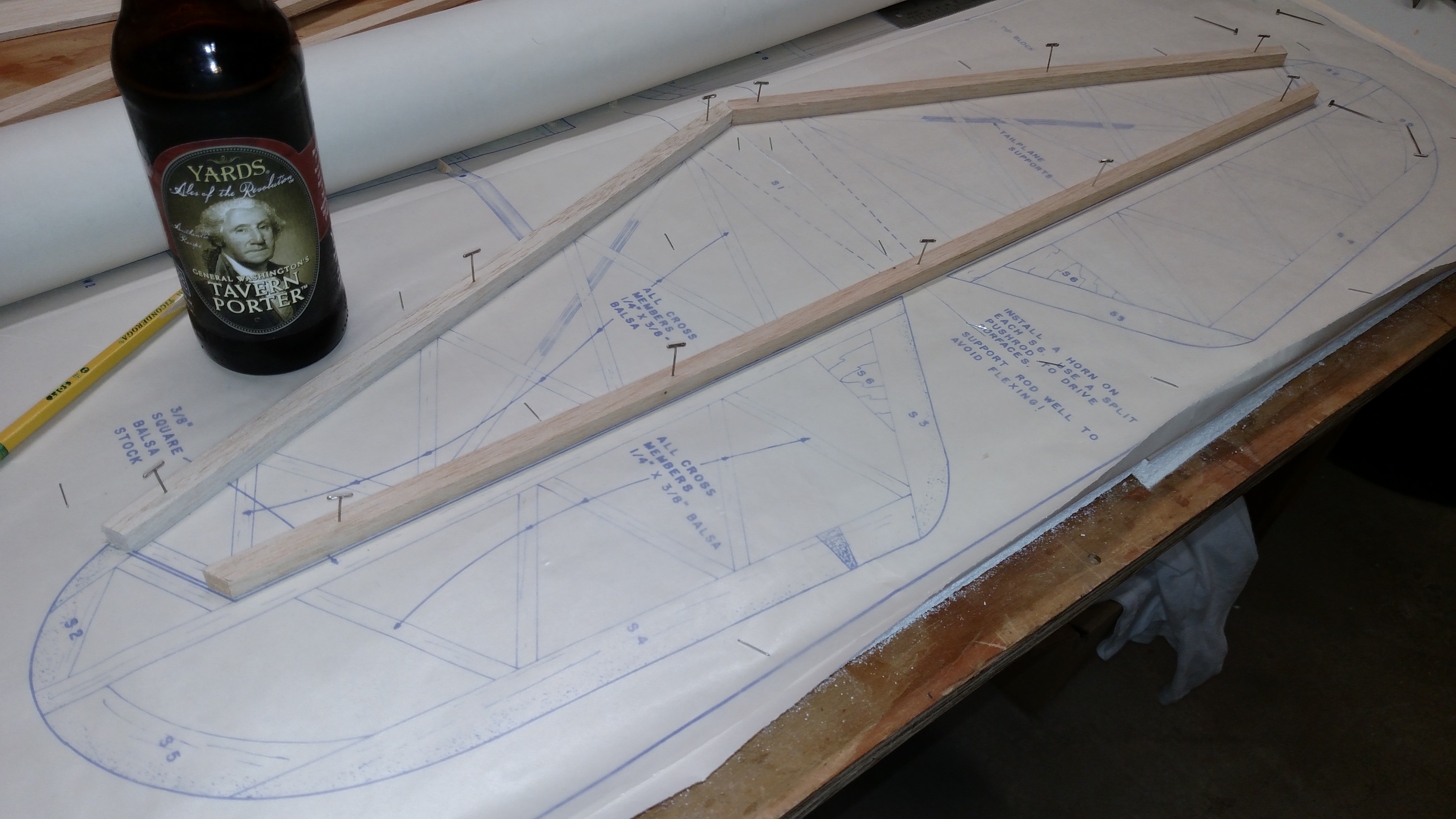

Horizontal stabilizer is on the bench and the suds are out of the fridge! It's a nice Yards Tavern Porter tonight which is as awesome as awesome can be. The only thing that could make this night better would be Olivia Newton John singing to me while I build! :lol2:
I'm going to take some of the roundness out of the tips and open up the gap between the elevators for more rudder swing.
