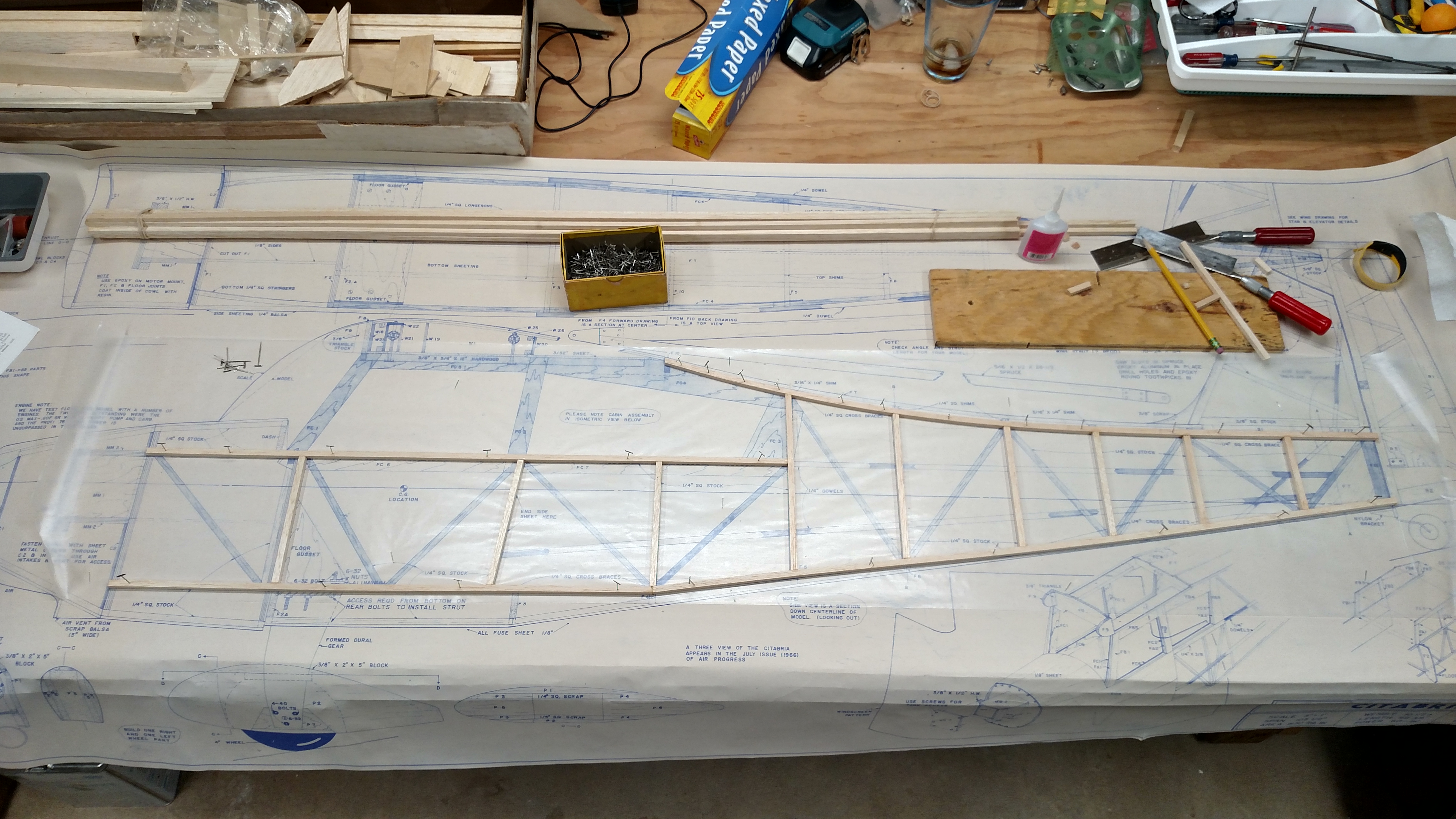

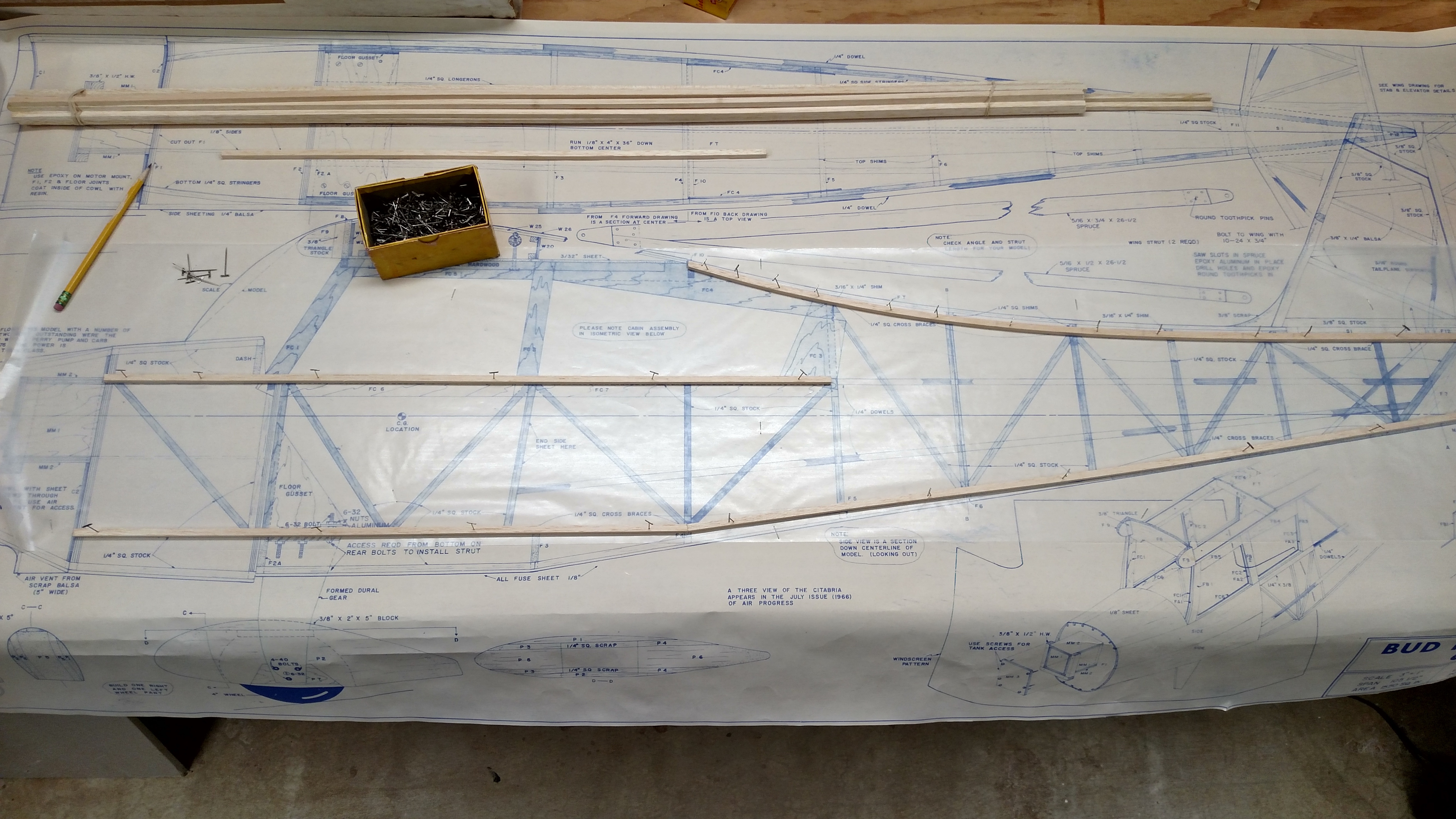

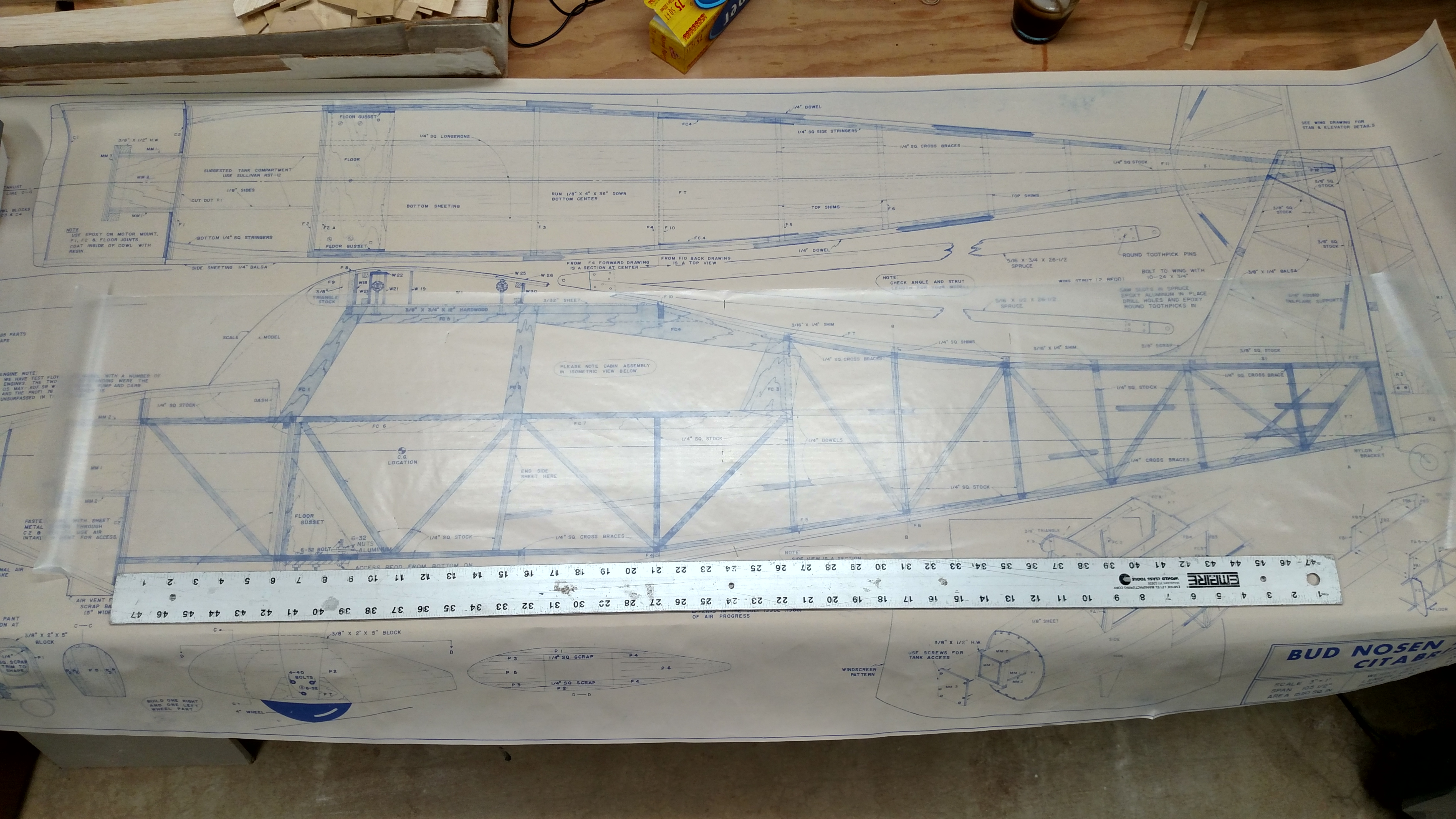

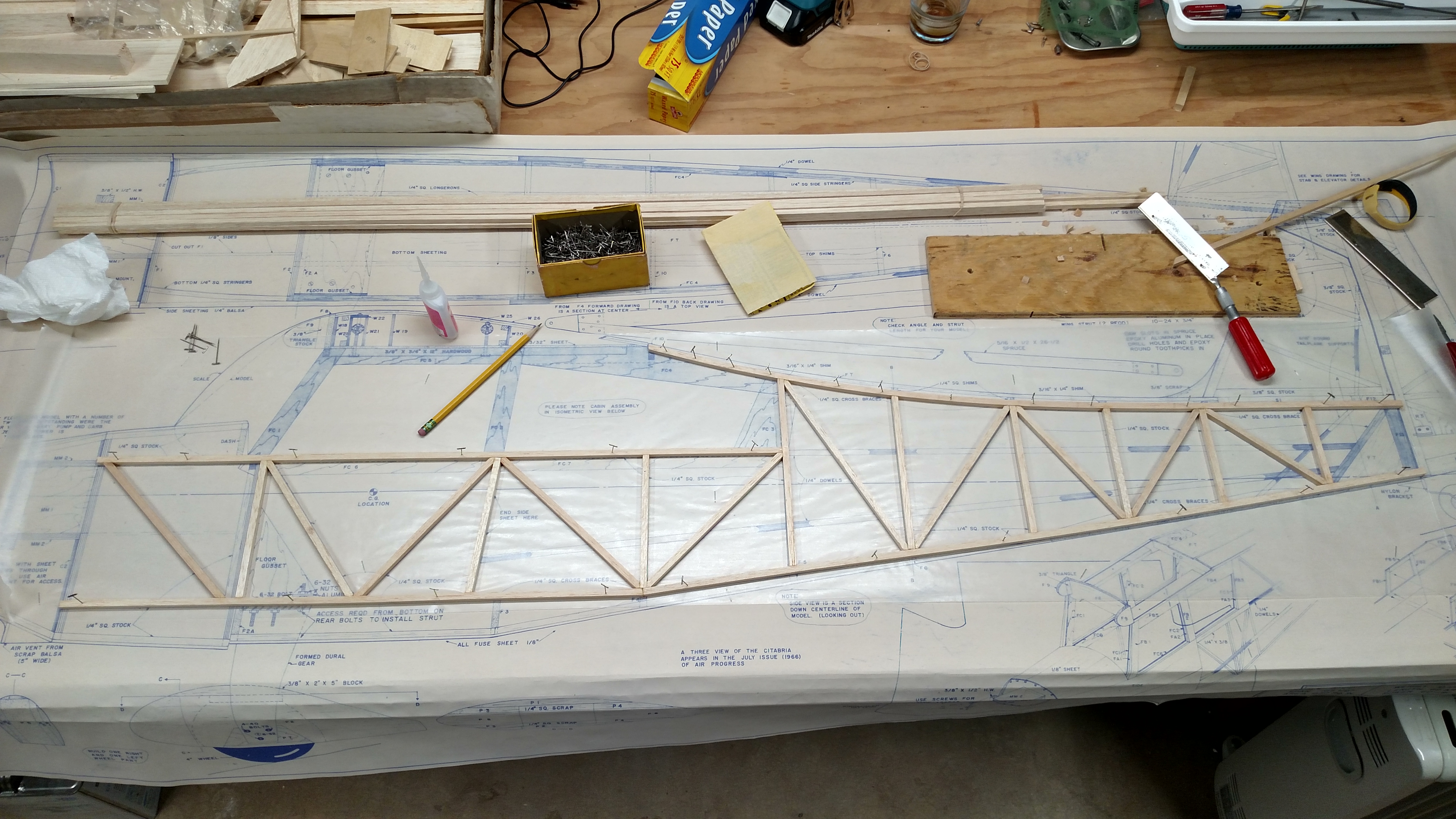

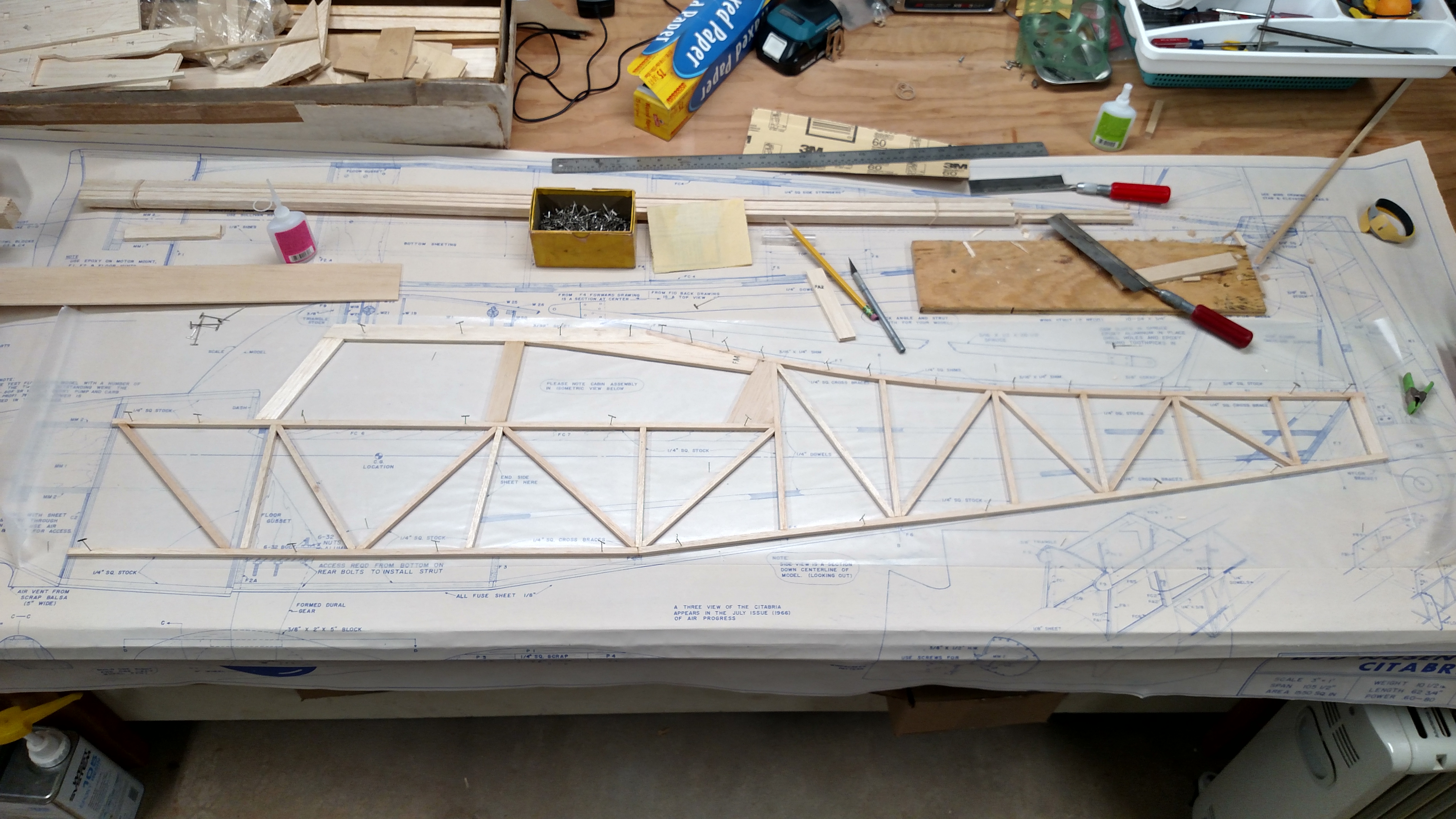

While I wait on the balsa for the elevator halves I've gone ahead and started the fuselage. First you build two of the sides, then you start at the front and use either die-cut plywood or balsa formers to join the halves pulling them together into place as you work towards the tail.
First side is done.
