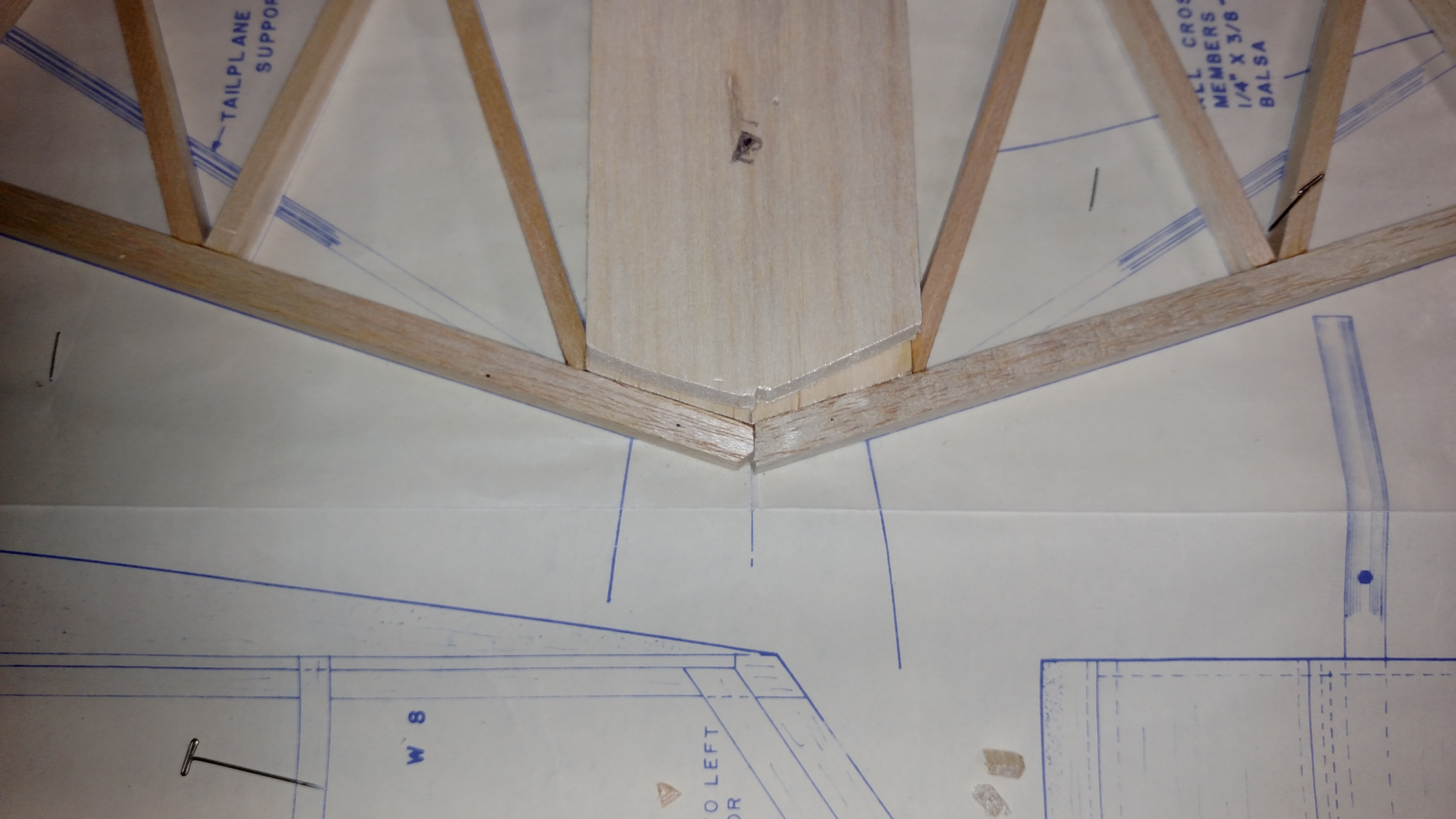

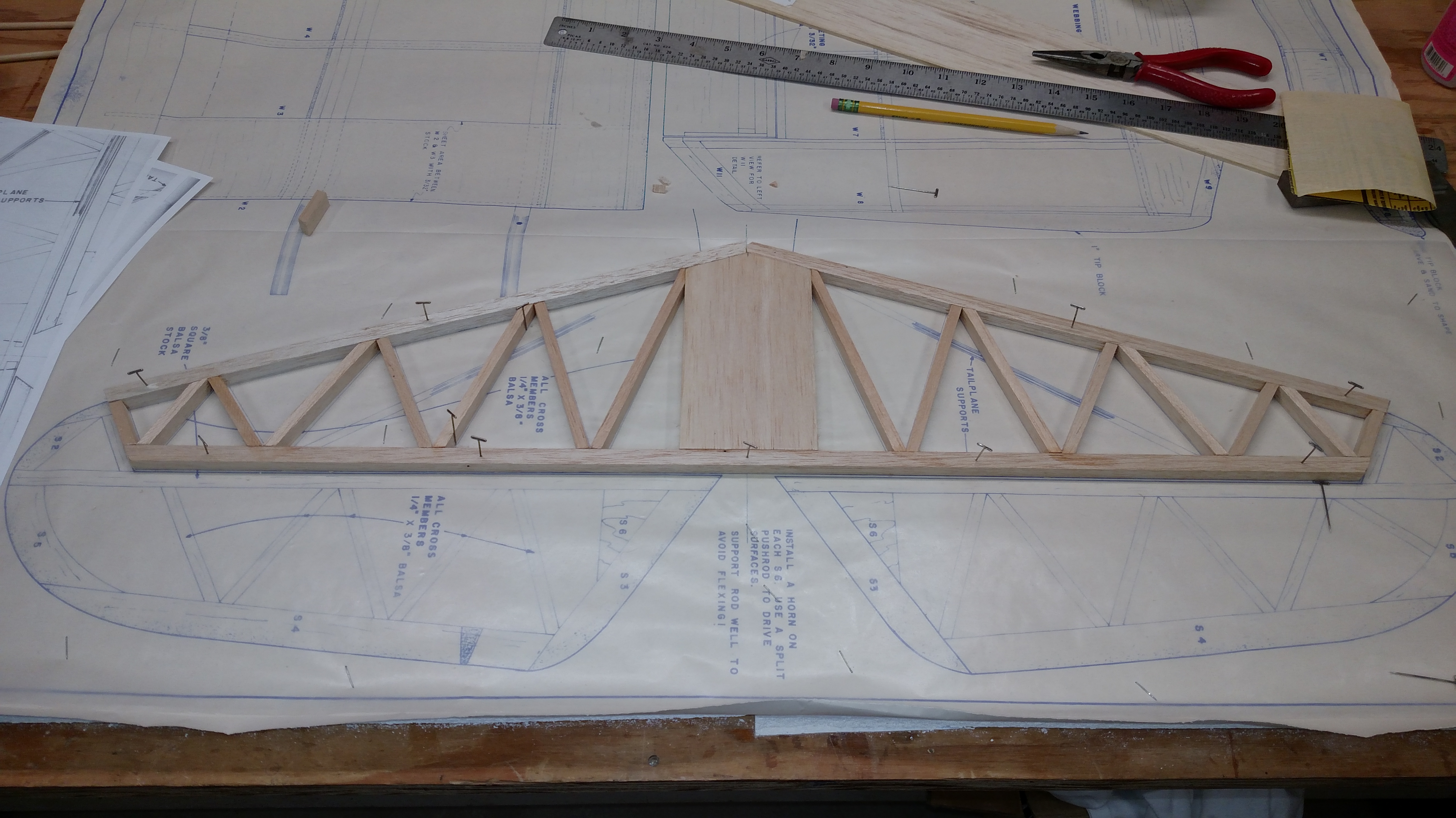

This is how far I got yesterday before calling it quits.
In this photo you can see an example of a piece that was supplied with the kit over the replacement piece I had to make. It's possible a previous owner messed up some of the parts, I don't know. There is a part number stamped on it so it's an original piece. :ugh!::ugh!::ugh!:
