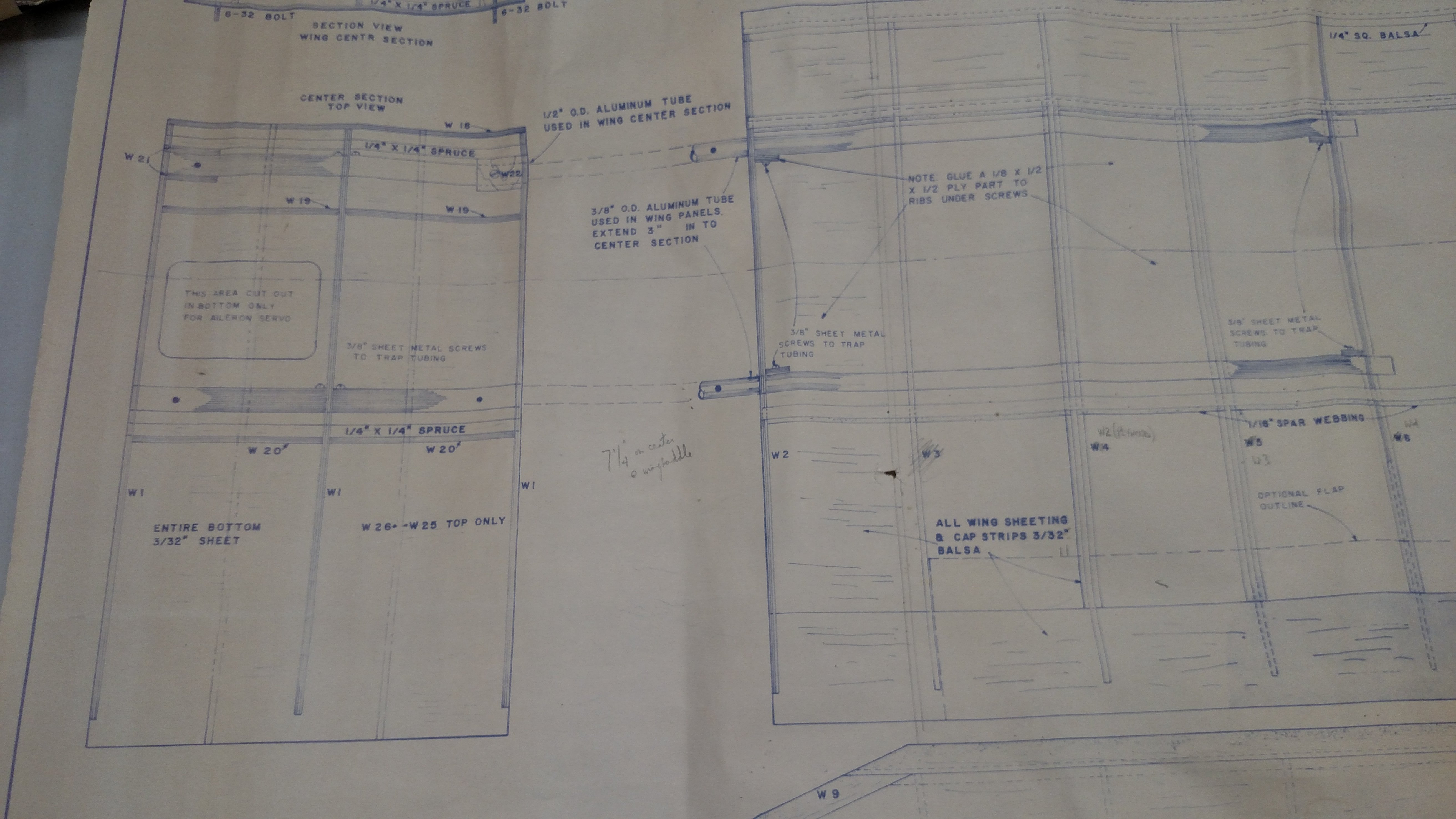

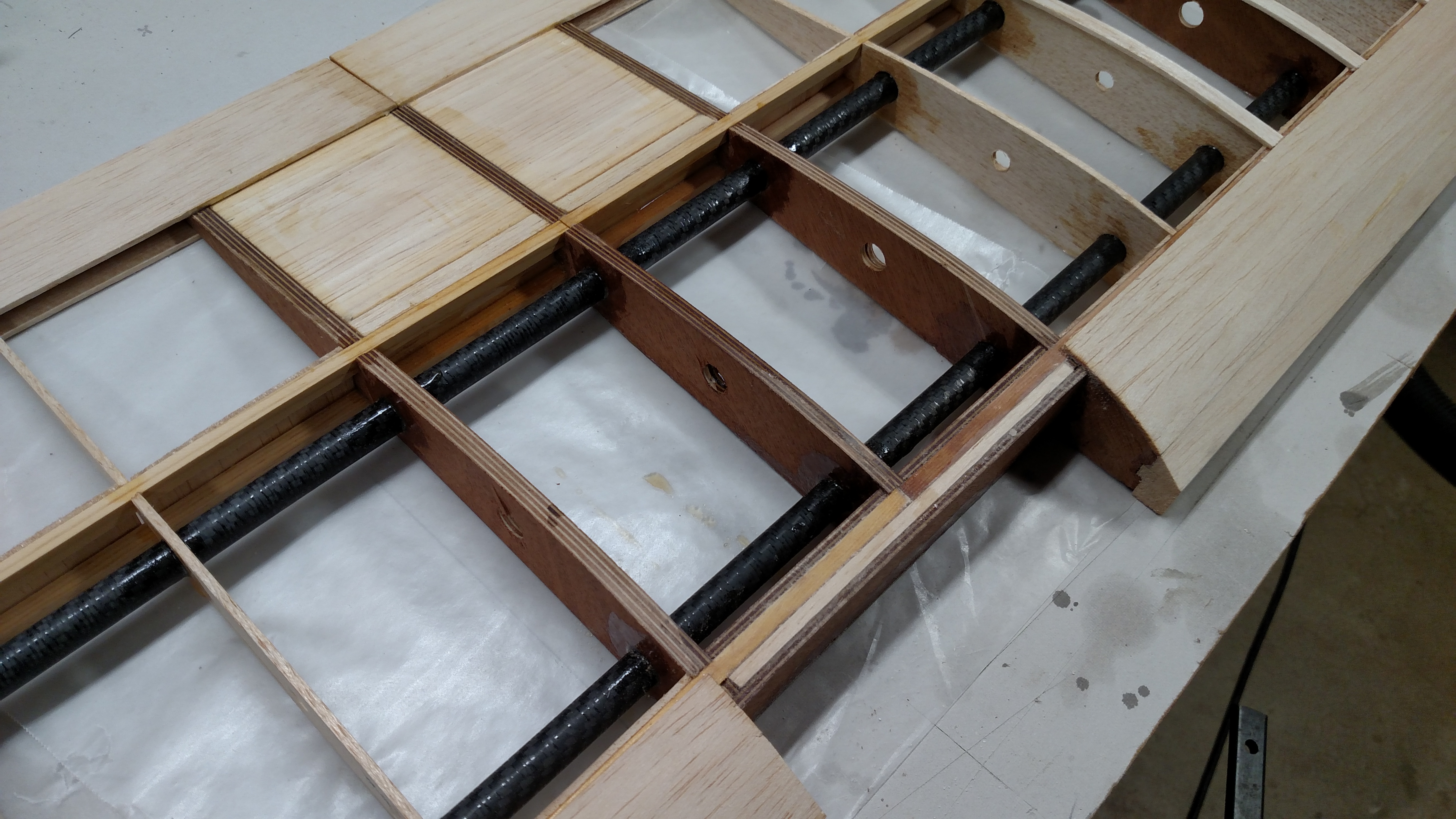

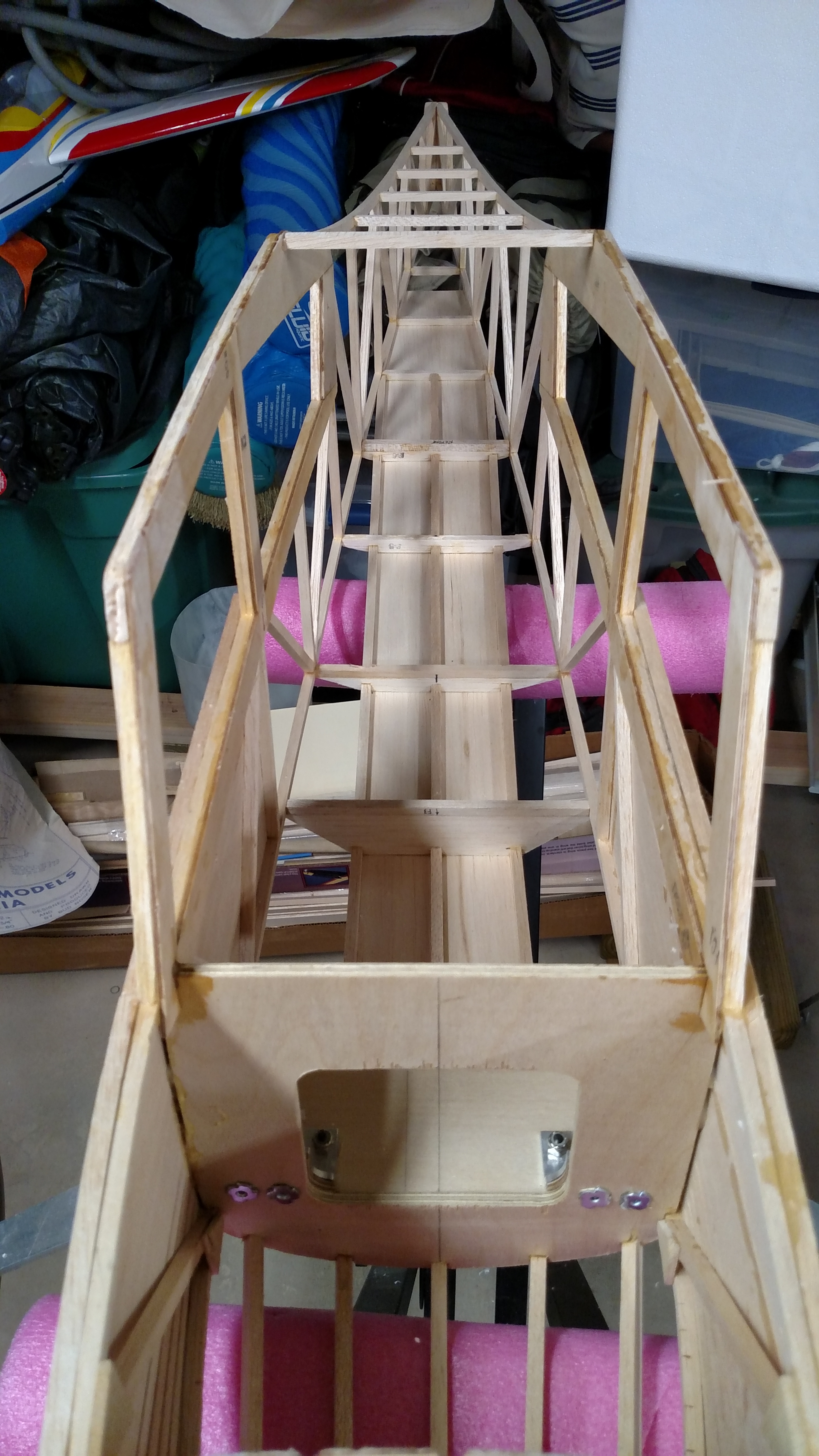

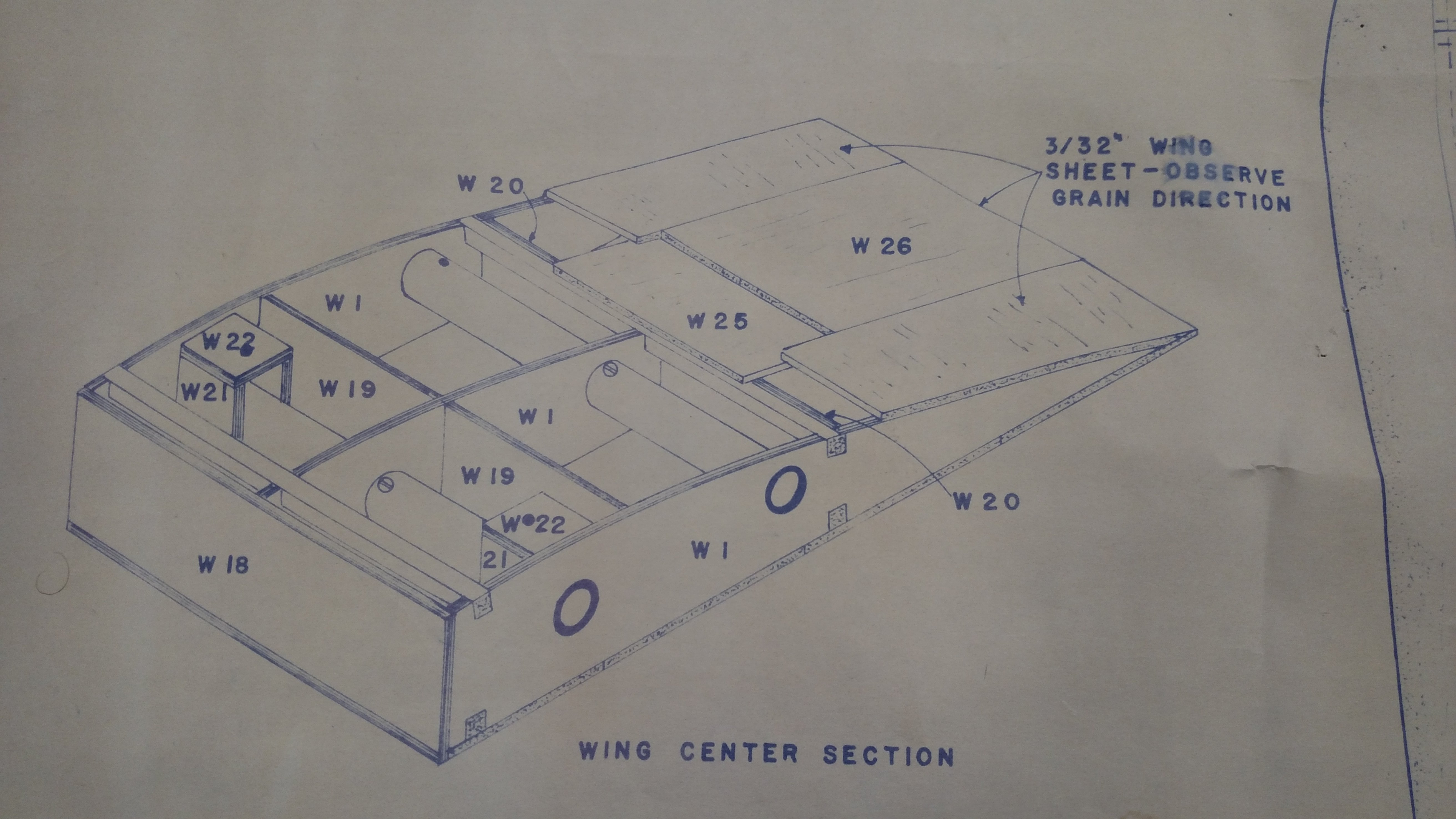

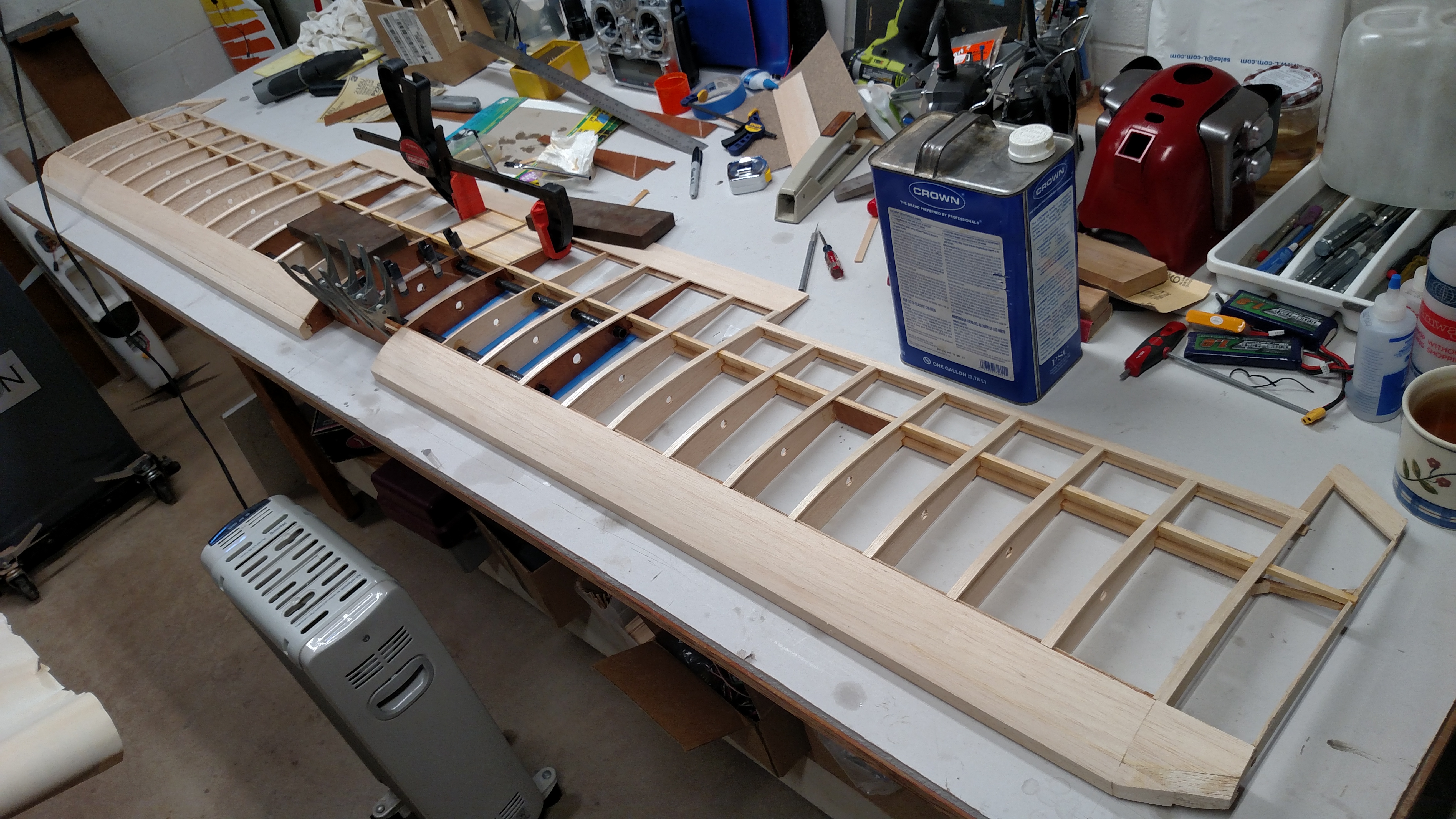

Started up on this again, trying to get wing details done so that the halves can be joined and everything done/ready for cover.
Then on to finishing the fuselage and tail feathers. Maybe it'll get done, maybe it'll go back onto the back burner after a bit. Maybe it'll go to another builder to be finished. Not feeling the love for this one.
