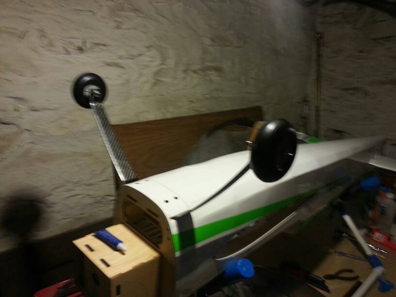

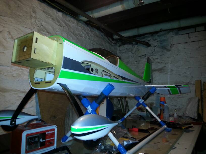

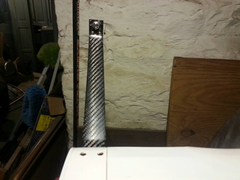

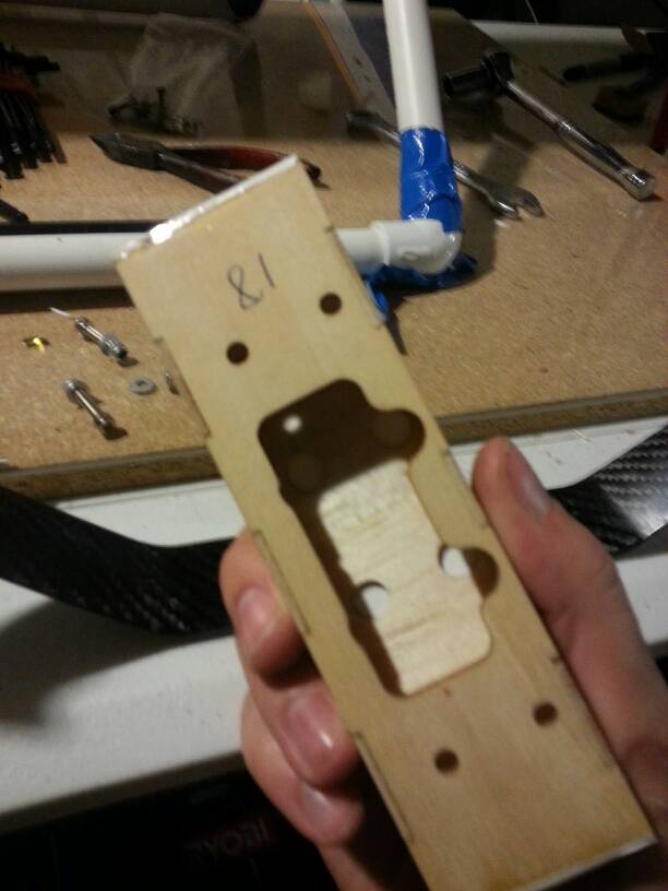

After the tail, I mounted the landing gear. There's this awesome plate that goes over the heat to blend it in with the fuselage. uploadfromtaptalk1380934316703.jpg

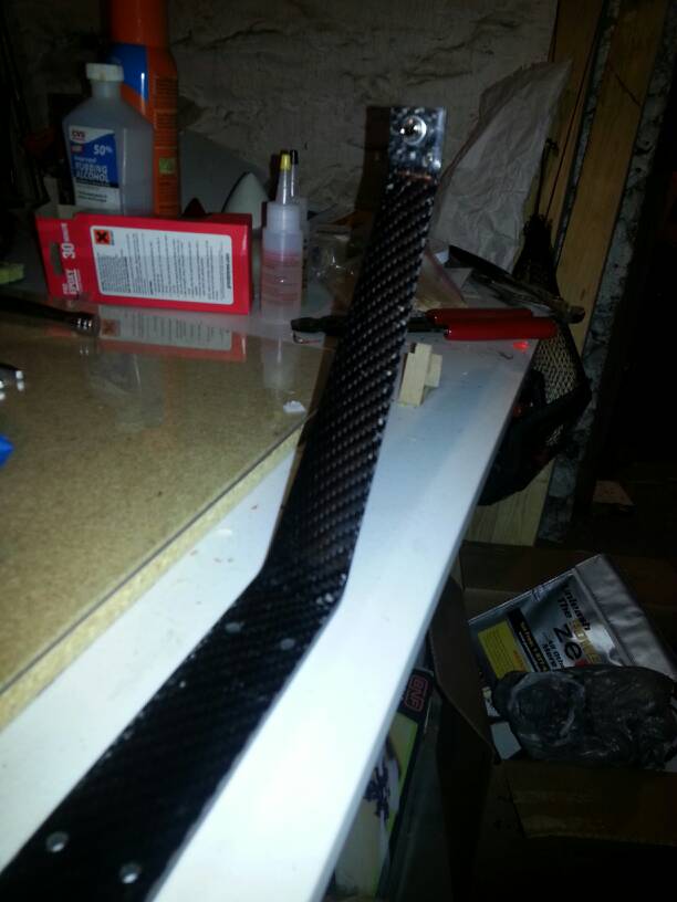

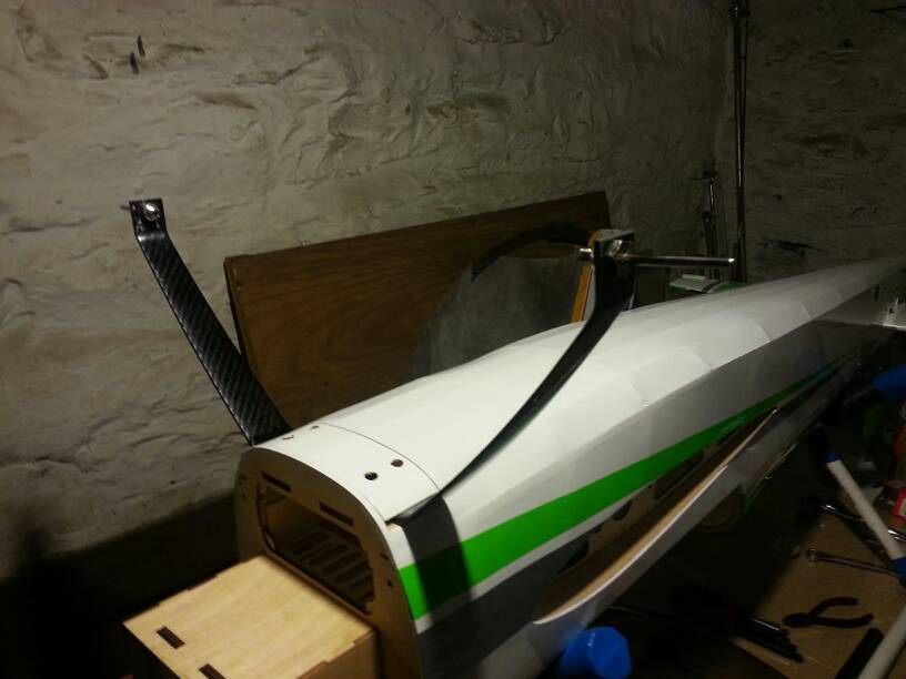

Also, the landing gear has a sweep in it. It's very important that the sweep goes forward. It's hard to eyeball it so I set it upright on the table and looked for the direction it was leaning. uploadfromtaptalk1380934331970.jpg

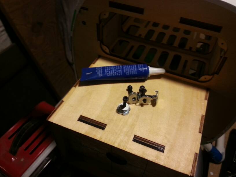

Everything mounted. What's not pictured are the aluminum angle braces and the large bolts with nylon insert lucknuts holding the gear on. I put the bolts through the cover and then the gear and finally tightened everything down. uploadfromtaptalk1380934375344.jpg
I need an opinion. Did I get the sweep right? uploadfromtaptalk1380934405194.jpg

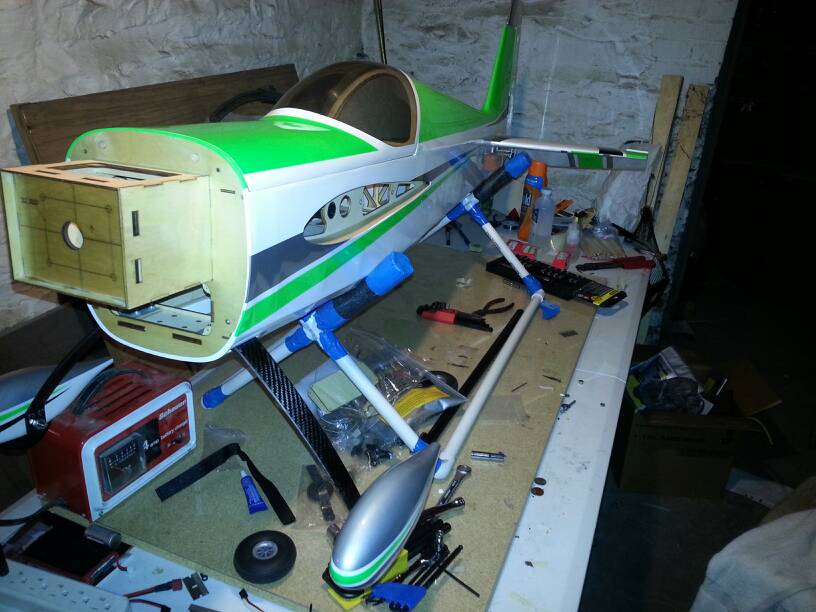

Next up were the wheels and wheelpants. The wheels are pretty self explanatory. The only change I'm making is that I'm going to use dubro low bounce rubber wheels. The wheels in the kit are quite nice actually. They're rubberized and stiff enough that they won't flatten over long periods off resting on the mains. The reason I'm changing them out ids because I fly off an asphalt runway so the ground is harder than a grass field and models tend to bounce off asphalt if you land too hard. I've been using the low bounce rubber wheels for a while now and they really do absorb quite a bit of shock which I'd good for the longevity of the plane. They also don't flatten over long periods of rest. uploadfromtaptalk1380934438380.jpg

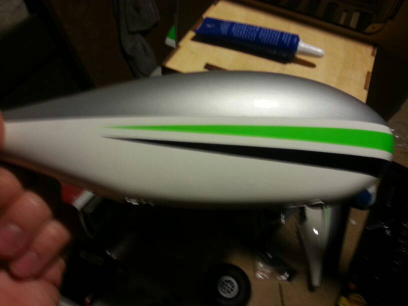

Next up were the pants. This part was a little tricky because the length of the bolts and the shape off the wheel pant give you very little play in the positioning of your wheel. Either it was catching on the bolt for the wheel pant or rubbing the pant itself. I got the spacing just right on each one but since I'm changing the wheels anyways I'm switching to shorter bolts while I'm at it. That should make the wheel positioning less critical. Also, the slot in the pant where it goes around the axle is narrow and will only go around the axle nut in certain orientations. I had to loosen it and make sure it was oriented the right way before tightening it down again.uploadfromtaptalk1380934450807.jpguploadfromtaptalk1380934461915.jpguploadfromtaptalk1380934477929.jpguploadfromtaptalk1380934488621.jpguploadfromtaptalk1380934497857.jpg
