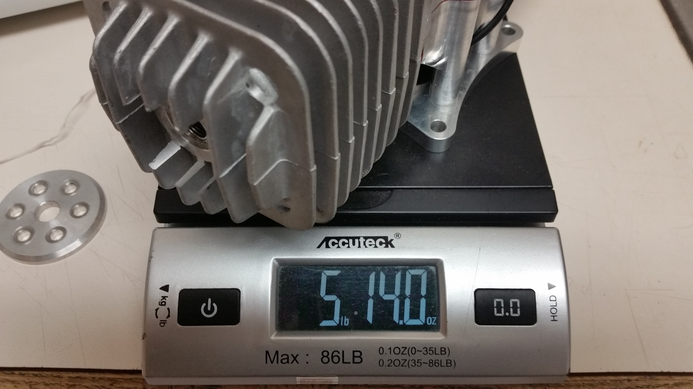

The weight of the 124 is very appealing in most cases. it comes in at just a tick over 6.0 lbs including mufflers and ignition. Lighter than the RCGF 120, Lighter than the DLE 120, Equal to the DLE 111, Just a tick heavier than the EME 120. The only other engine I looked at for information was the DA 120. All of the above are heavier than the DA. Still, I don't see half a pound being an issue on an airframe these engines will be mounted on. Rating, 4.5 stars.

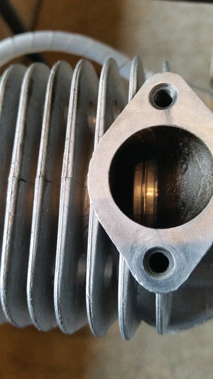

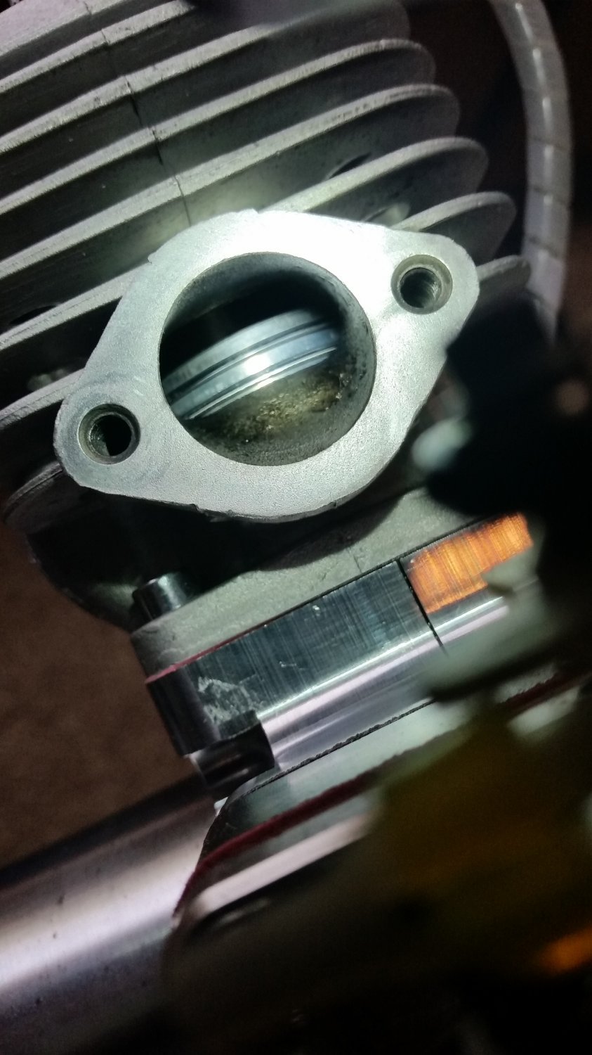

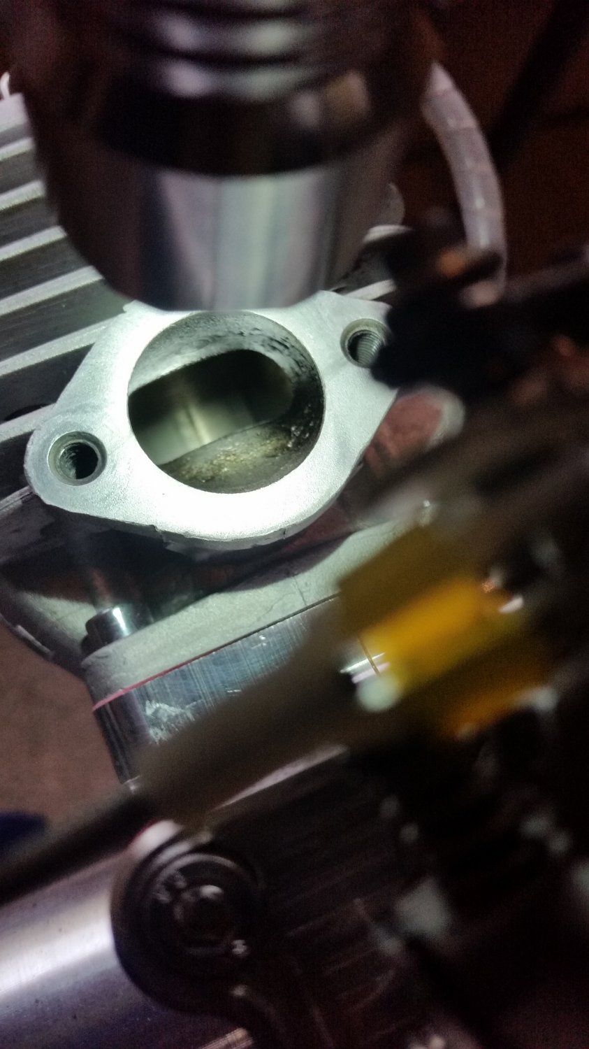

I do hope this information has been useful and appreciated. The recent photos I have attached are after 3.5 gallons of fuel. I don't see anything changing , {except getting better} as time goes on. Time of course will be the final determining factor.

Purple got HUCKED real good :attaboy:. Amazing what you can do to Pilot air frames with a good motor!From that close up of the engine it looks to have "Tunnel Porting". Motor got you out of having to replace the rudder and a bunch of other stuff. Now that's RELIABLE :p.
