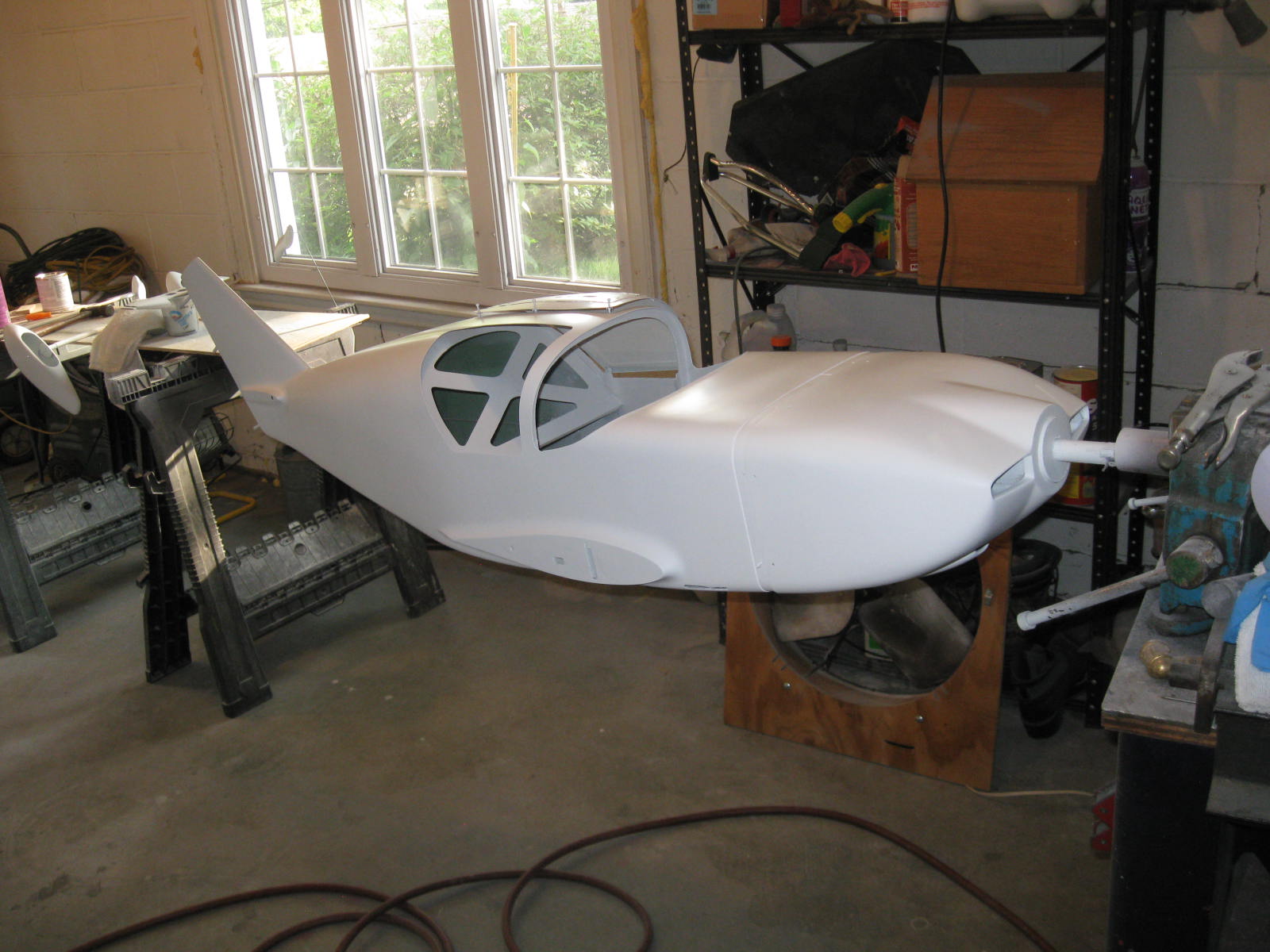

Today the white base coat was applied after a day of guide coat wet sanding. May get the yellow strip on tomorrow if things go according to plan. Thankfully the yellow, orange and red Monokote matching base coat paints are still good. I believe I bought the colors in 2005!

This is a fiberglass fuselage, so there is no wood involved. I used a white base primer then dusted on self etch green spray bomb primer and and proceeded to sand my brains out. The layup is very lightweight so sanding on the flat areas where there are no former was a problem, couldn't push on the block, just used the suction of the water and sanded away.

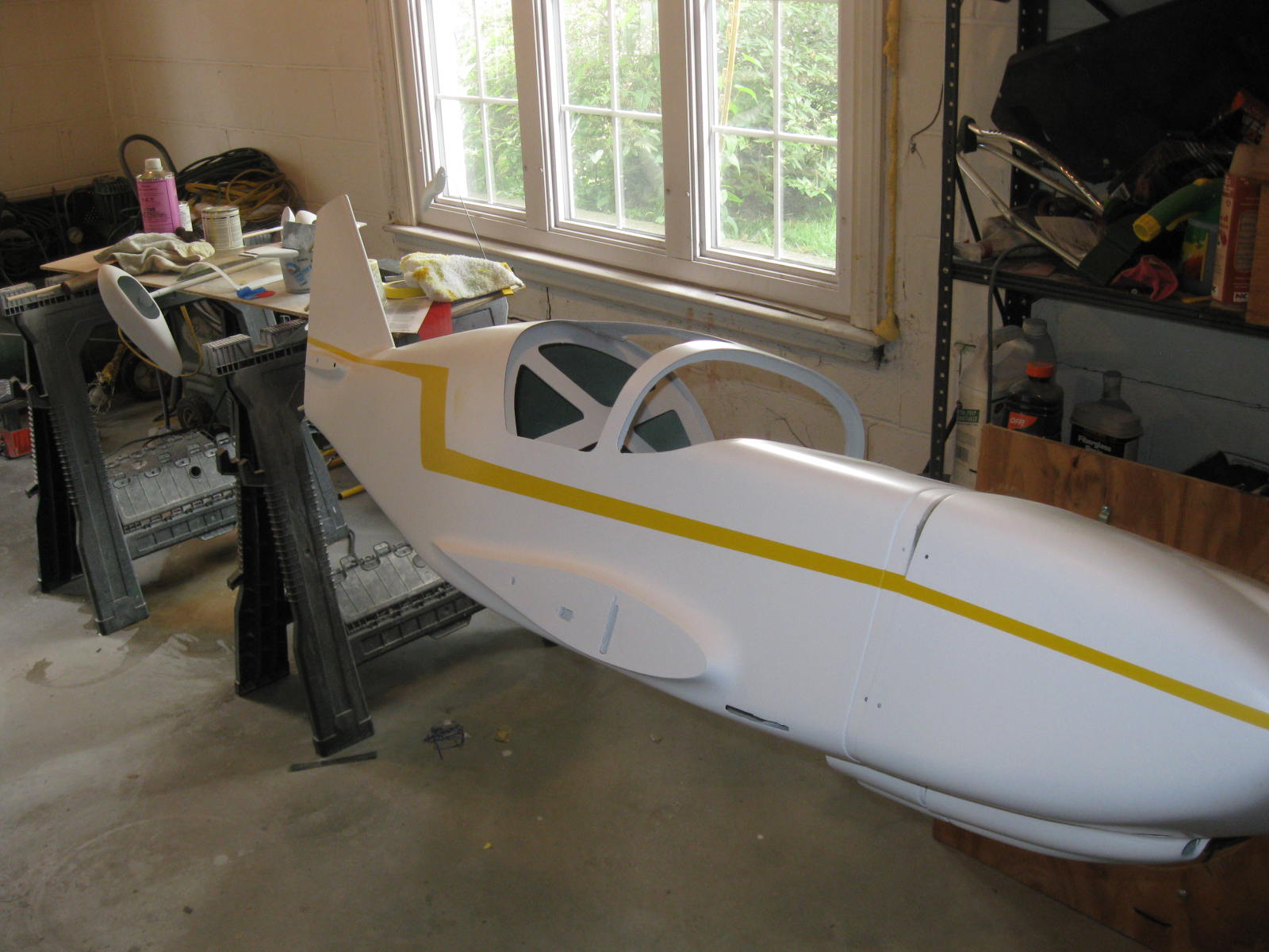

I put the yellow strips on yesterday, going flying this morning and might do the orange later today. Should go quicker today since I will be following the yellow strip. I pulled the fine line tape off several times before I was happy with it.

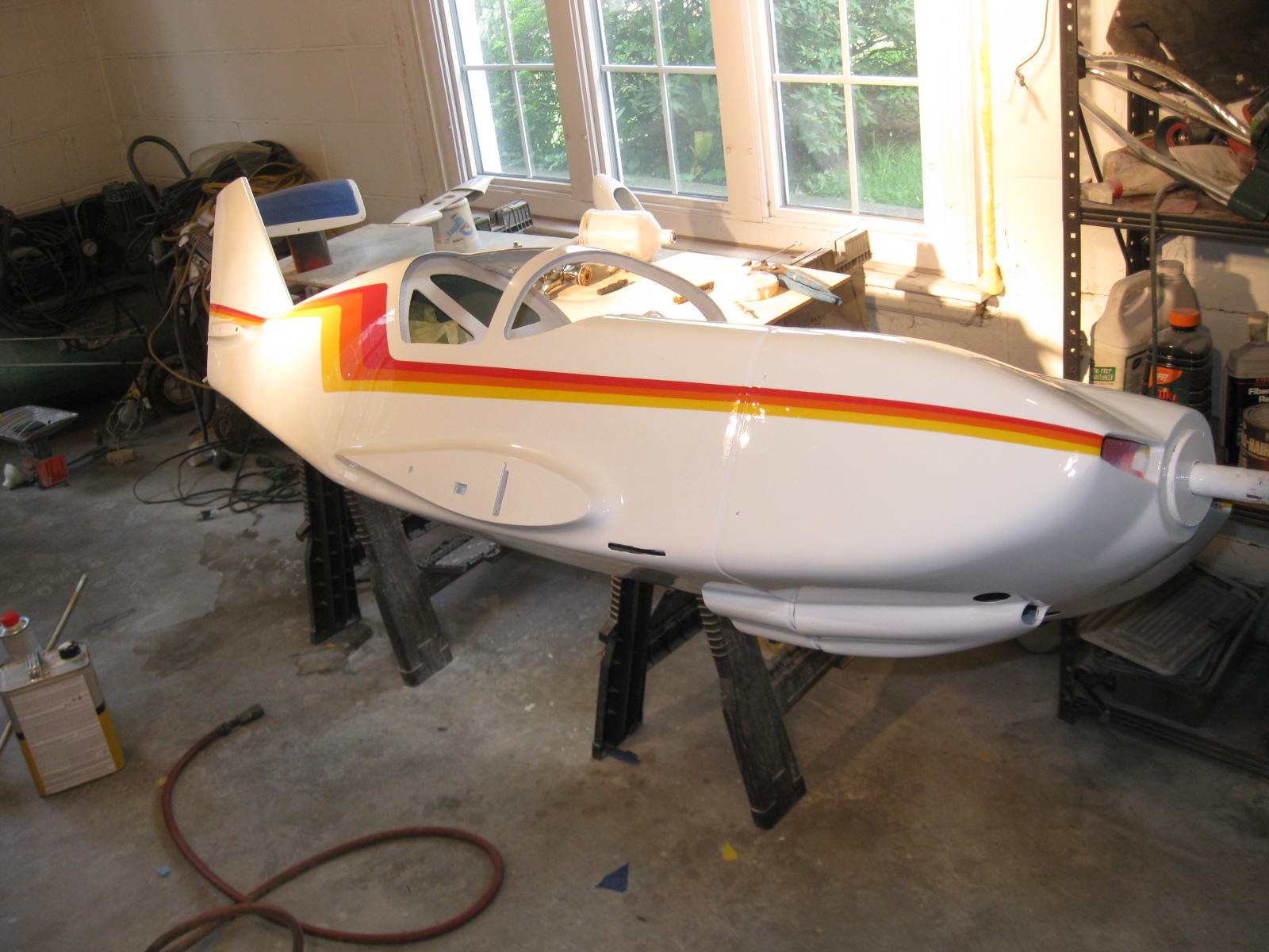

Finally got the clear on. The next time I will paint the strips first, then the white and right to clear. I wasted a lot of time masking each strip. Glue in the side window and windshield and give them a clear coat and final assembly can begin.
