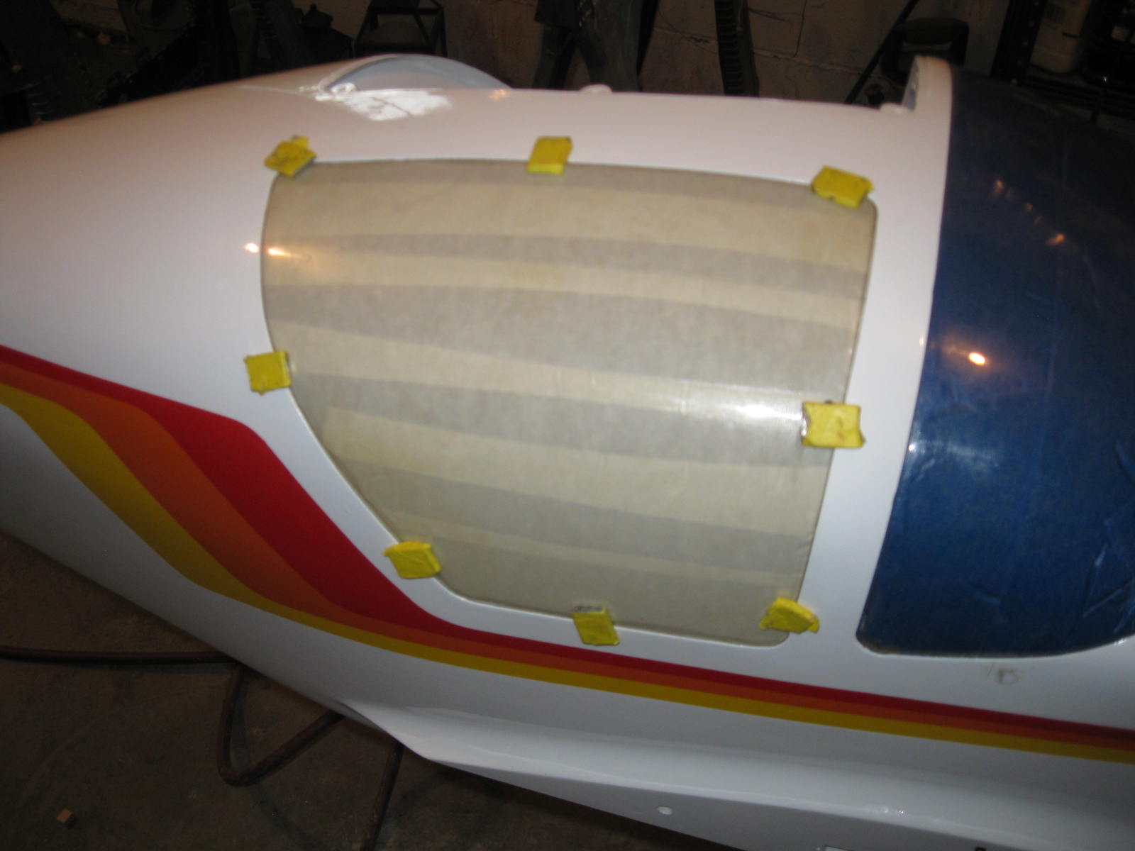

Both windows are glued in. Used pairs of magnets to hold the windows in place while the 560 canopy glue dried. Just found out that the grandsons wouldn't be here until 11:30 tomorrow, just might get the windows cleared before they arrive.

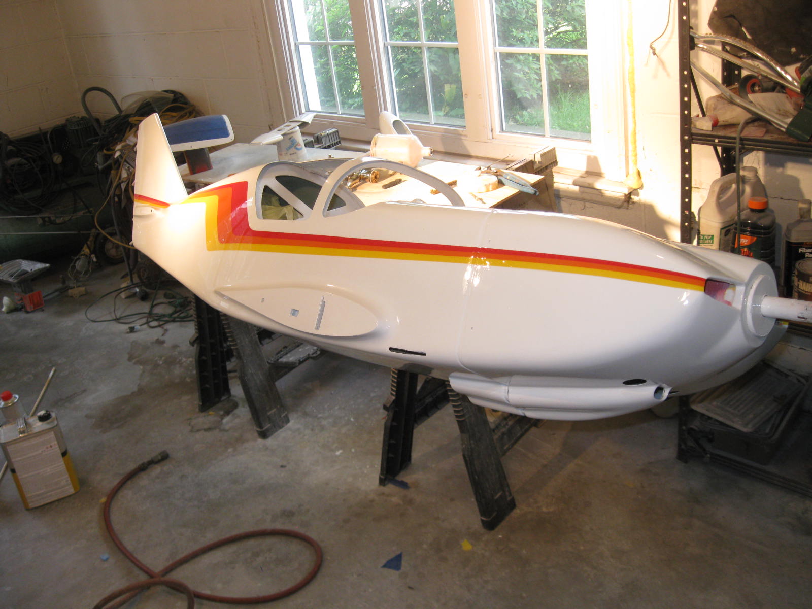

The left side window and the firewall bolts on, the bottom is clean. I plan to install the radio gear behind the firewall. The left side window is access for the spar through bolts.
