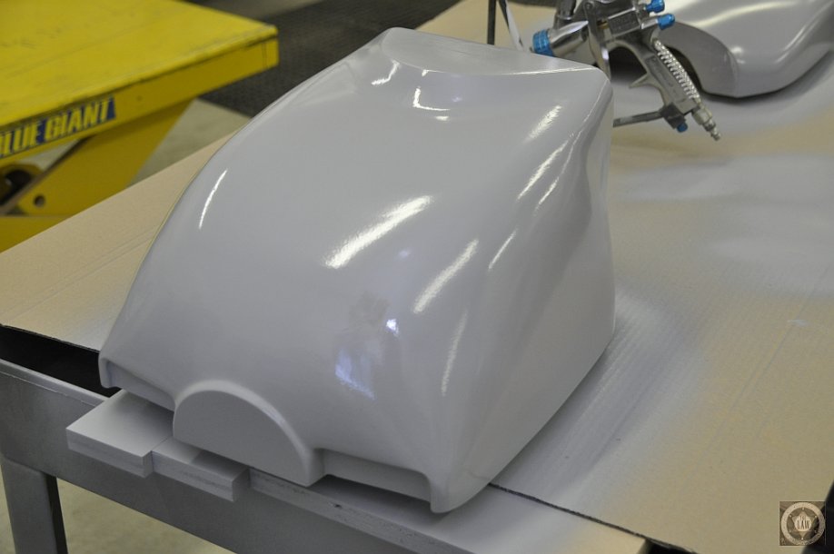

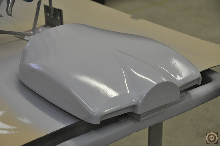

Hey look! It's all a solid color!!! Unfortunately not for long.....more crap to fill / sand / fill / sand:oblong:
Soon! I ordered the last of the materials to make the molds so with luck we'll be doing that next week. I'm already concerned about this bottom part coming out of the mold, but really it should almost be easier than the original cowl that I started with. Mainly smoothed it out and added a scoop were the major mods. I'm sure it'll work out.View attachment 4071 View attachment 4073

Thanks Bart, I blasted on 4 coats with an additional 2 coats in the areas with small blemishes. Most of it will get wet sanded down later today. If it all works out, just maybe I'll get to seal it and clear it later today!

Thanks guy's. Final fill and sanding was done today and I shot a coat of primer before I left the shop. I'll wet sand it tomorrow and will clear tomorrow before we leave. I'll wax and prep it through next weekend while I work on the Viper and some other wings for other projects. I should have my mold making materials early next week.
