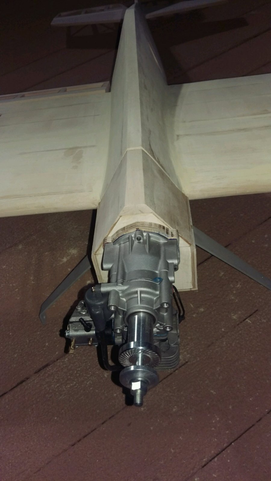

Do you have to mount the motor vertical? What if you turned it 45 degrees (like we did old glow motors) would it fit on center... May have an exhaust issue... Just a thought....
capthis
I looked at the motor being mounted at 45 degrees and it still wouldn't quite line up with where the plans show. I am just going to mount it vertical and down just enough to get it on the firewall. This is a sport plane and not an IMAC plane so I don't think it will matter much.

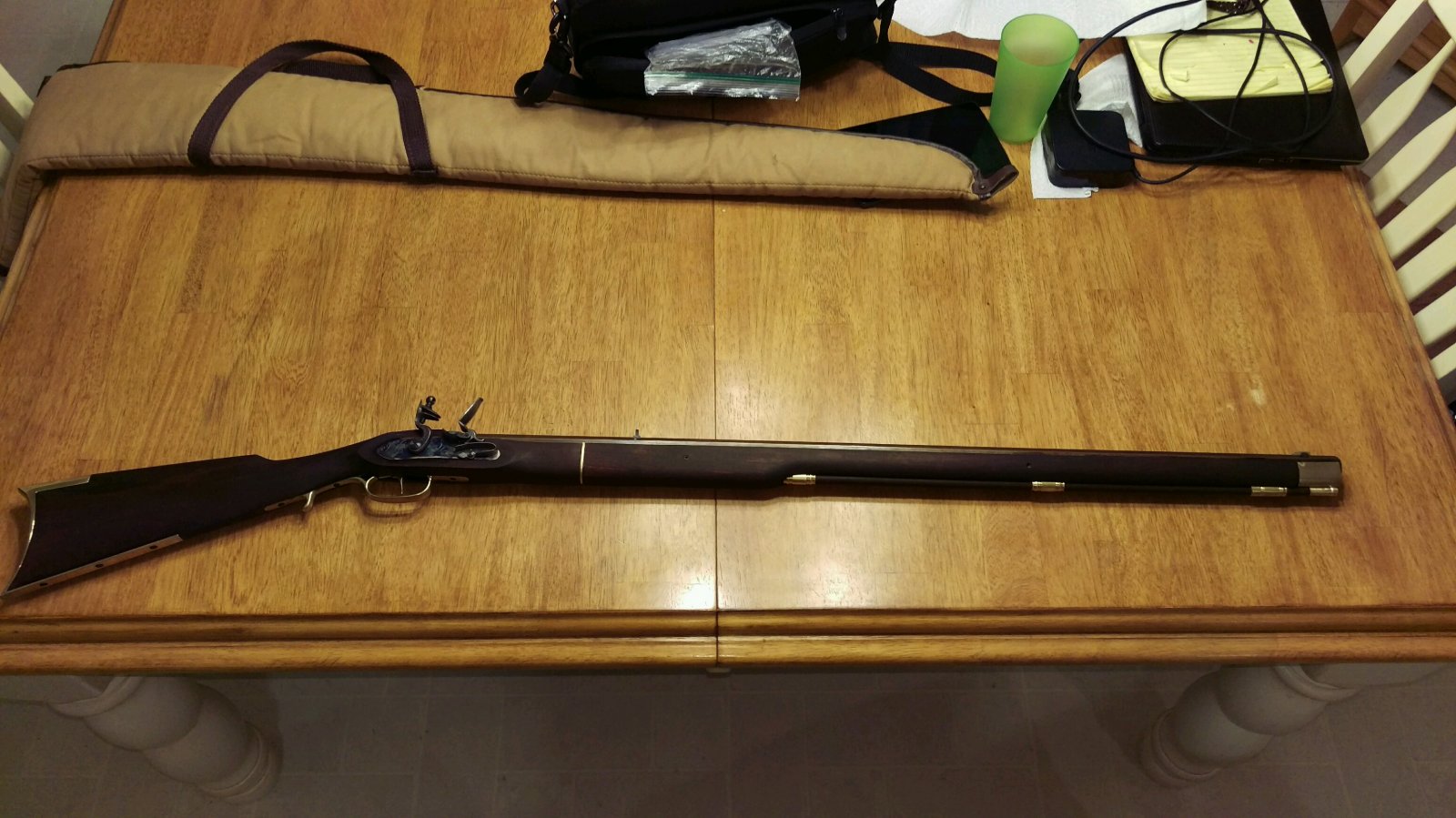

Got distracted building this Kentucky rifle.....

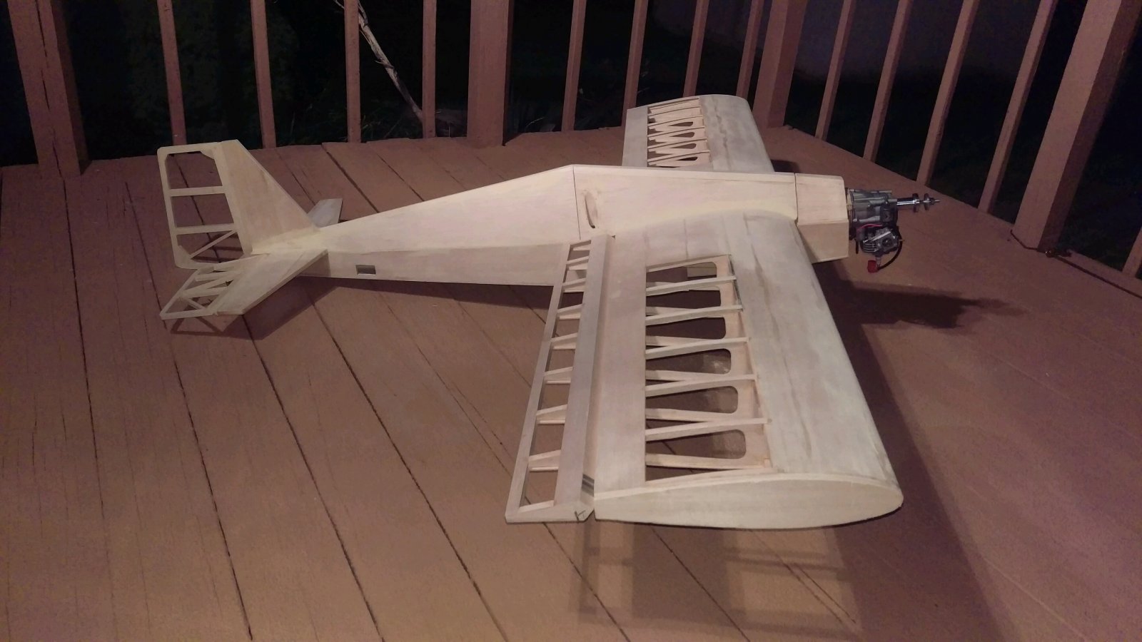

After fighting with that hatch multiple times I finally just glued it to the wing. I then made some tubes by wrapping balsa around a wing tube for my wing bolt access.
I also made a spacer so the Zenoah flywheel nut wouldn't rub the firewall and mounted the Zenoah G26 to the firewall. It's on the center line and I don't think balance is going to be an issue now.....

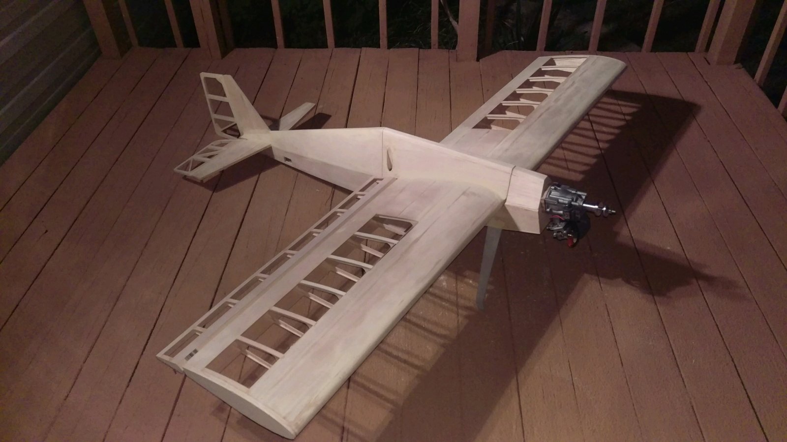

At this point it's framed and ready for final sanding.
capthis
So this project is on hold for a while as I have a few more builds to complete before I completely clean shop (remove all dust) and then cover several airplanes.
It is I think final sanded and essentially ready to cover. I'll report back when I start throwing Ultracote at it! :)
