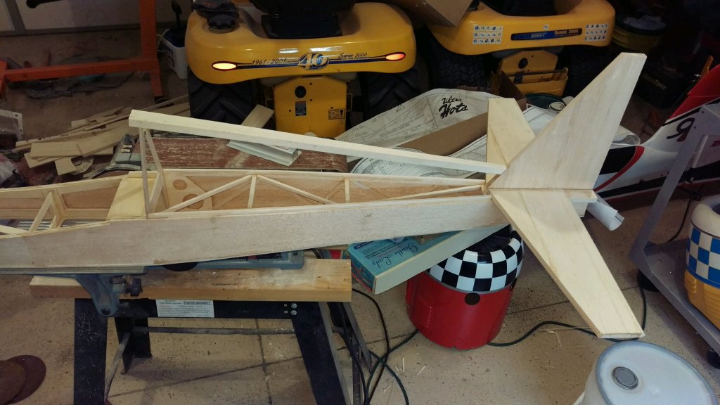

Stabs are now glued on. Added some cross and diagonal braces to stiffen the tail up like Cardens are built. Bottom has cross grain sheeting so it's pretty stiff now. Will add top fuse sides once I figure out and cut in my elevator servo locations.

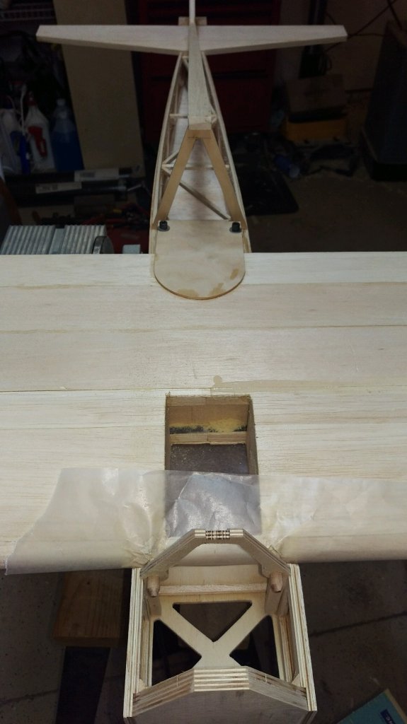

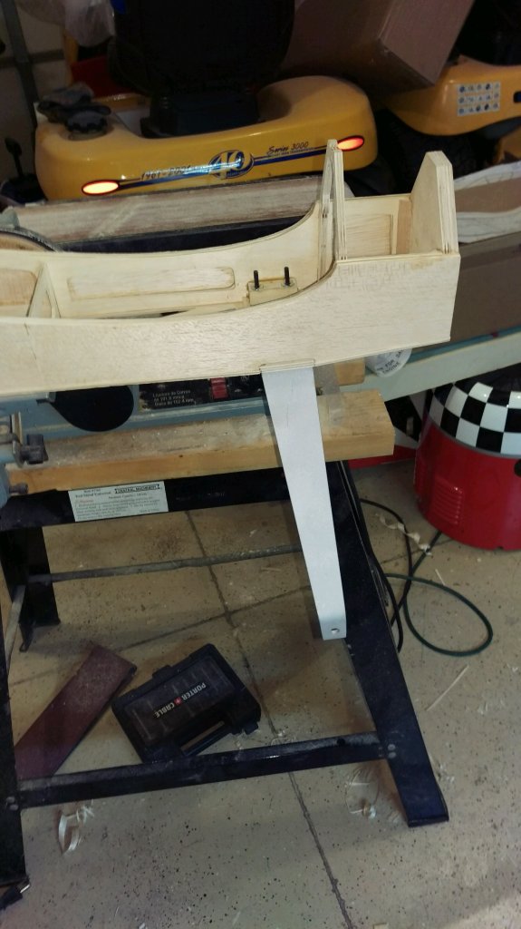

I got the wing on and lined up. I drilled and tapped the ply and poplar blocks for 1/4-20 and then hardened the threads with thin then retapped.
Once the glue dries for the front alignment pins then I can build the hatch and nose.

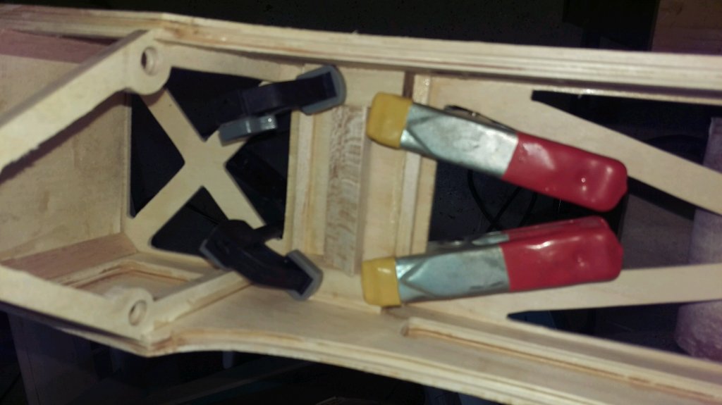

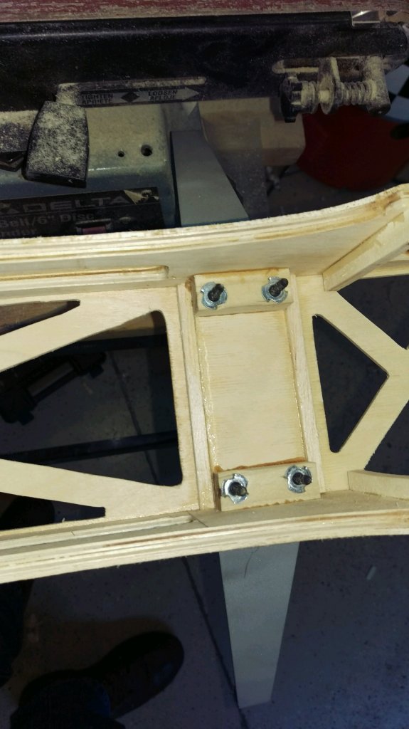

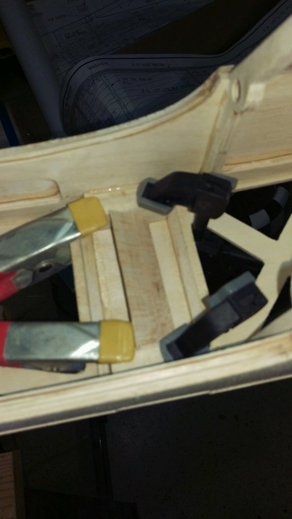

This morning I removed the wing and cut and glued in my landing gear blocks. I used a scrap piece of the tri stock to space them against the fuse sides and clamps to hold them down.
capthis
I really hate epoxy so I've been using tite bond. I've found you can mix some balsa sawdust with it to fill in places too....
While I was taking a picture I really like that Elmer's filler. I think it's glue and sawdust mixed together? It's a lot tougher stuff than regular light weight spackling and is nearly the color of balsa.
