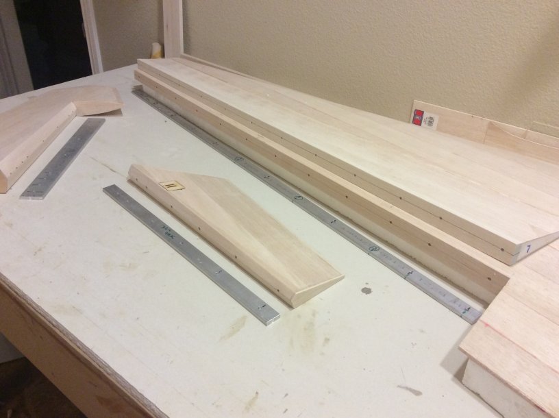

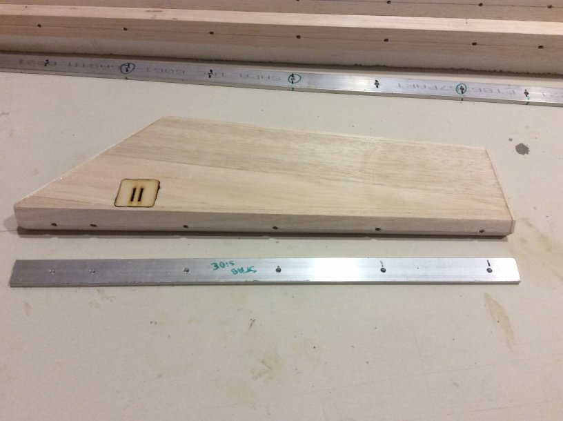

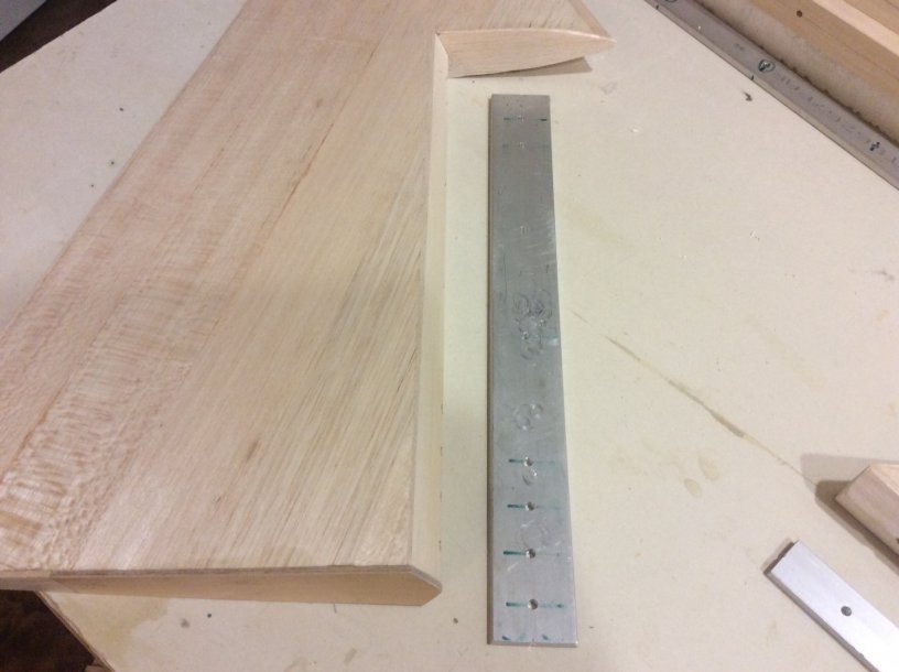

It has been a while but... here is what I did for a drill jig for the robart hinges. I got lazy and took some 1/4" aluminum bar stock and stuck them in the mill. Just had to line up the centerline of the holes and I indexed one end of the bar to ensure my holes started in the correct place for alignment of the edges of the control surfaces. I also didn't have to worry about sanding in the LE and TE to ensure I was on center. Turned out very well, but they are one off's.
