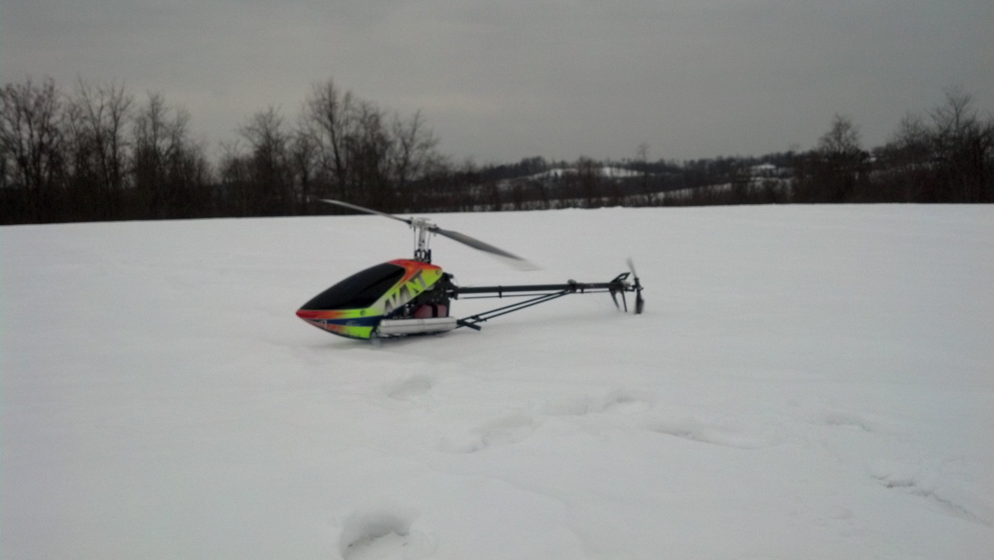

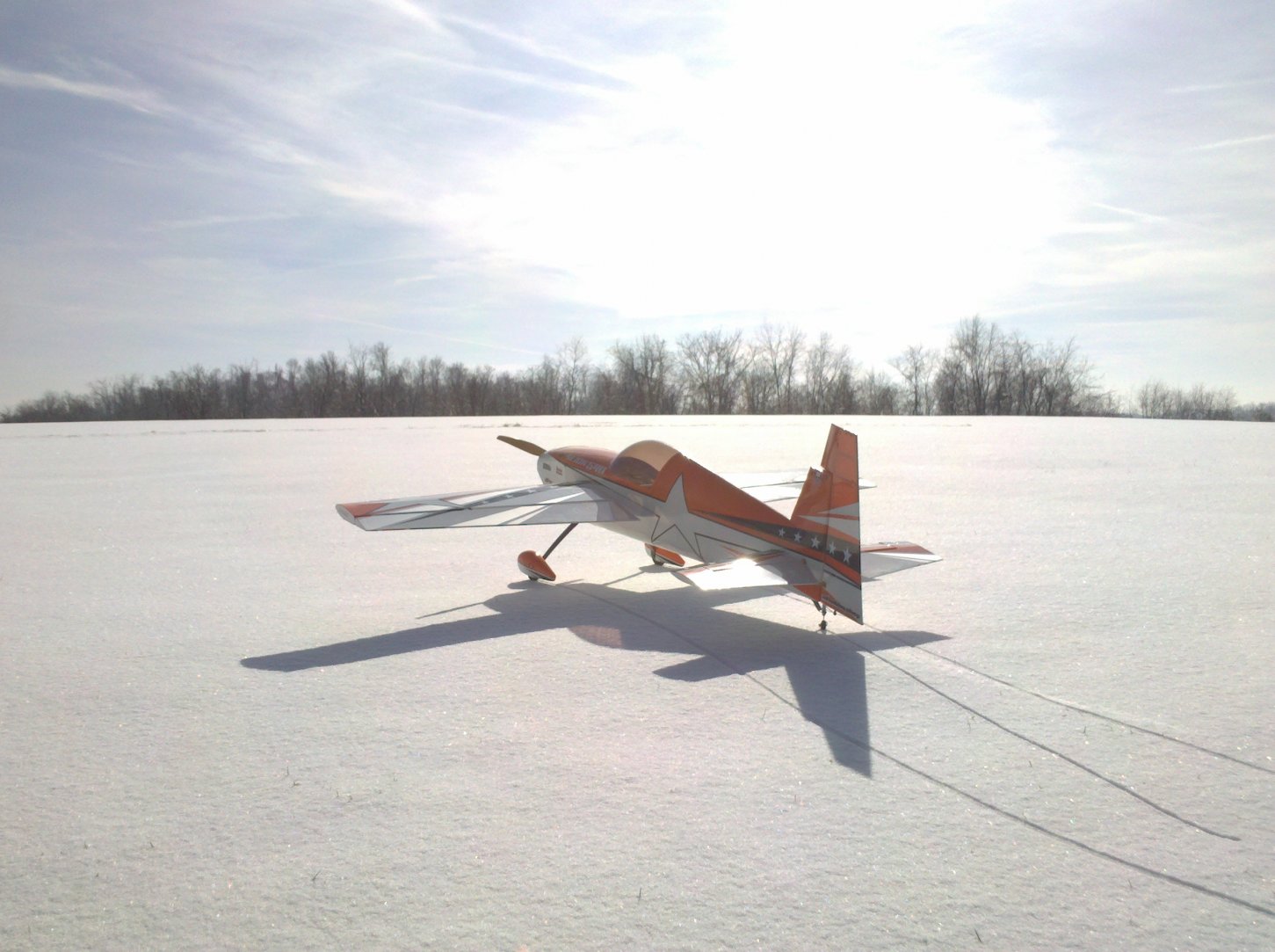

Here are some cold weather pictures for you guys :)
How much are these skids?
I'm using the Dubro's on a 51 Slick and some HK ones on a 72 Extra gasser. The HK ones look a little short but they work great! The Dubros were kinda expensive $24.99 per pair. The HKing ones were something like $7 bucks.
The trick I've found is do not tip them up too high, or it will lift the plane, and you'll have to trim down. Just up a bit, 15 to 20 degrees, and you maybe trim one click. Doesn't affect the handling too bad at all. Makes it fun to land in any direction on the snow - and it's so soft...
Best thing I did was to buy some extra axles, then you just swap them out entirely instead of playing with the springs all the time. :cool:
