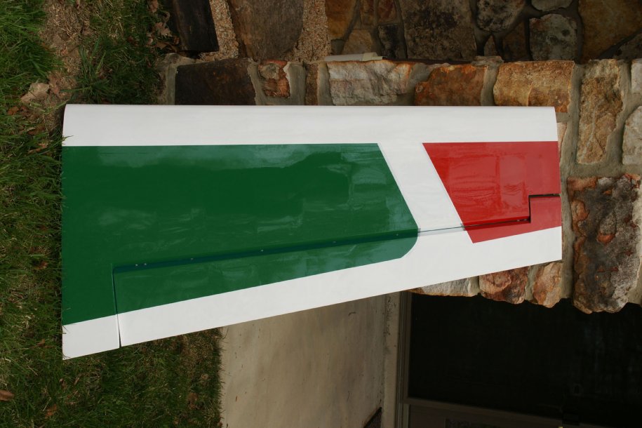

Another great tool to have is a woodpecker to pierce rows of tiny holes in the covering over which you're gonna put another layer. I've used this quite a bit and it really helps buy letting the air go thru instead of getting trapped between the layers.
would you use it on covering over open span
Pistolera
HEY!..GET OUTTA MY TREE!
Yes...I had to on my old Extra's wings. Where I laid the green over the white on the aileron and also a bit on the open bays of the wing where the green and red create the white stripe between them. just make sure your base covering is nice and tight....and sharpen the points on the blades of the woodpecker. As Terry mention, mark of where you overlays are going and then woodpecker, leaving about 3/8 - 1/2" border "un-peckered" :oblong:.
This covering job held up very well thru 4 seasons and never had any issues with it lifting. Occasional wrinkles were easily removed with the heat gun and rag. Even where two colors were laid.
