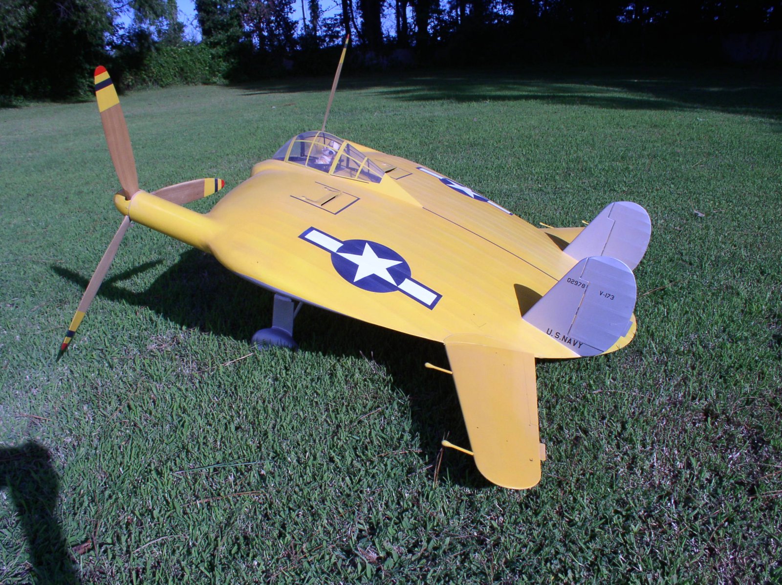

Scale Curtiss XP-55 Ascender
JeffH
You probably want to ditch the zinger prop. Get an APC Electric or Xoar, or any one of the props designed for electric use. They have a thinner profile, more efficient airfoil and are much better suited to the profile of an electric power system. Your thrust will go up for a given amp draw, or you can get the same thrust at a lower amperage, either way is a win.
I am sure that you have realized that one of the pluses of electric power is that you do not have to worry about getting pusher props, just reverse two motor leads and and use a normal prop.
Larry B
Hi Jeff,
I decided to run a normal prop instead of a pusher, this will give me a bunch more prop choices if this silly thing flies. Thats the cool thing about electric as you know, I can make it turn either way.
I am going to do the test flight with the Zinger only because I have one, once again if the thing flies I will look at making a good choice of prop for the electric set-up. I would just hate to break a good prop with this thing, of course the prop and motor are at the tail which may save them during the impact!
JeffH
I can see your point. I like to use the good stuff up front, power system wise, so that I know what I am dealing with. If it barely flies with a good prop and batteries, then I know I need more testing before I do the detail work. Conversely, if it is stupidly overpowered, you know you can add some weight and also fly at a lower throttle setting. Of course, if it flies with a Zinger, it should fly with anyting :way_to_go:
