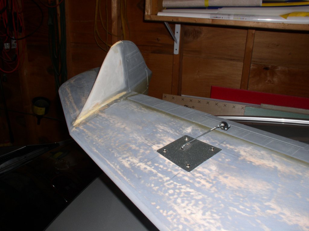

A few photos of the progress,

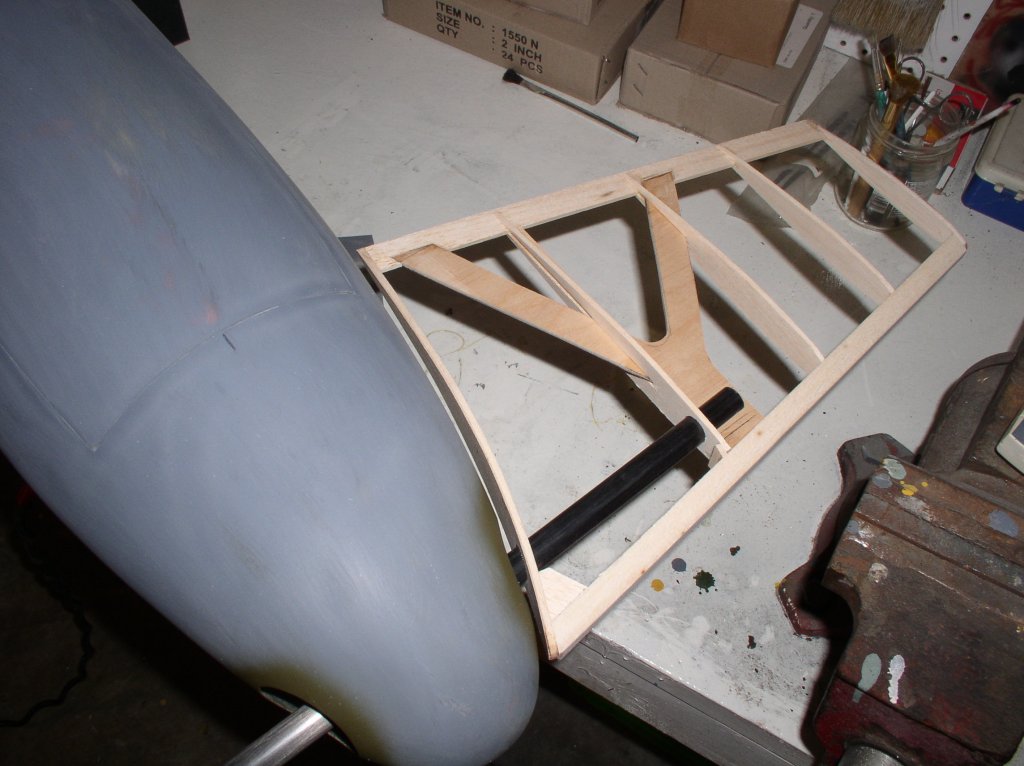

Looking good Larry! I'll bet figuring out just how you wanted to do the Canard/Elevators was a challenge.
Larry B

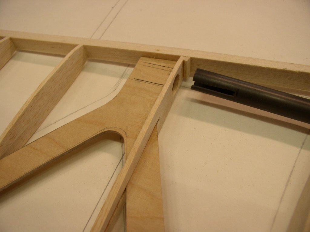

Thank you for the compliments, I decided to make the canards traditional built-up construction. I felt it might make them a bit lighter and as it turned out for once I was correct!

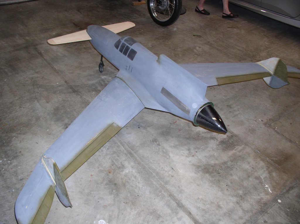

I just finished glassing the first side of the canards but before I did that I had to get a "all together" shot.

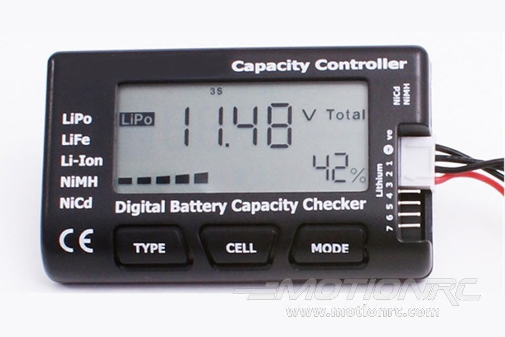

Larry, get yourself one of these or something similar. There cheap and can save your airplane. I got in the habit of always checking packs right before I strap them in. That way you know you put a charged battery in and not the one you just flew with.
They will tell you total voltage, cell voltage, and percentage of capacity remaining. All for less than $20.
