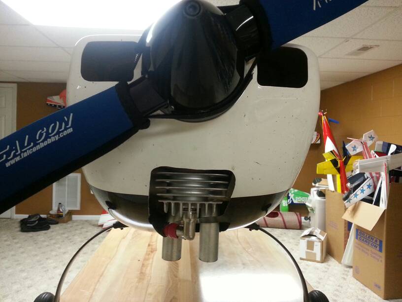

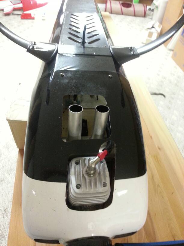

Top and bottom views.
That's looks ok to me. Next check the cap in the gas tank. It's more likely running lean because the gas has dropped down to the gas cap level and starts sucking air.

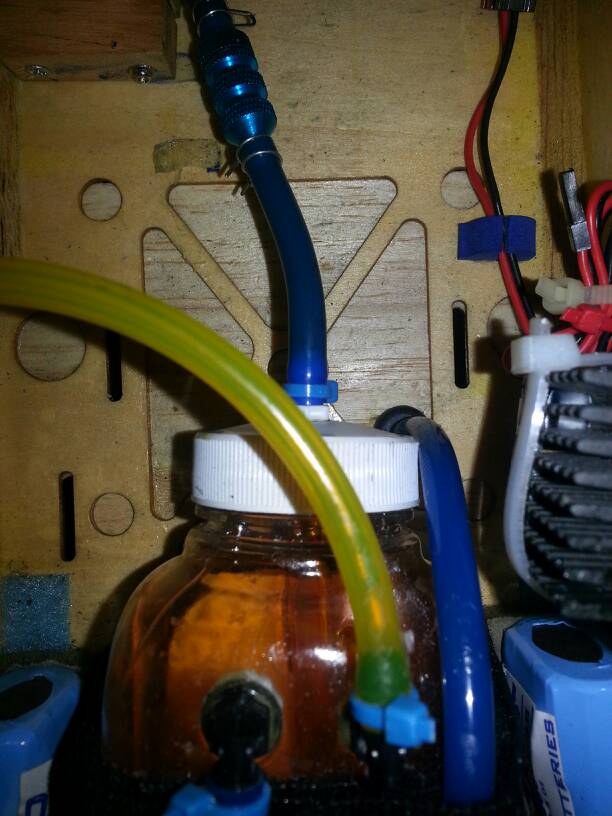

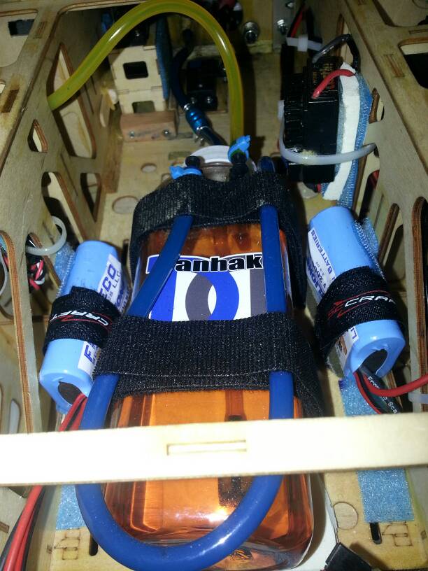

It's a Fortitude tank and cap appears secure. This is my first gasser. Here's some photos of the set-up.
I have a Fortitude tank in my EF Edge without any problems. Two weeks ago my buddys Fortitude tank lid got loose and dumped 1/2 the tank in a brand new EF Extra. I have a strong feeling that your problem is coming from your tank. From what we can tell it looks like his glue around the cap just dissolved on his.
kgalen
30cc
Ok thanks so much! I'm ordering a new tank tonight. In the meantime, do you think silicon sealant around the cap would work?
Dr. Gonzo
I would just check tank before ordering new. Look for pinholes in your lines loose fittings etc. I know I am stating the obvious. The obvious somtimes is the easiest to overlook.
