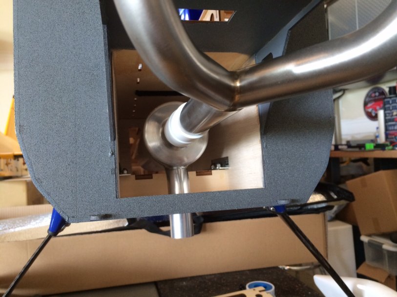

Finally got time to fit the large proflow canister. Looks like I'm going to need to shorten the 2 into 1 by 1-5/8" to get everything to fit into the 93" Laser. Does anyone foresee any adverse issues that would arise from shortening it that much?

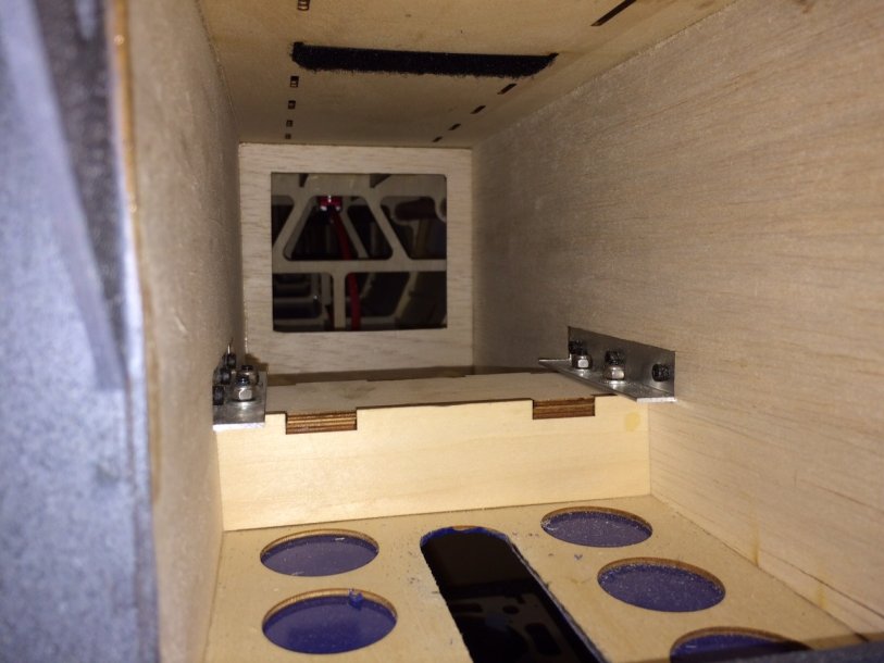

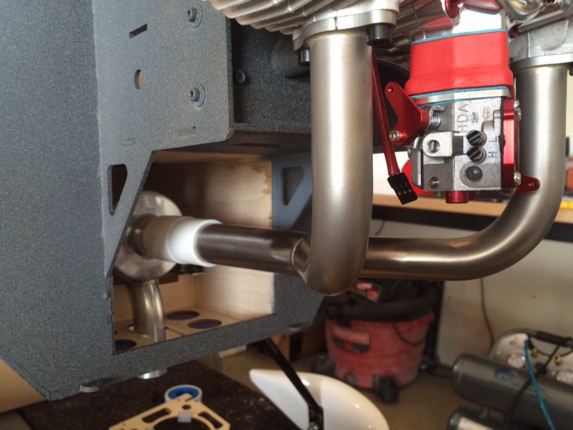

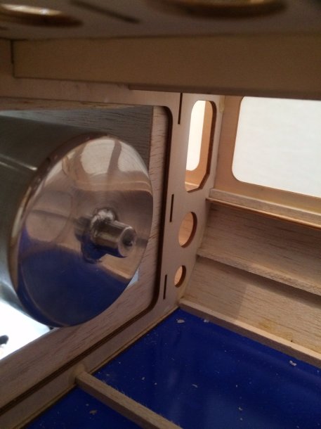

@Kevin-Young thanks for the input. I was able to get it to fit without cutting the pipe down. I cut the tunnel instead...
Sorry I have been a sleep here. Very busy these days in the shop. The 2 into 1 set up works great on a Large Pro Flow Canister or our large Smooth Pipe. You will see a little larger gain running 2 pipes as opposed to only 1. Either way the new DA-70 is a good little engine and has sky high potential.
