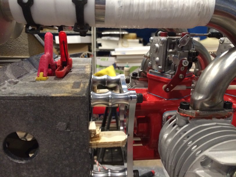

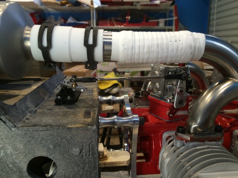

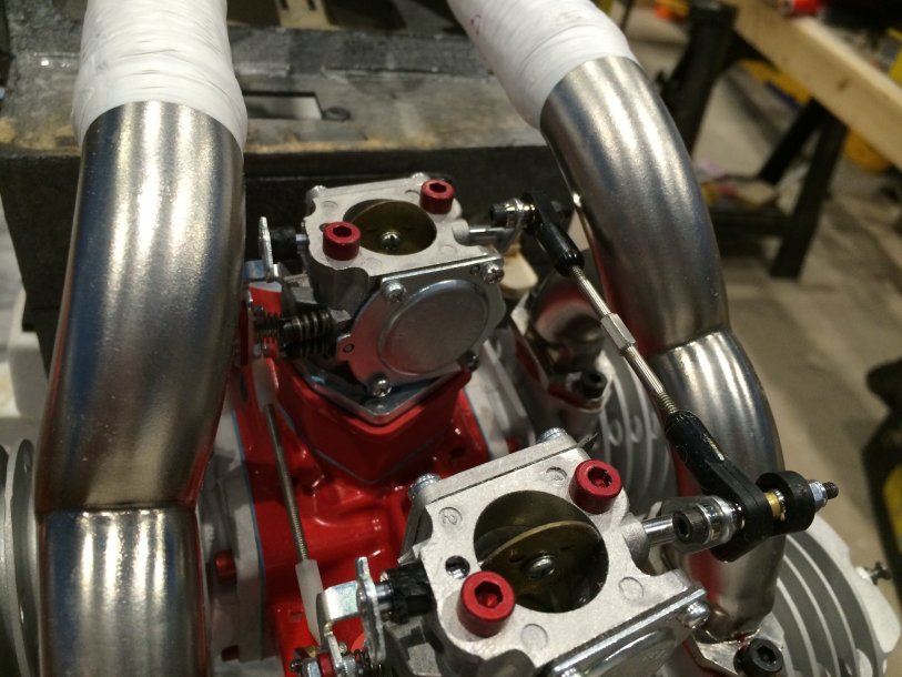

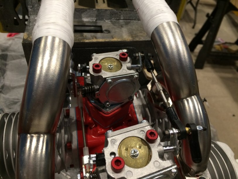

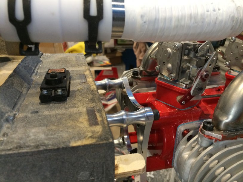

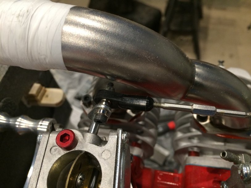

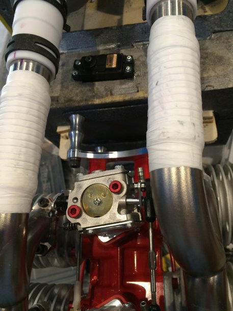

got it!! i made myself a throttle arm out of aluminum. all i need now is a servo arm for JR, aluminum as well. need to go to the LHS!!!

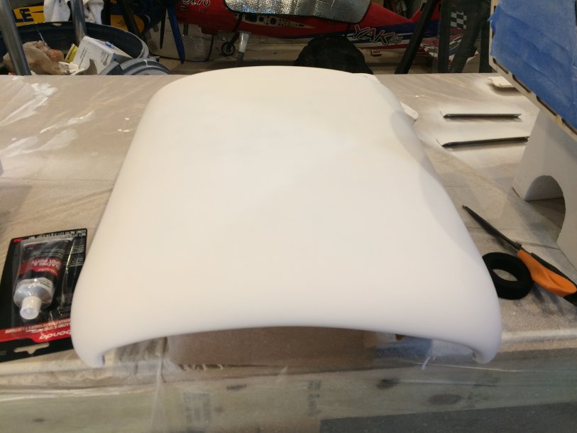

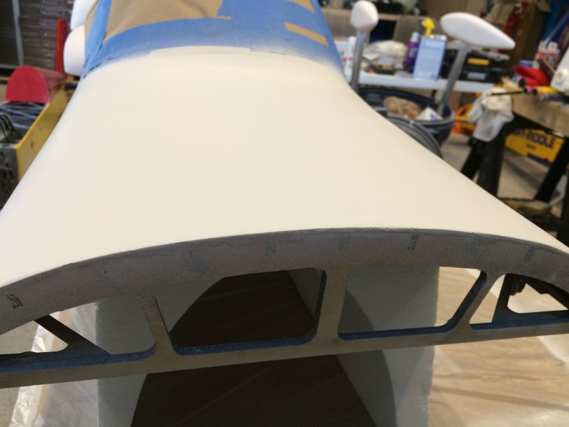

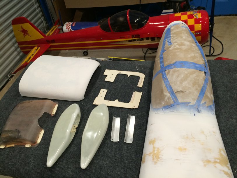

I just finished applying primer to the cowl/canopy/hatch/wheel pants/shroud/baffle plates/air dams!
on the cowl and hatch there are millions of pinholes!
and the hatch still has some imperfections.
i had done the primer with microballons, which worked, but lots of work.
i will try some of the spot putty from Bondo (907)
see how that does.
still needs more primer... more sanding...
i am not yet happy with it.

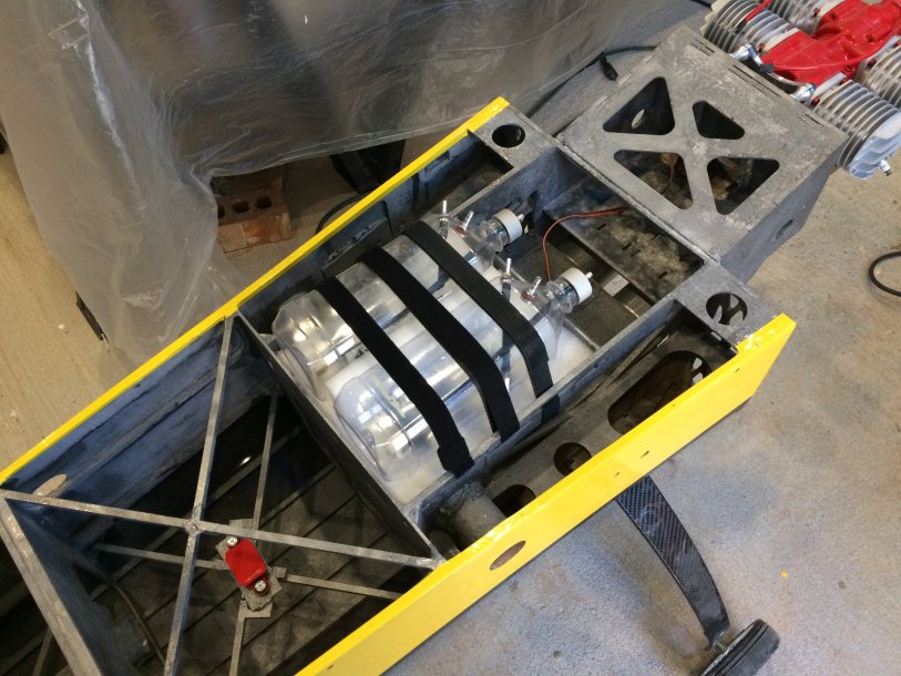

he tanks are installed. waiting on some fuel dots from aztech rc, and then i need to manufacture some type of fancy looking air vent tubes!! anyone have any ideas??

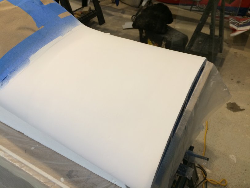

the hatch and top cowl are now on their 2nd coat. and not too bad!!
i am thinking, in 48 hours, a light sanding of 500 paper, then an additional 2 more coats before i sand for the last time.
