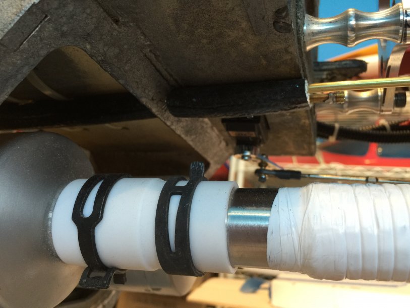

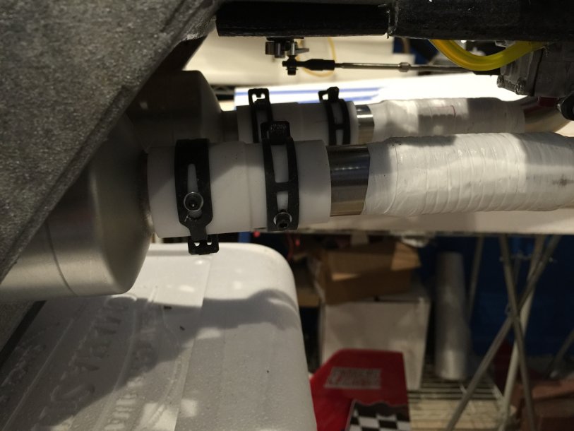

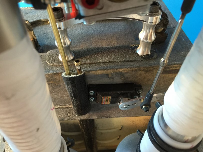

well, i do not know if you can see this in the pictures.
What i have done is installed a brass tube from the engine compartment that travels to the fuel tank bay. This results in shorter Tygon fuel lines.but, what i want you all to see is this covering i installed around the brass tubes. this is a thermal heat sleeve. 1/2" inner diameter. this is stable up to 500 degrees F.
hopefully this will help prevent the fuel lines from getting too hot. you can get them from JEGS.

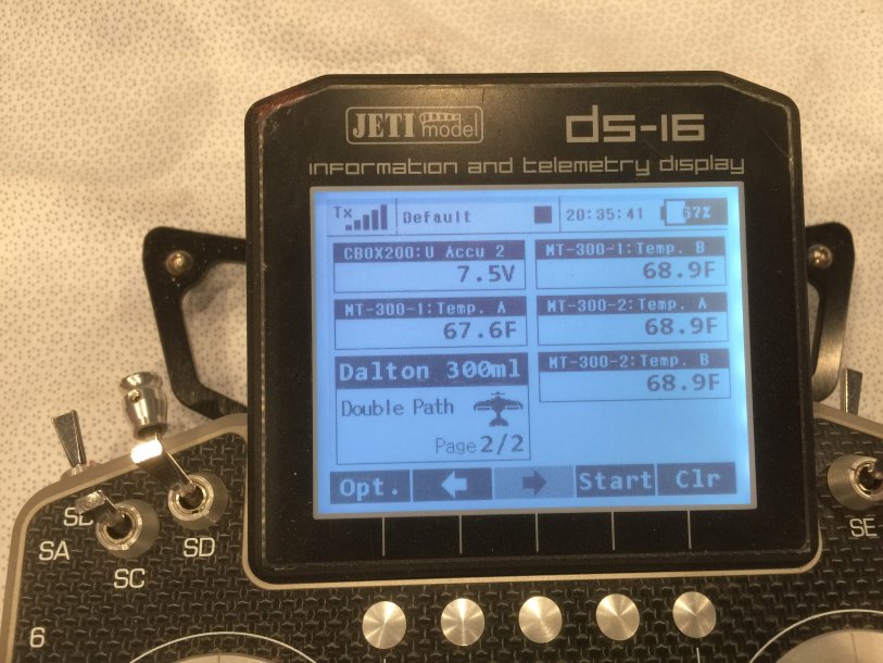

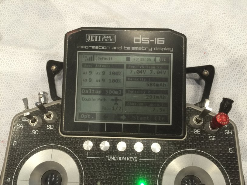

this is cool!! i did set up the elevators and rudder servos. They are installed and all the turnbuckles are installed with the 6-32 ball links. .ALl the tail servos are also programmed, balanced, matched, etc.... i also organized the throttle wiring/CDI/IBEC wiring all the way to the Rx. I also did the telemetry, and programed for the Tx to display antenna strength, temp of each cylinder. Temp1a is right front, 1b is left front cylinder, 2a is right rear cylinder, and 2b is left rear. also, display each batteries voltage and each batteries Mah consumption. I will also set up an RPM, not done yet. have to wait for the cowl to be finished to install the RPM sensor. I also have two IBEC that connect into two separate ports on the Rx, this is for ultimate in redundancy. The DA manual requires for the quad cylinder to connect the two power in from the CDI into a Y connector, which can then be connected into one IBEC. But i have taken it to the ultimate in redundancy. THE IBEC is also installed.
