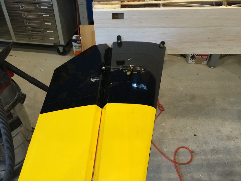

Got more done. When I get home today, I will glue in the tail section...

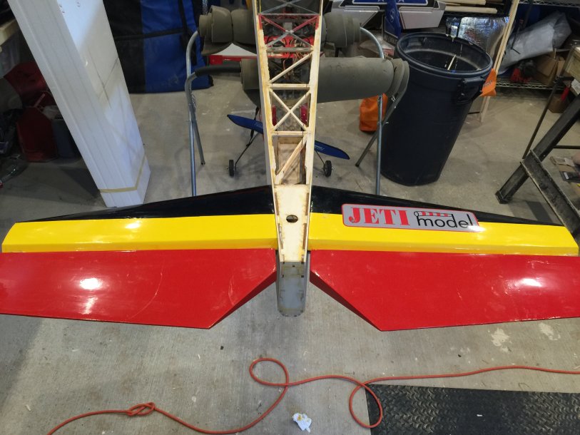

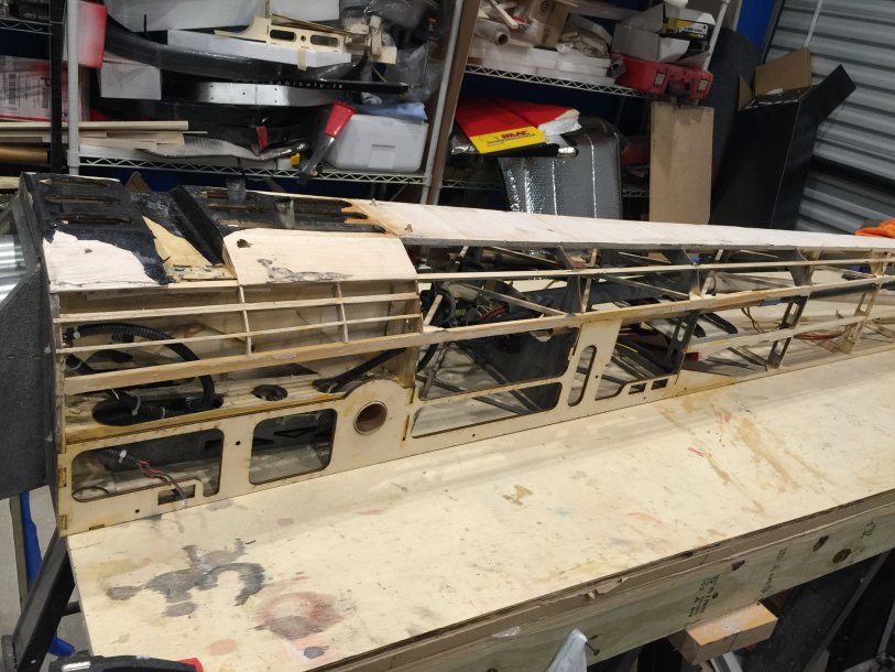

the tail is 100% repaired!!

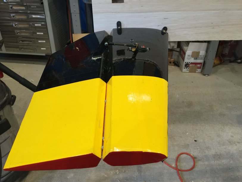

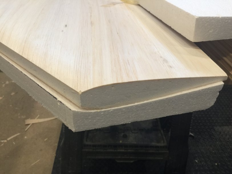

Ok, back on track, the fin has been sheeted, just need to cut it out, and glue on LE and TE.

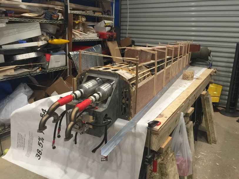

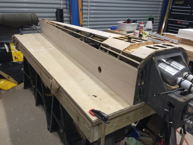

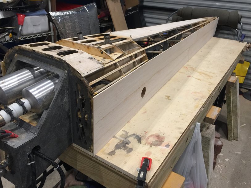

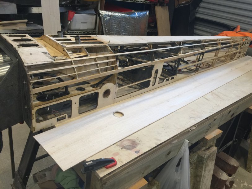

The skins for fuselage have been prepped, and sanded down, just need to glue them on, then trim.
Getting much closer now!!

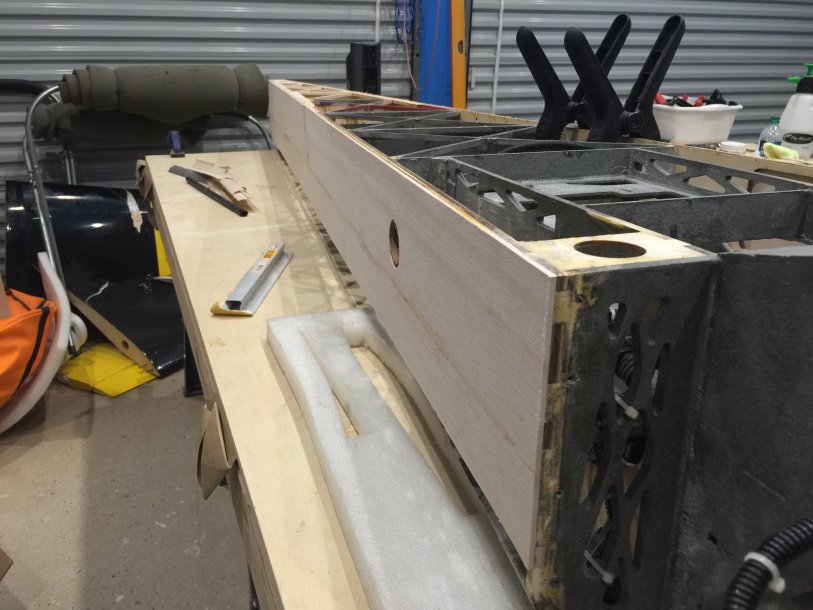

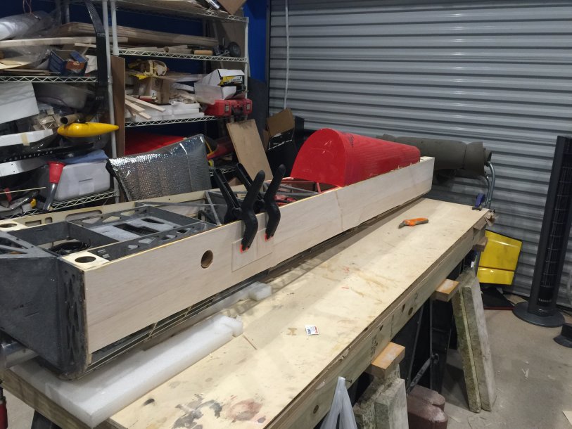

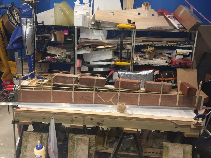

Just glued the skins on the fuselage. Now to wait for it to cure, I will remove the clamp tomorrow morning and inspect everything then trim it.

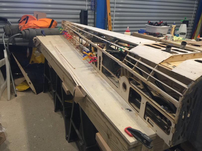

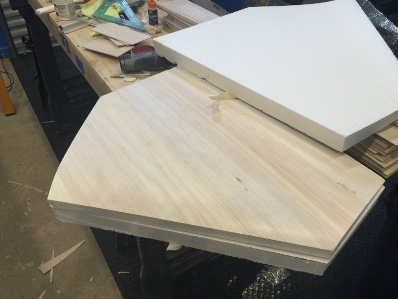

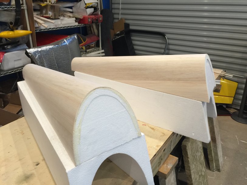

I have sheeted the turtle-deck. The second one is for the other 300 ML that I will build, and possibly sell, if anyone is interested.

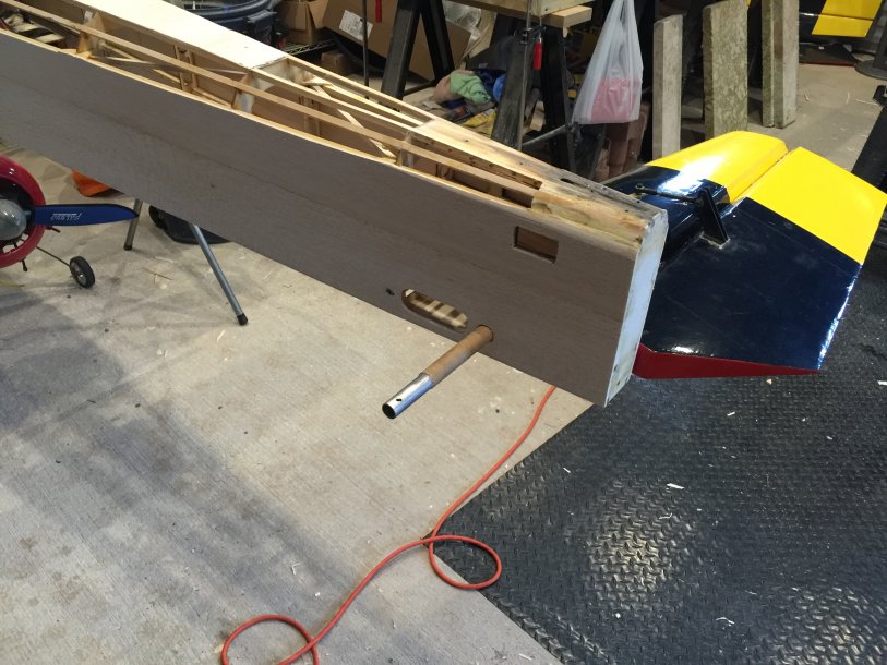

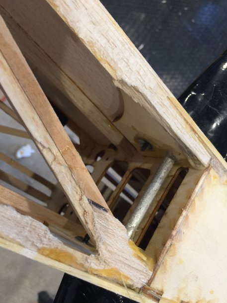

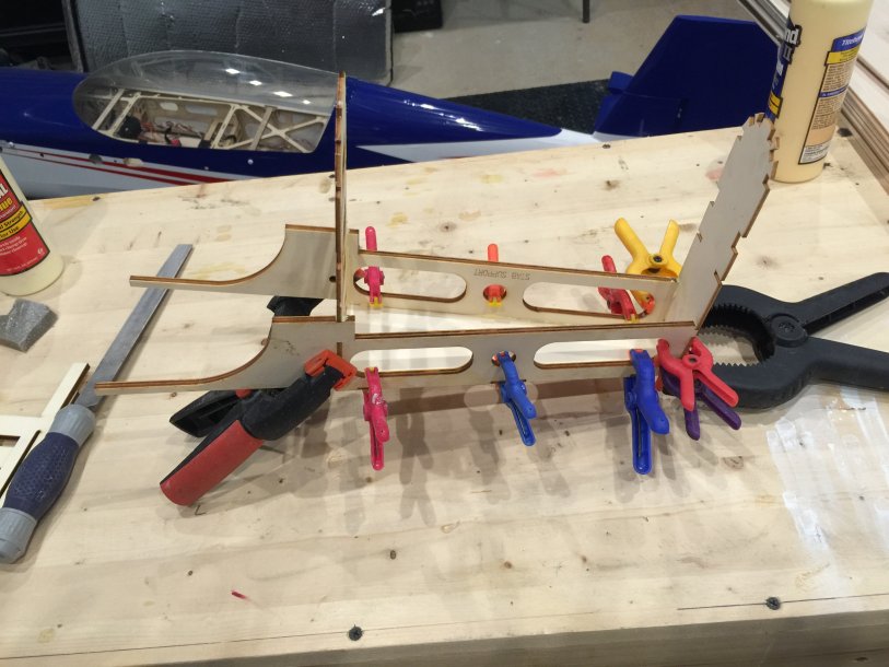

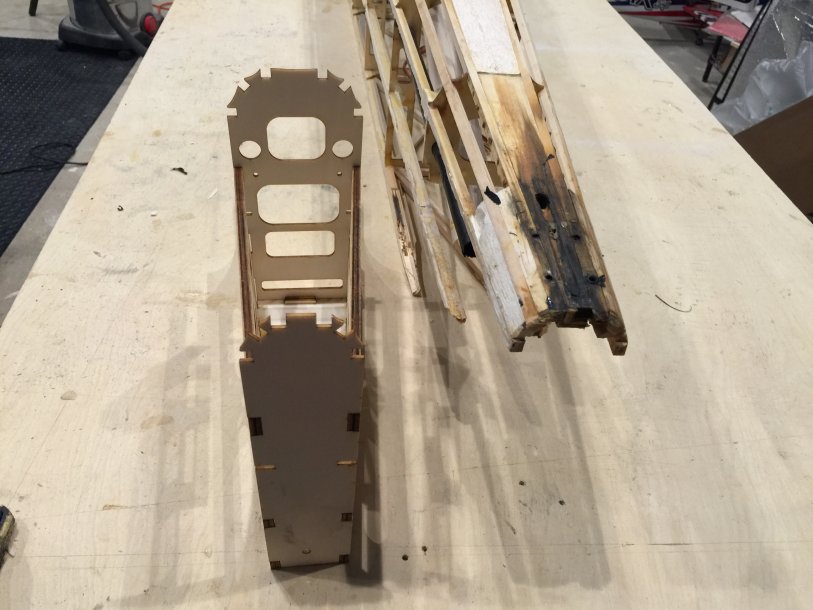

I have trial fit the phenolic that fits in the tail, then I cut it, and have glued it in, with the stabs installed, so as to hold the tube aligned. I also glued in the 6/32 blind nut, on the inside of the tail to hold the stabs in place.

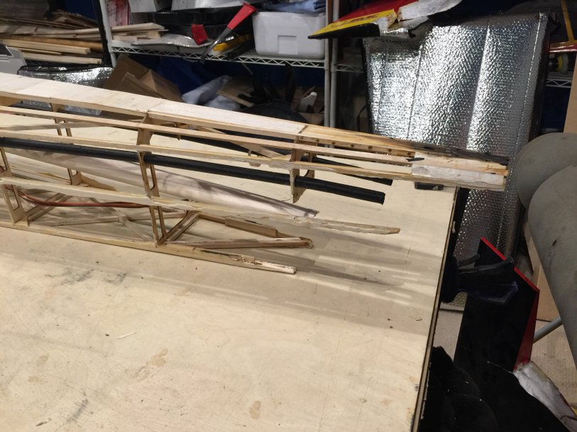

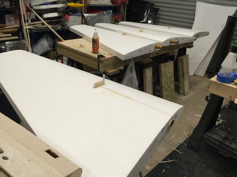

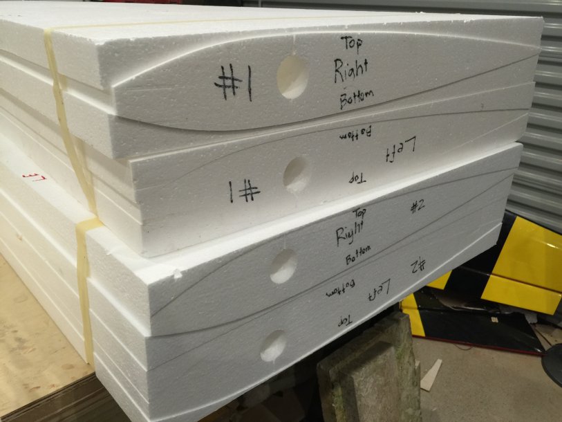

started on the wings. One set of wings is from 2013, the other set is from 1 month ago. The old set, is interesting, has a shorter phenolic, the new ones, the phenolics go in deeper.
