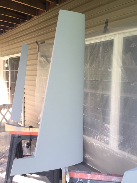

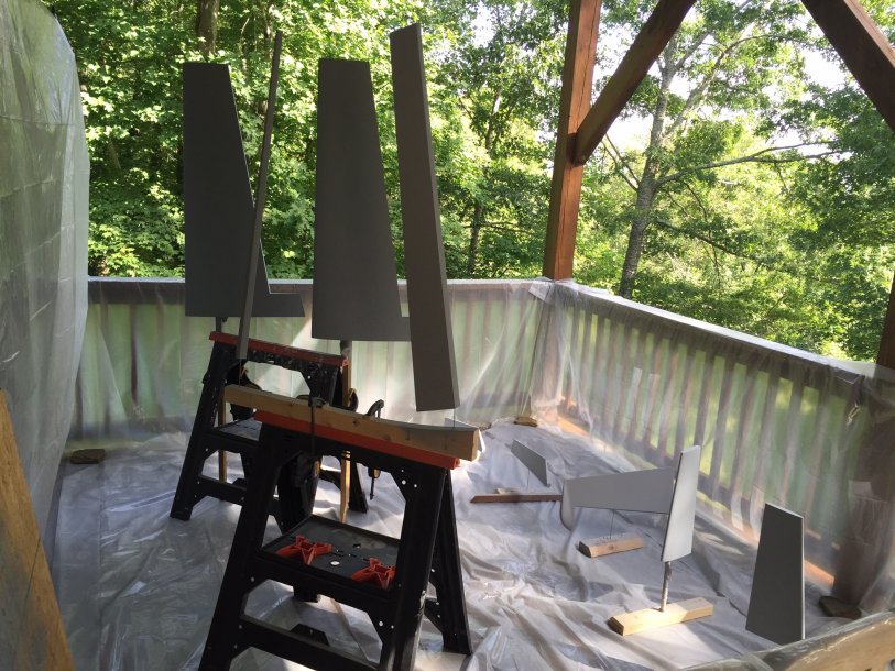

I used the Mini-Mite today and while I have some learnin' to do I am totally impressed! First, I managed to prime all the flight surfaces with the system which I'd never used previously without one drip in the entire group of parts...I've never sprayed anything without a drip in my life.
The sprayer works great. I mixed the primer (Nason 2k) per the Nason recommendations at 4:1. The HVLP system provides a little funnel thing which you're supposed to fill and then time how long it takes for the contents to run out...my mixture took 20 seconds, but Fuji suggests it should take 30-40 for primers, so I risked it and used it as mixed. It worked fine, the surface finish is a bit rough but this is a high fill primer so I'd expect that anyway...next round I'm thinking about mixing much less activator in to see what happens if I get the viscosity to Fuji's recommendations as opposed to following Nason's mix ratio...but that makes me nervous too....
There is ridiculously little overspray with this system...you can see (sort of) how little is on the plastics after I sprayed...essentially the only significant overspray that exists is on the smaller parts where I had the gun pointed at the part with plastic right behind it...where parts had space around them and I sprayed the part with nothing behind it there was a tiny amount of overspray!
I couldn't be happier with the Fuji System...blows the old compressor and High Pressure guns out of the water.
