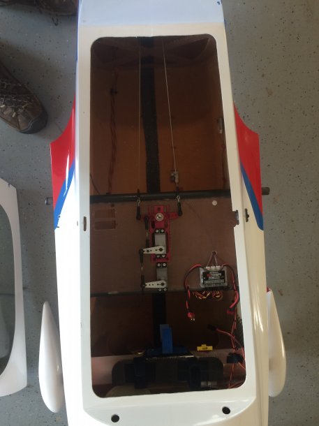

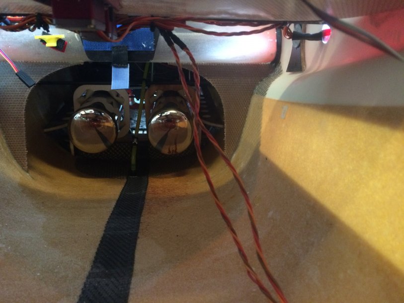

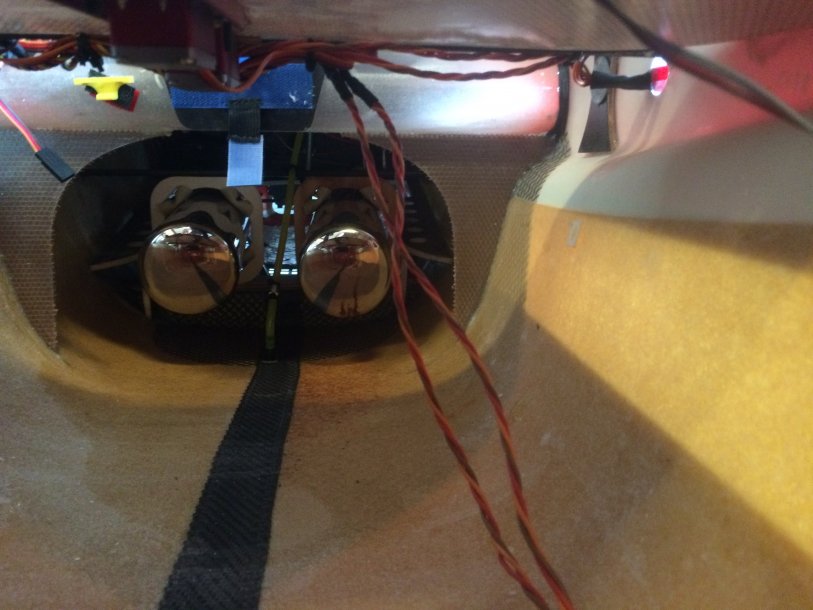

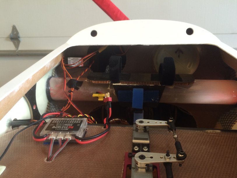

I'm not sure what pics you want... here's a few from inside.
This is Gotz's plane, and he had some different gear in it, then i put my stuff in.

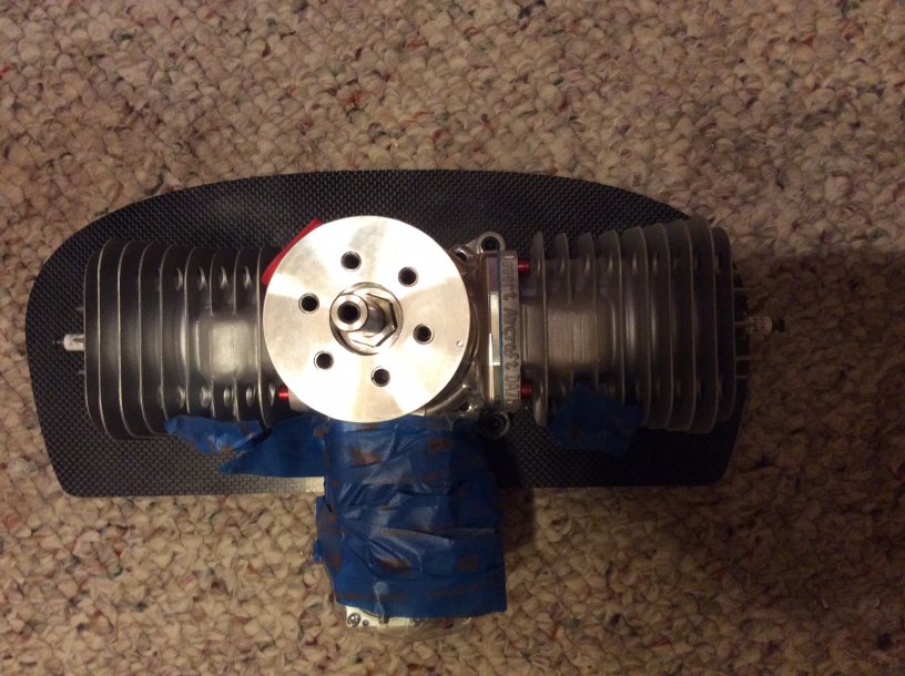

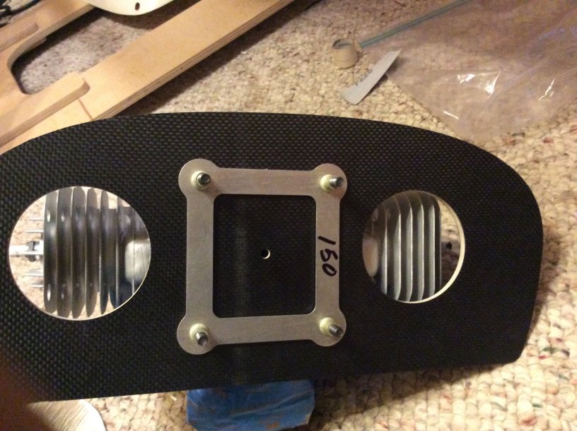

Okay after talking to Delro and Matt posting some numbers for me I'm sticking with the DA 150L. I've been contimplating a bigger powerplant but have decided to try to keep it light. I have the engine mounted to the firewall using a whiterose back plate.

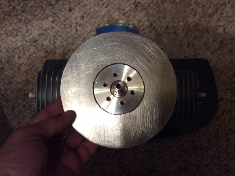

I made this washer out of 1/8" aluminum. It will fit over the prop mount and under the spinner to give me my spinner gap. At least that is how its planned out in my mind. Will try to get the firewall glued in the morning.
