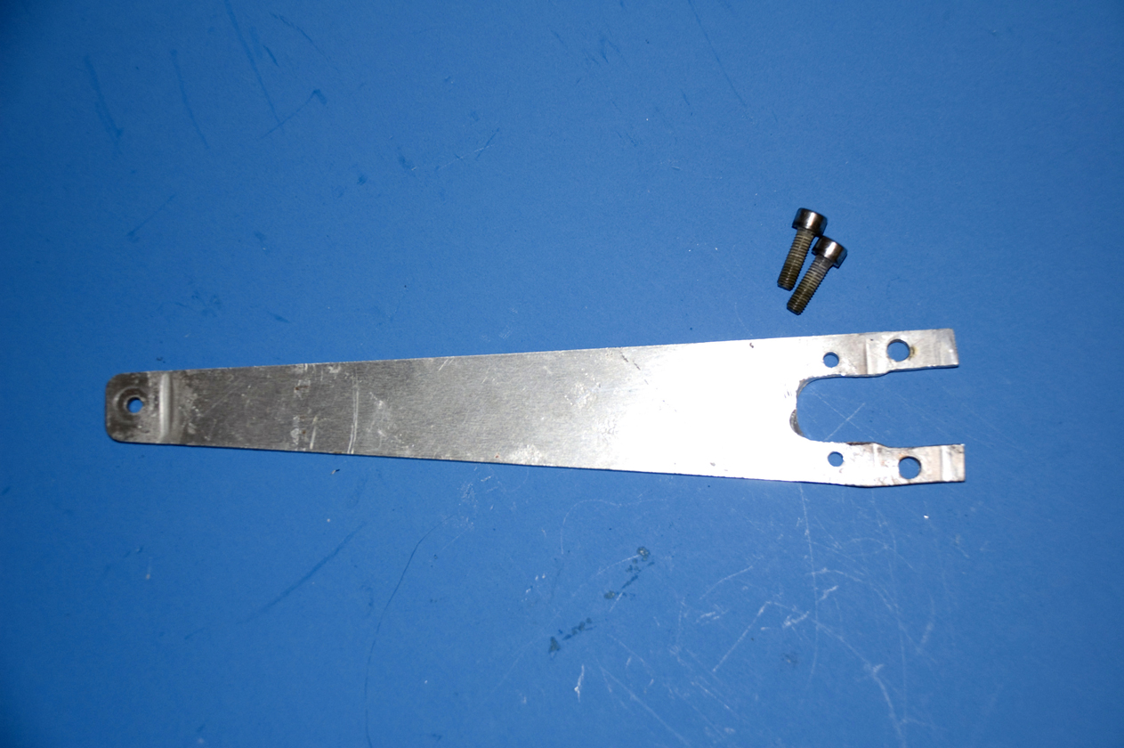

Got a big assist from my good buddy [MENTION=504]betoperez[/MENTION] today!
He made a special tool and swapped prop hubs on my super DLE 30 in about 5 minutes!

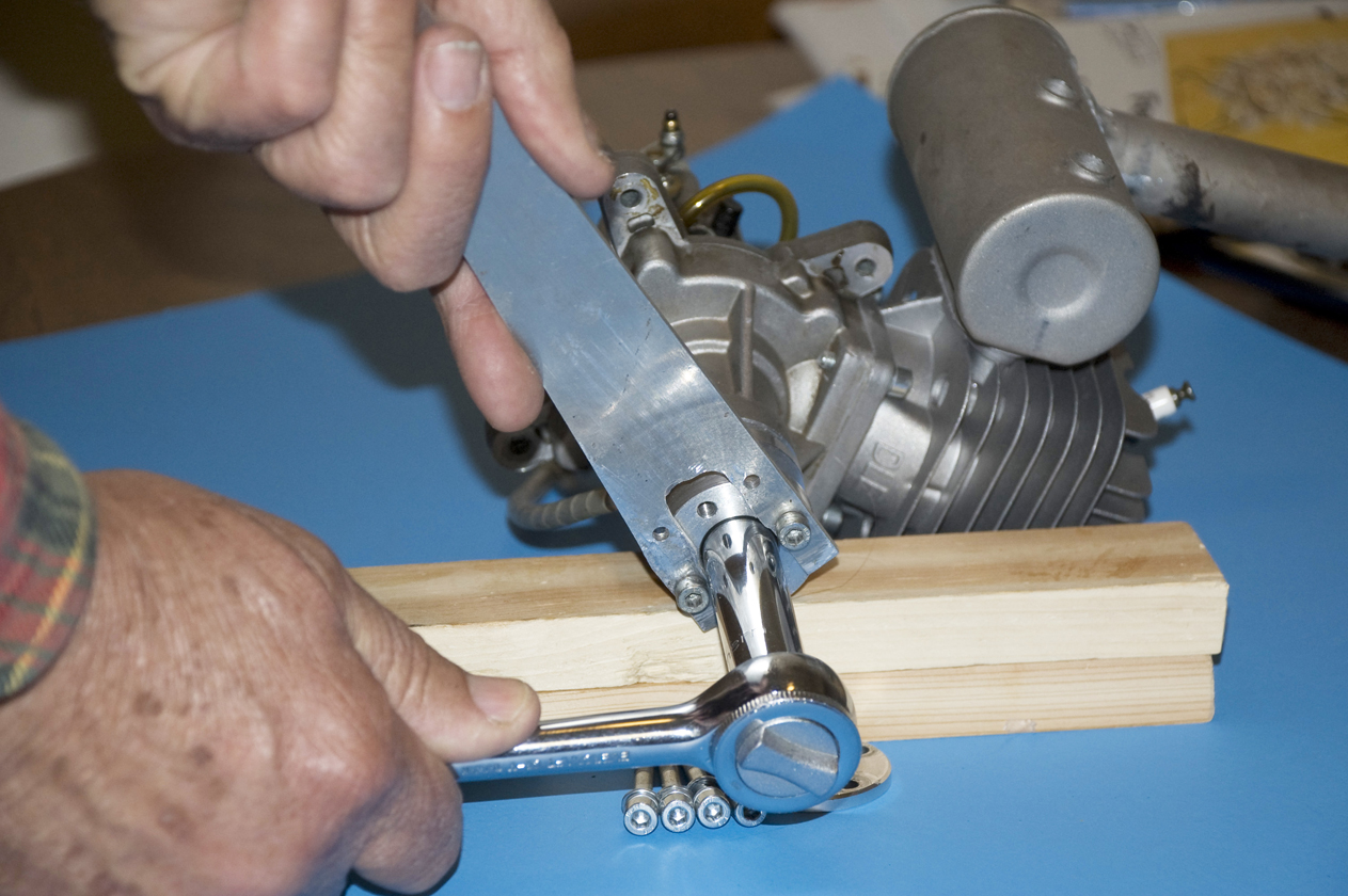

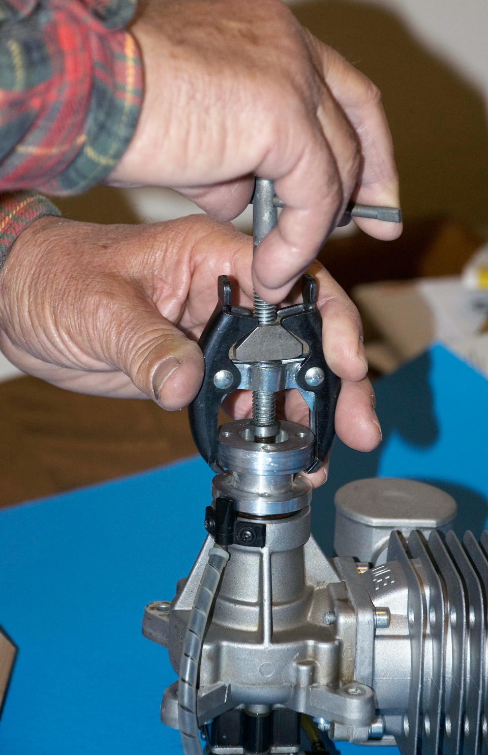

Some more pictures about removing the prop hub.
My tool works with the DLE 30 and 55.

Look at it and didn't like it. That is just me.
Just less hassle. The 30ccs don't need all the bolts. Does look nice but its under the spinner anyway. Nice tool thou.
The tool is not my idea, I can't remember where I saw it but it works great. My was made out of a broken landing gear leg.
