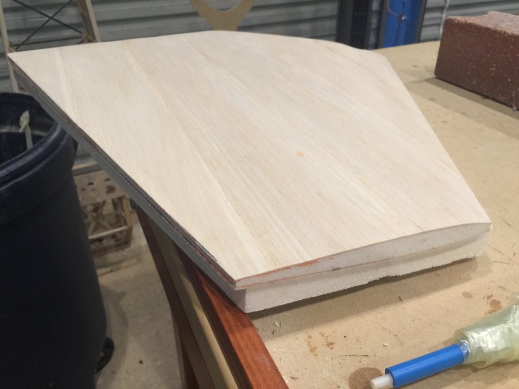

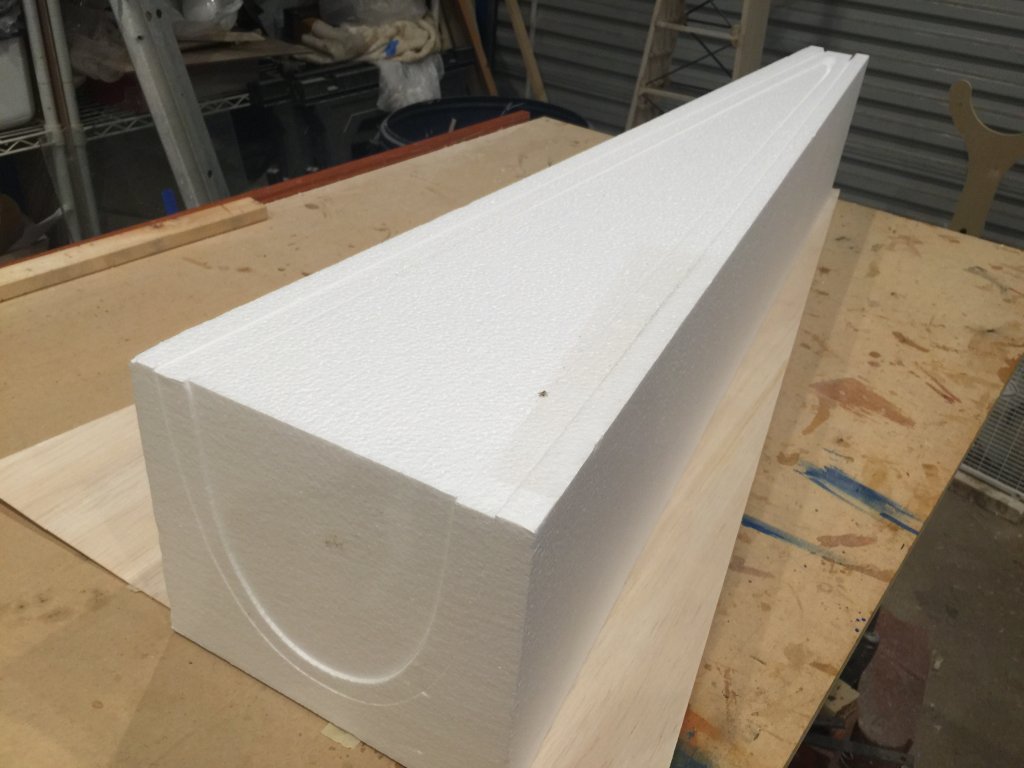

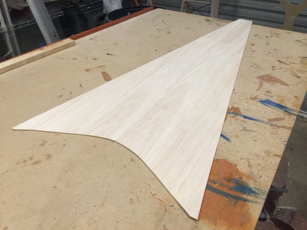

Here is the rudder/fin for #1
still needs some more sanding,and then cutting out the rudder, but, it is a start....

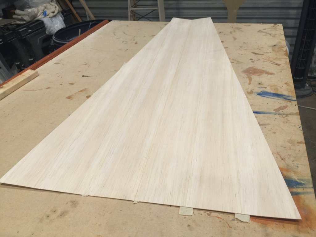

OK, got more done this morning...

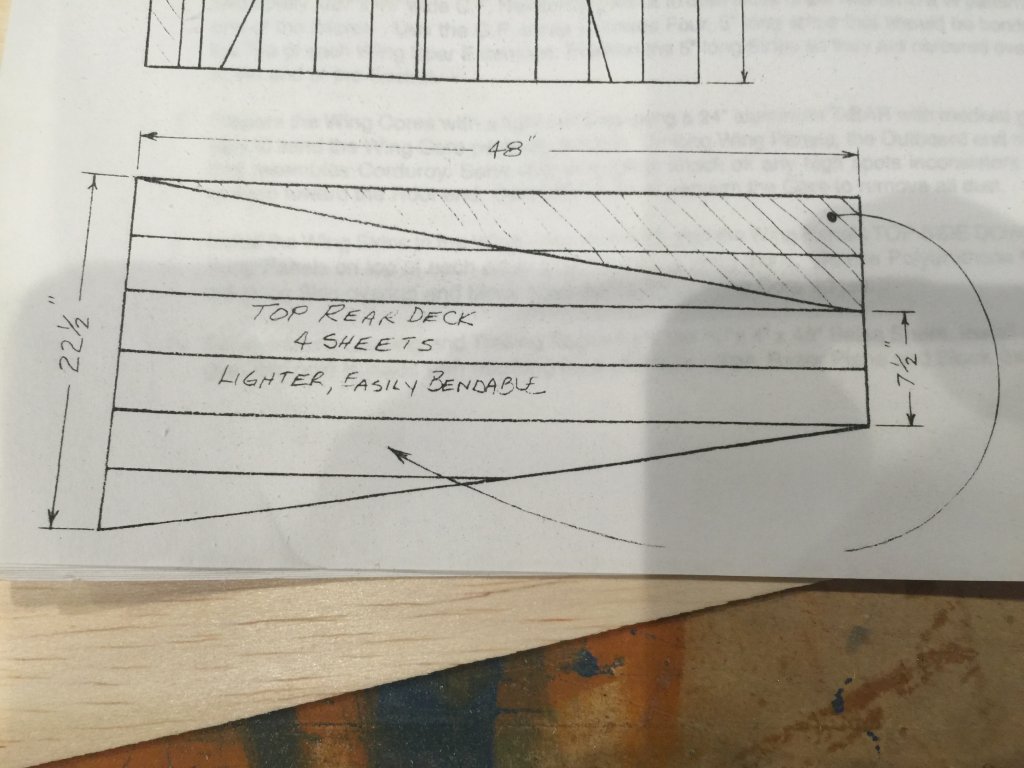

this is from the plans:
reason I am making a big deal about this, is, when I made the skins, the skin for the bottom rear deck, is slightly different dimension, but, you do not want to confuse the two. The key is that the turtle-deck is 7.5" at the rear aspect. Just an FYI.
Also, he refers to this as the top rear deck, whereas I have always called it a turtle deck, so my bad.

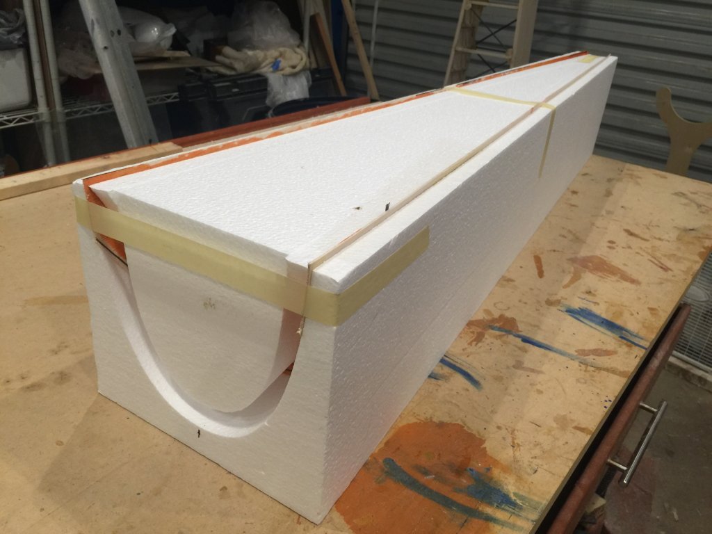

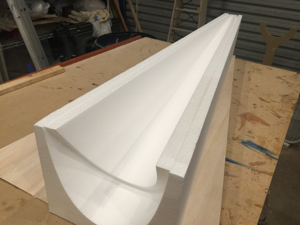

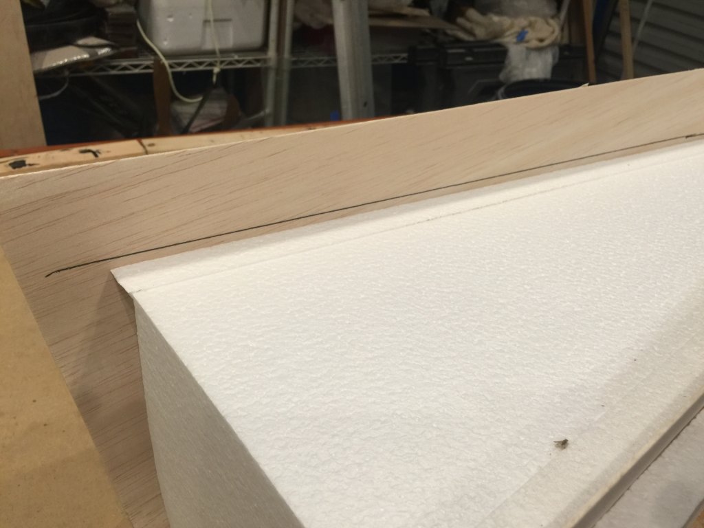

this is the rear top deck, which I had not inspected before....
this is what I found when I removed the shuck inner piece. AN extra piece?? Well, discard that....
after removal of that one extra piece, not to be incorporated in the top rear deck....

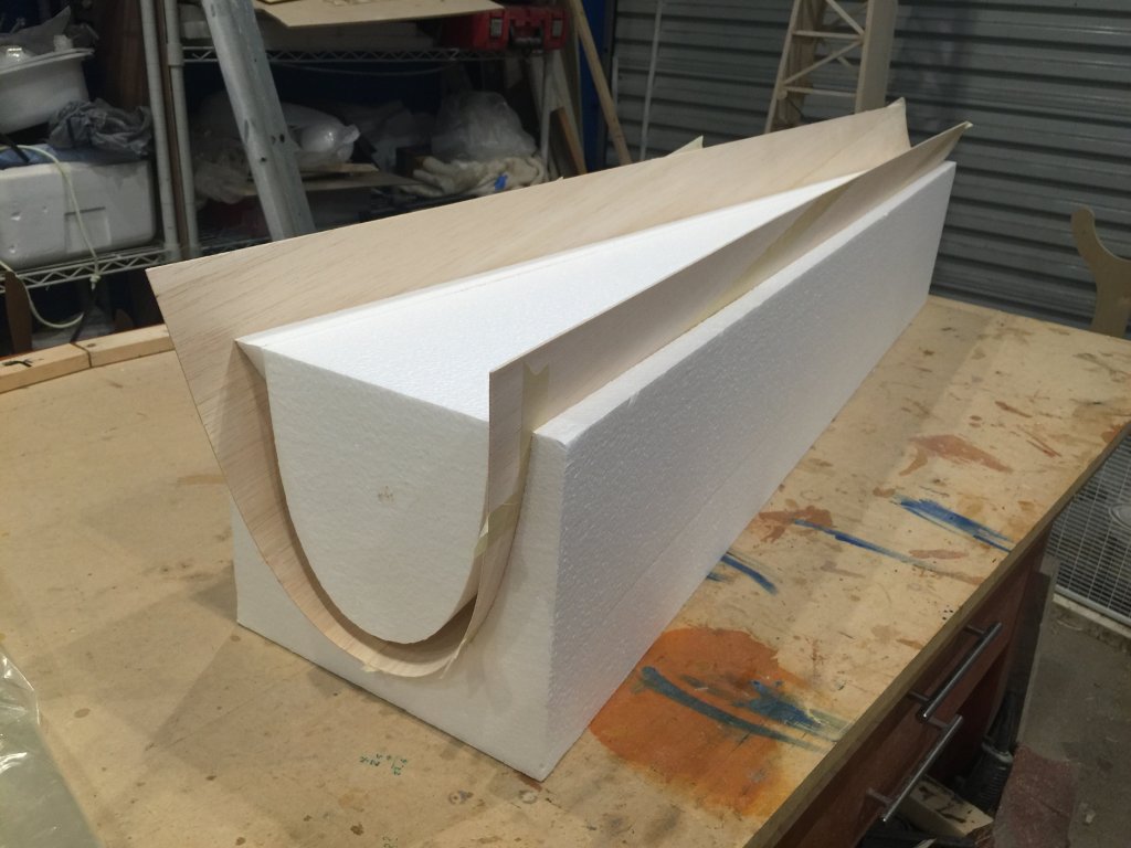

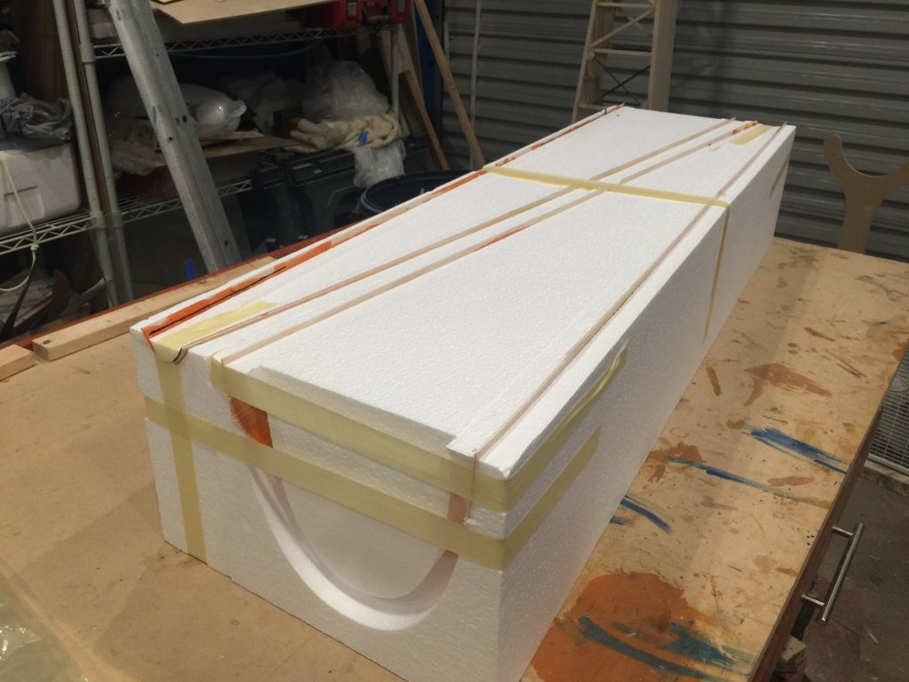

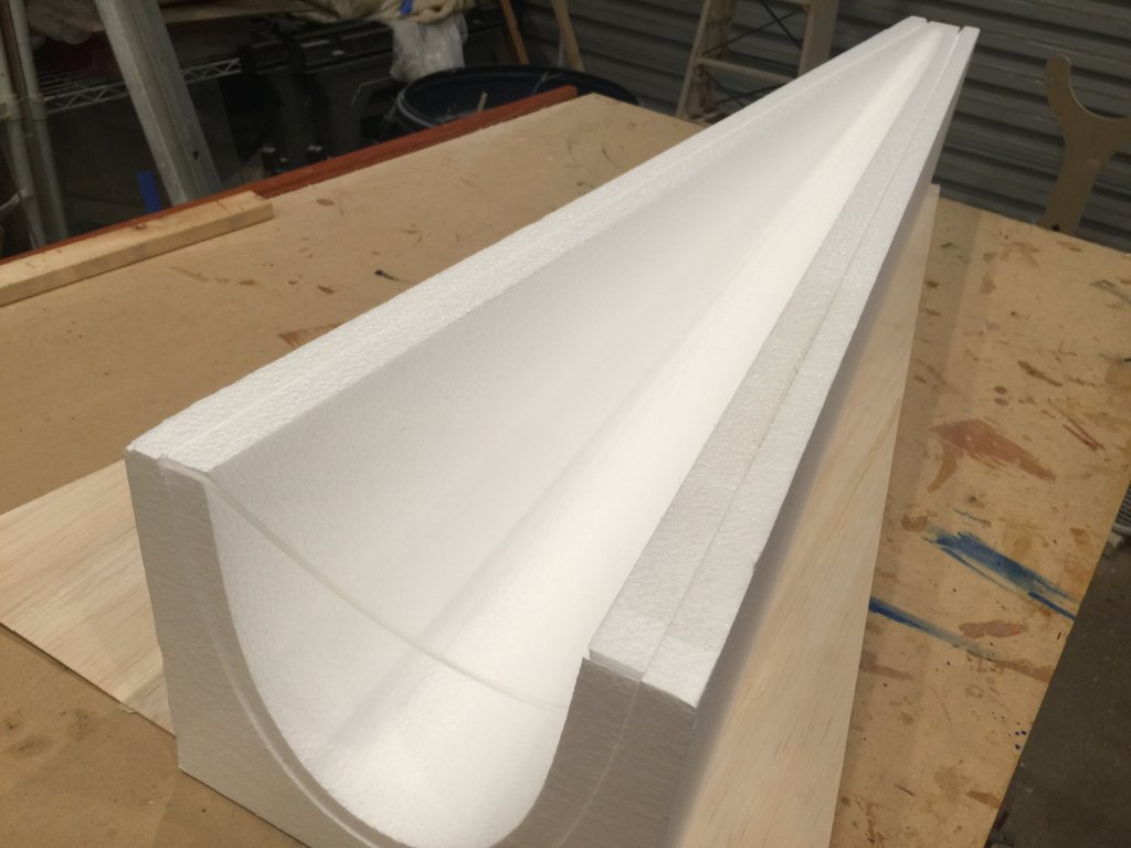

trial fitting of the skin with the deck, in the shuck...

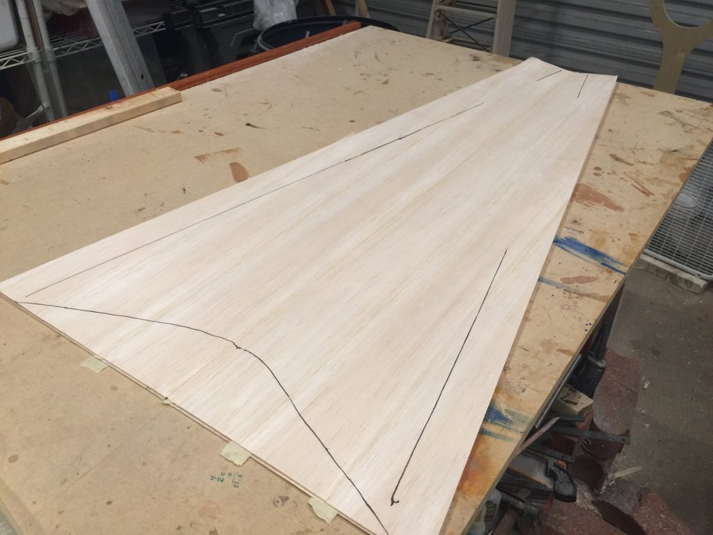

now I can mark it.... (trim time now)
black sharpie, and off to cut....

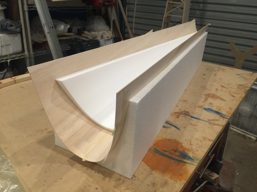

here is the area that needs to be trimmed. I am doing #1 and #2 at one time....
here it is after trimming...

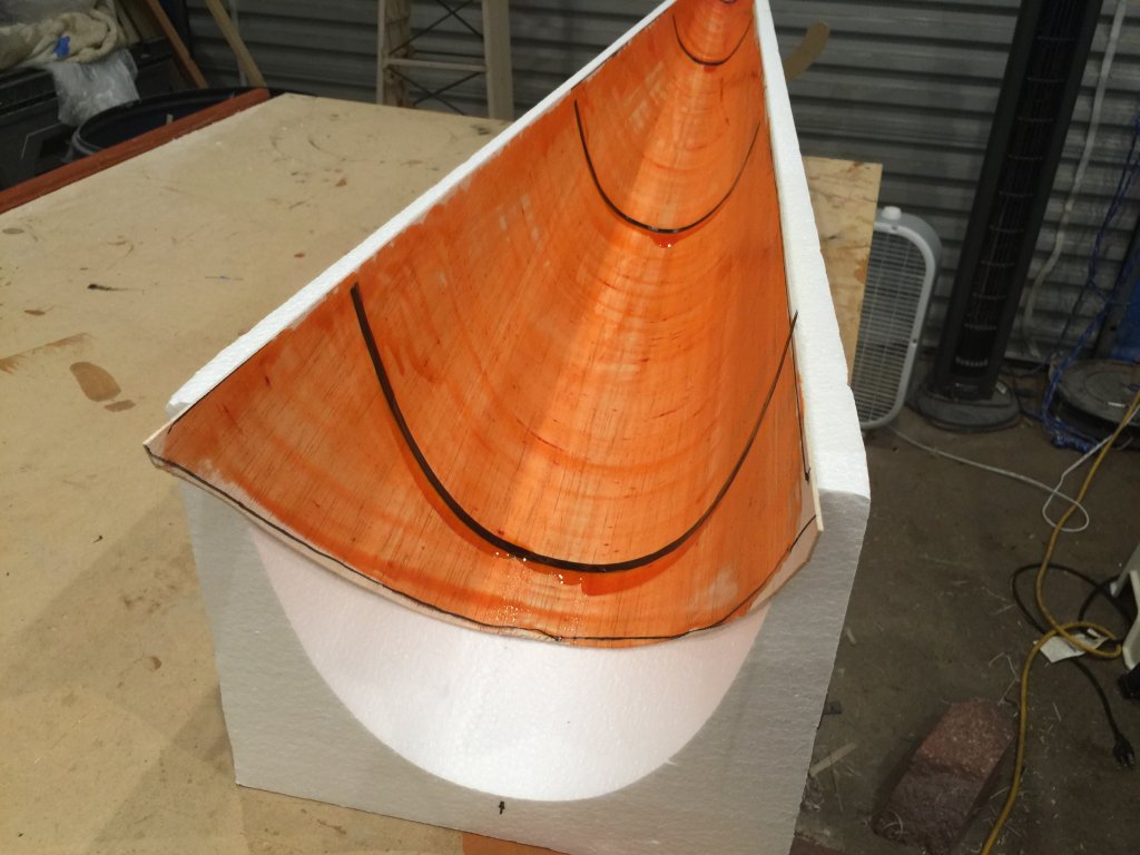

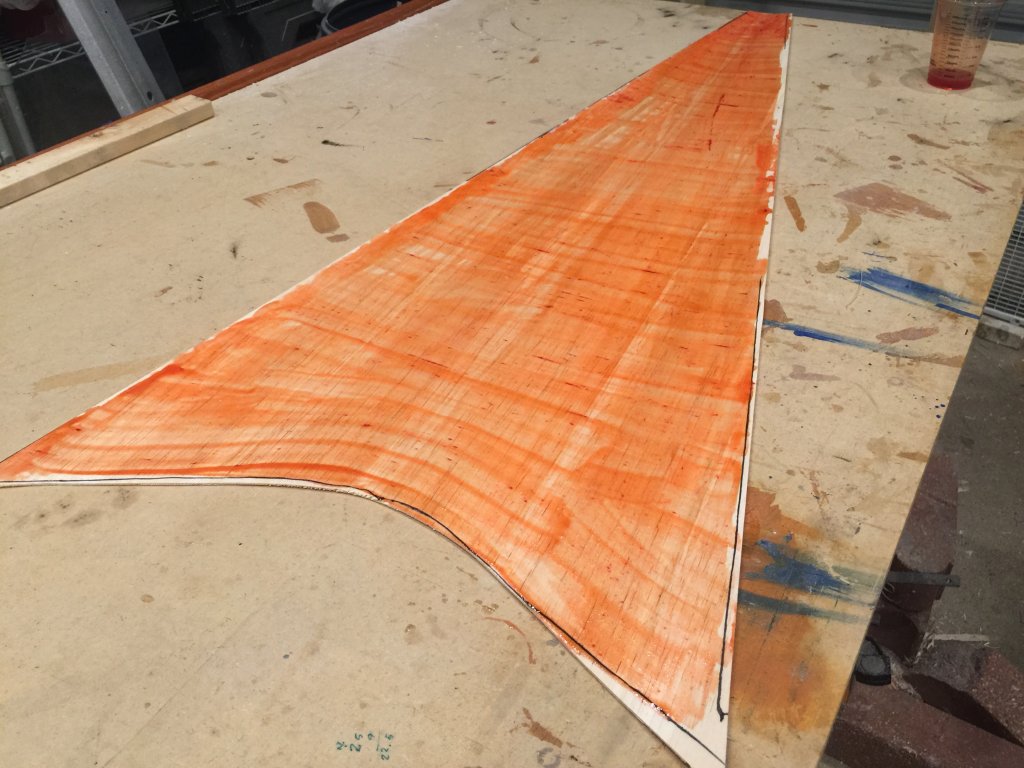

after applying the West System epoxy resin....
they are now both in the vacuum bag. I will check back when I return from work, which will be at 5:30 pm.
