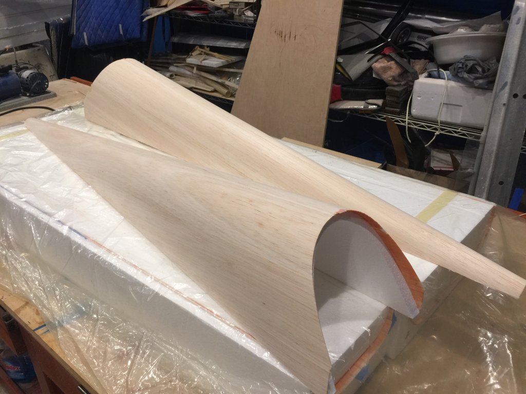

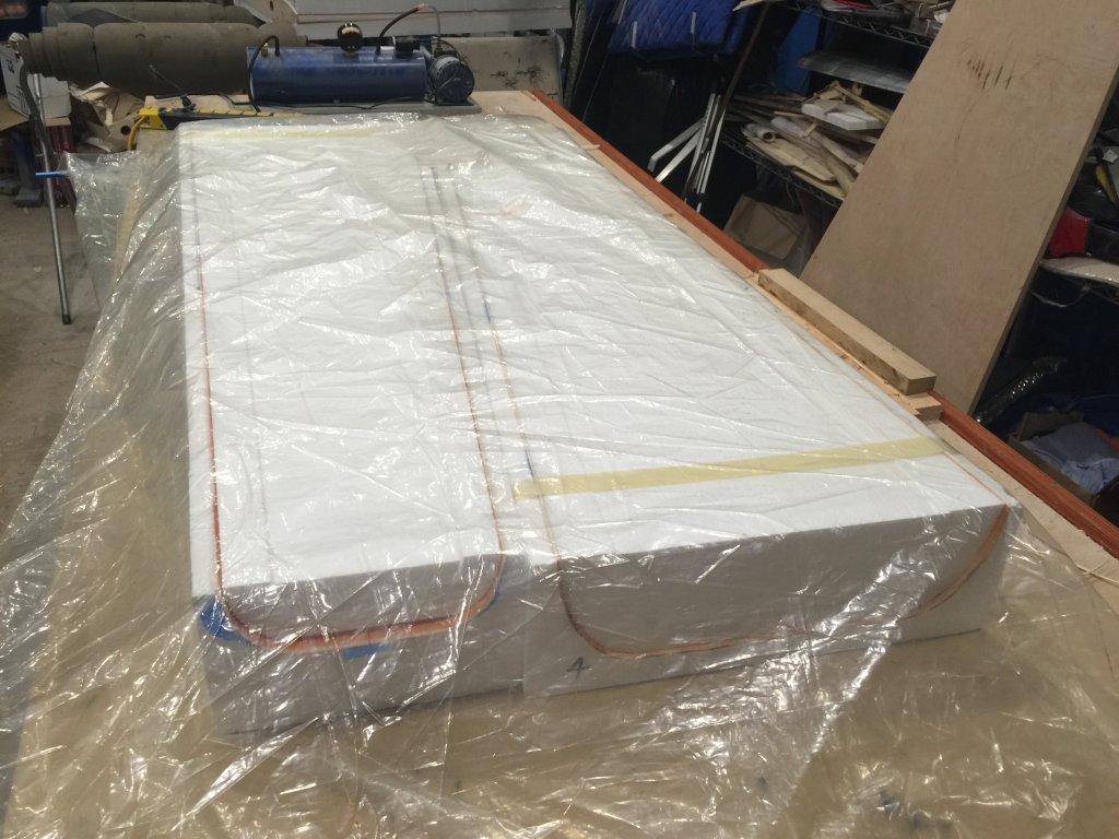

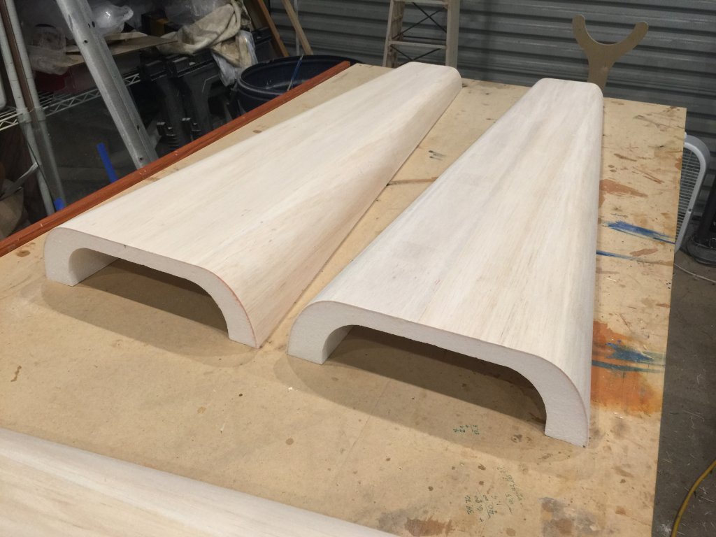

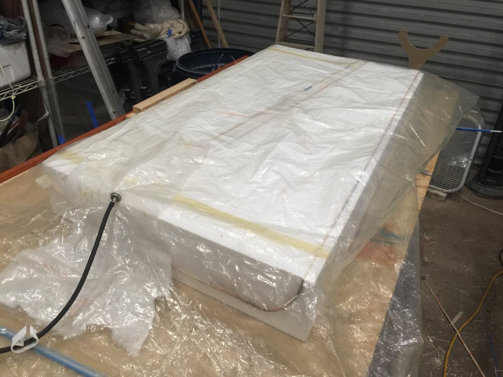

the bottom front deck pans are sheeted and trimmed.
came out really good. I am proud of myself. Well, it almost feels like I am cheating, using this bag technique. I have learned more advantages of using the vacuum bag technique and epoxy resin. Another advantage is, that when You apply the resin, then move it to the shuck, the resin kind of softens the balsa sheeting, and thus, makes it more compliant to the new shape and curvature of the shuck. Not once, has the balsa sheeting torn or pulled apart.

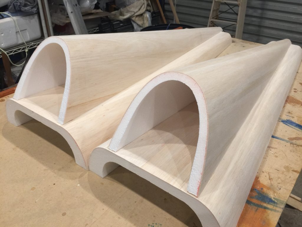

I was also able to finish trimming the turtle decks (top rear deck)...
