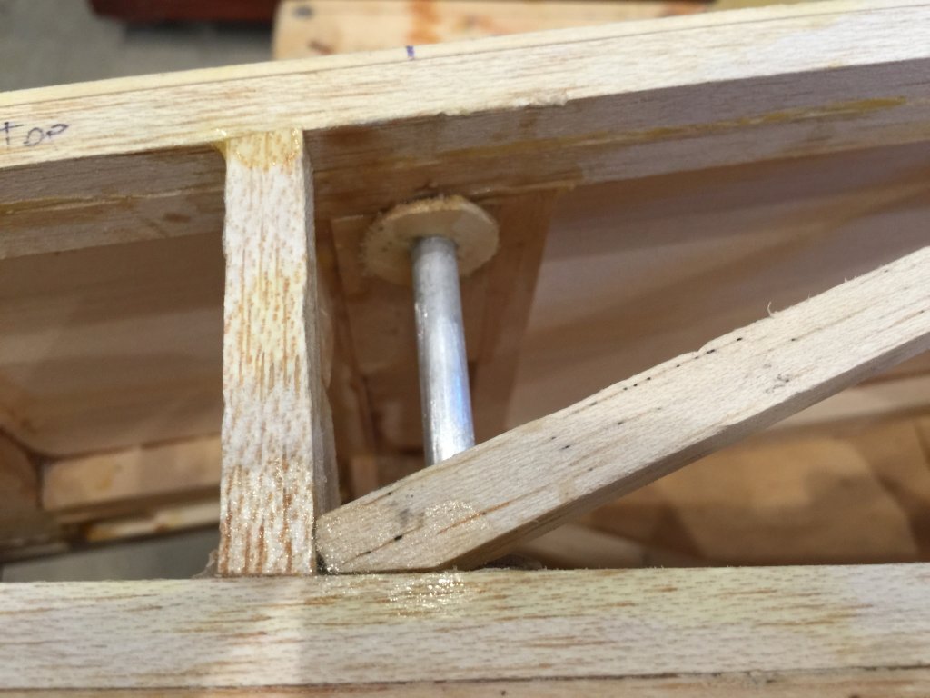

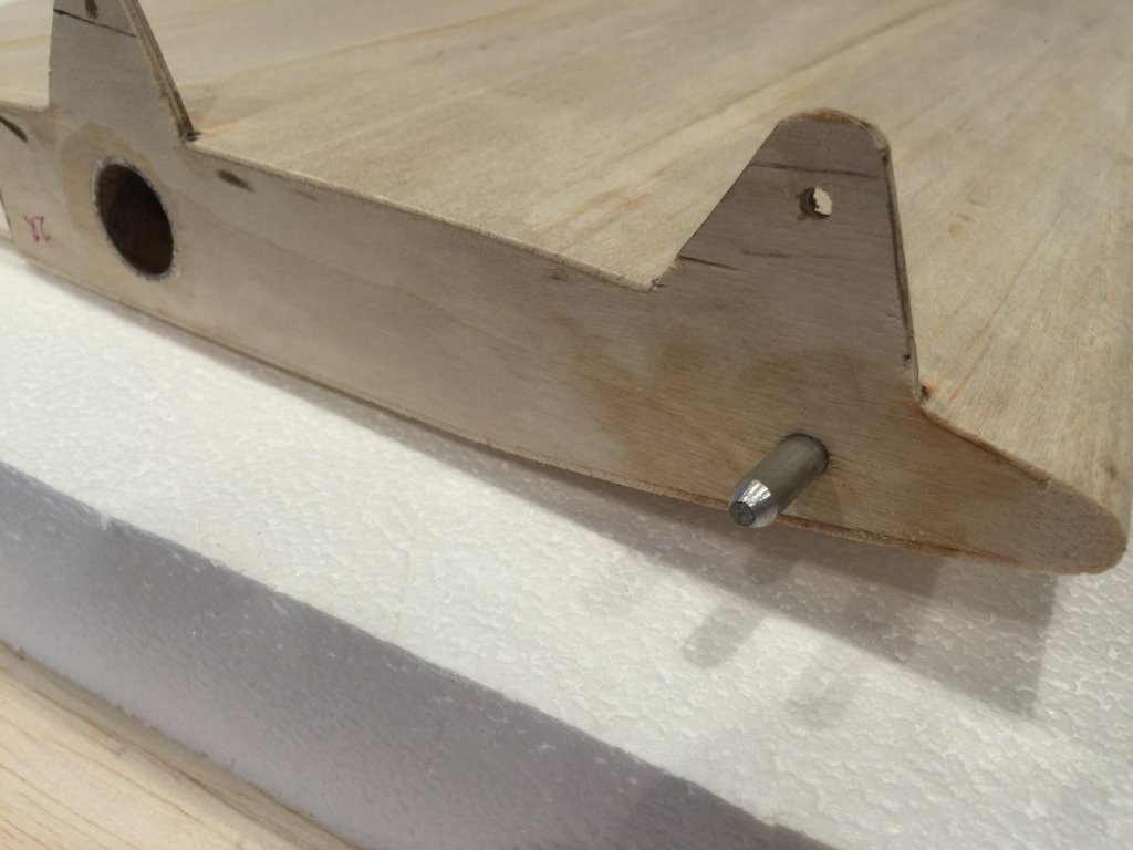

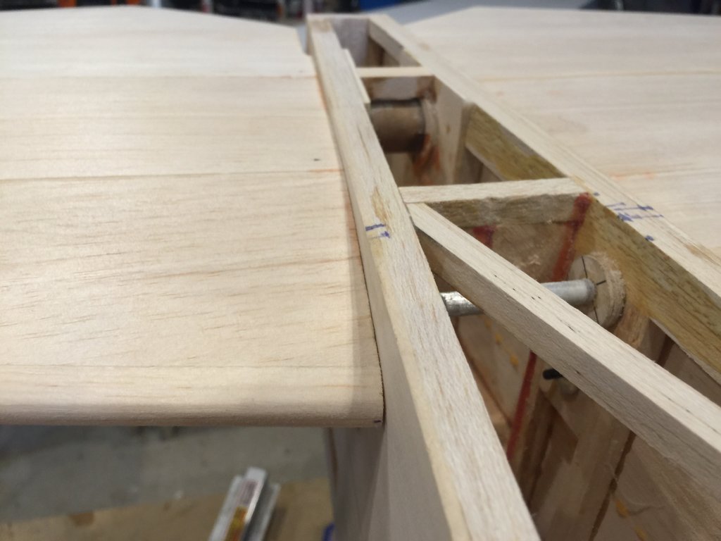

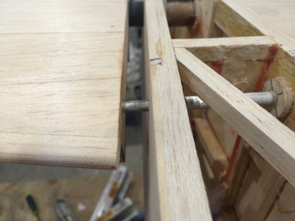

Can you elaborate more on the incidence set up? meaning the aluminum bar. Thanks buddy.
Hello Primo,
When you pass the tube thru the tail, this has to be parallel to the stab tube in both planes. If not, then it will not slide in and out, due to binding. I am using the aluminum rod, thru the tube, to make sure it cures in a position that is parallel.
Here it is in action...

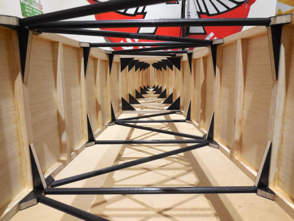

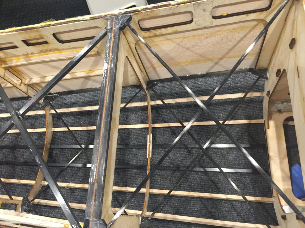

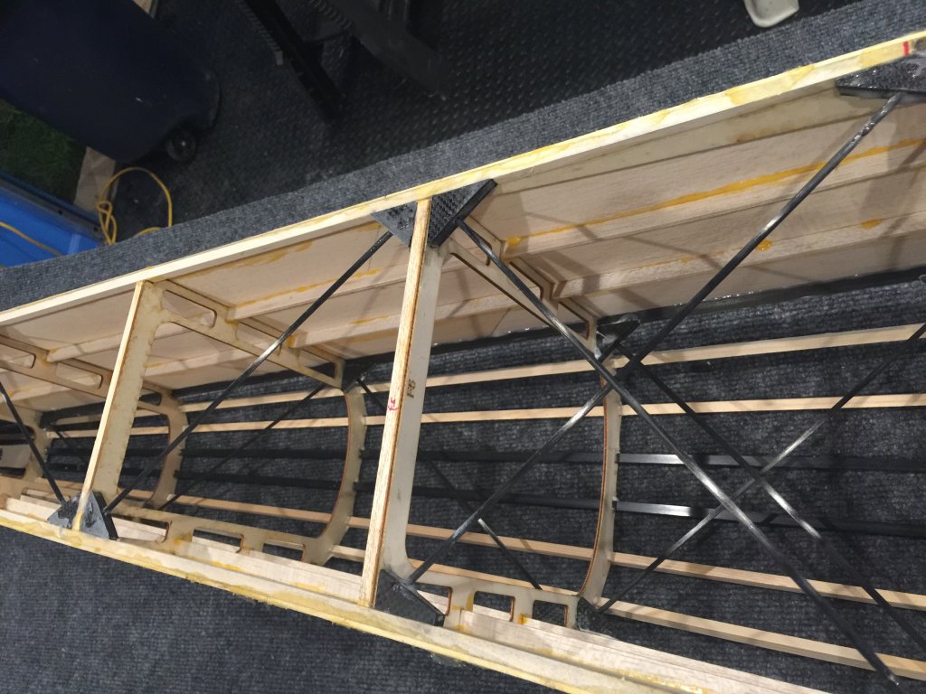

Cam,
Just me thinking out loud here. Could a person replace the diagonal bracing with cf rod and save some weight? I have thought of building and just want to ask the questions before I decide what to build :)
Alky6
Cam,
FWIW, I was reading through Greg Marsden's build and he used 2mm carbon rod diagonal bracing in tension throughout. Pretty eloquent but looks like a ton of work!
Cam,
I do not know if CF would be lighter. All of the cross braces are balsa. very light. On FG, there is a CARDEN Build thread, and the builder, used an extensive amount of CF, and his airplane came out quite heavy.

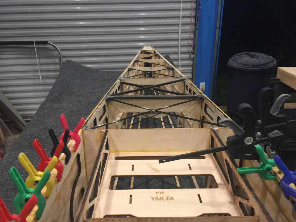

I just remembered, I built this Yak, also with an extensive amount of carbon fiber, airplane is bullet proof, but weighs 46 pounds.
And yes, you are right, a ton of work...
she flies nice though ;)
