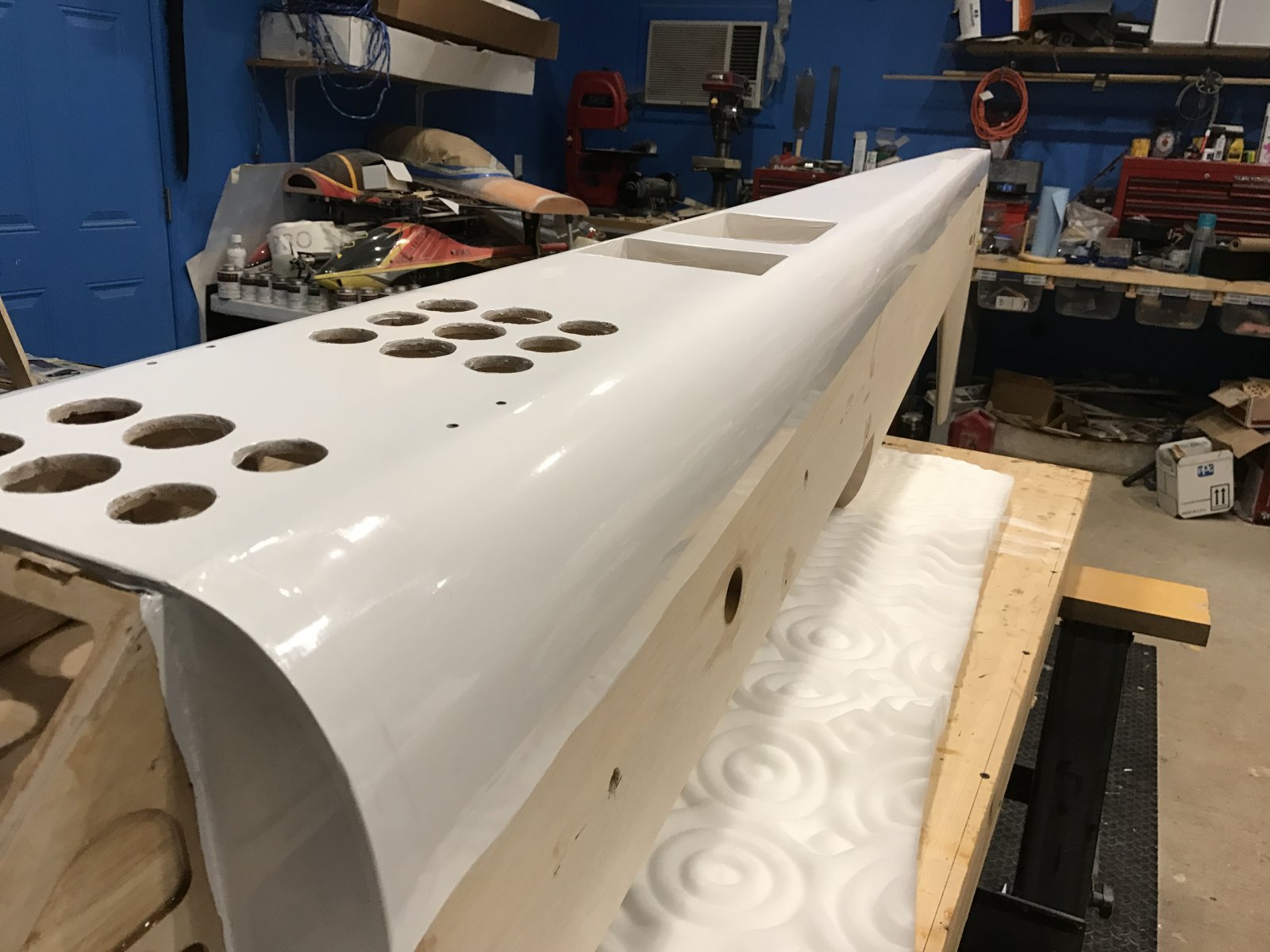

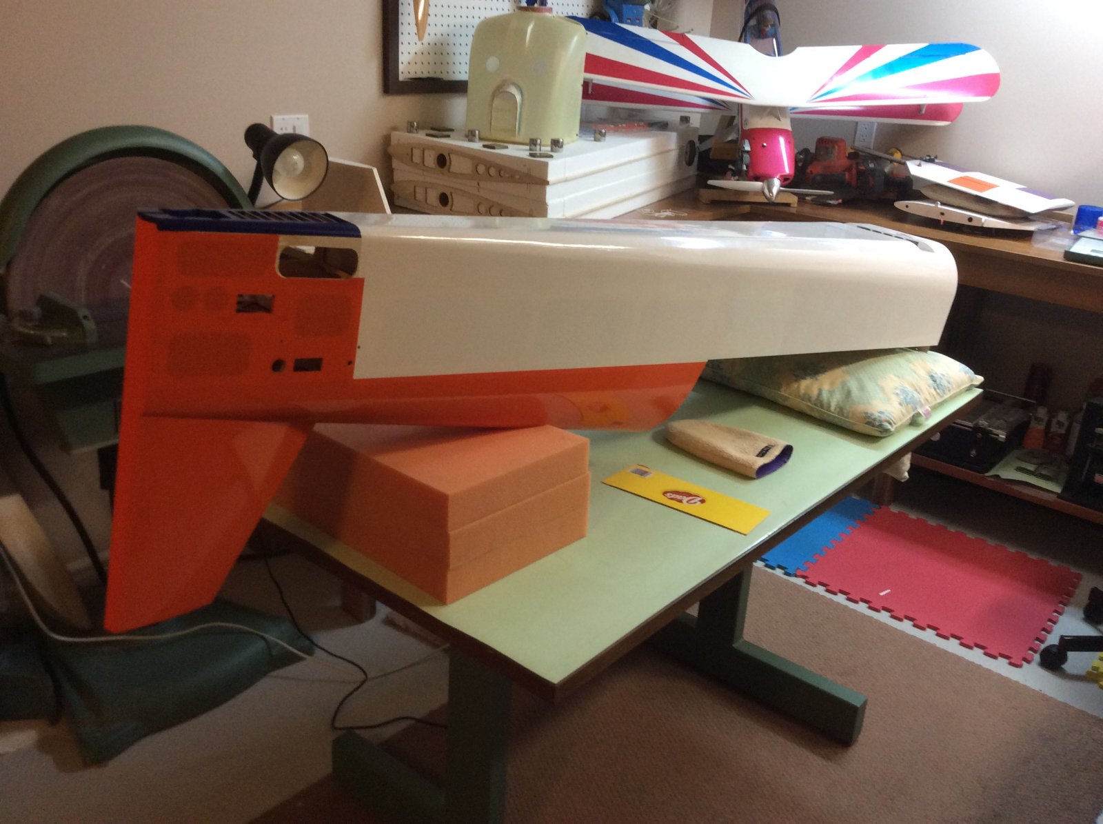

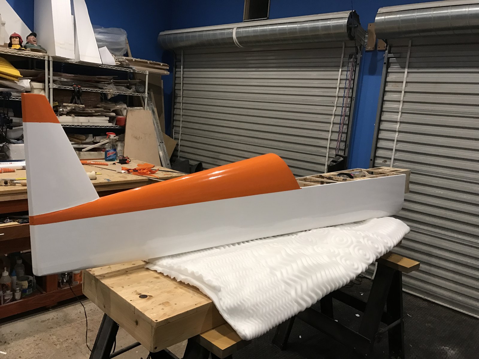

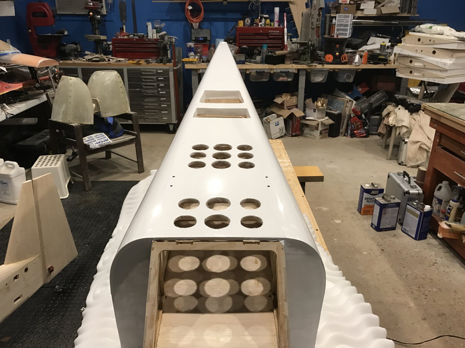

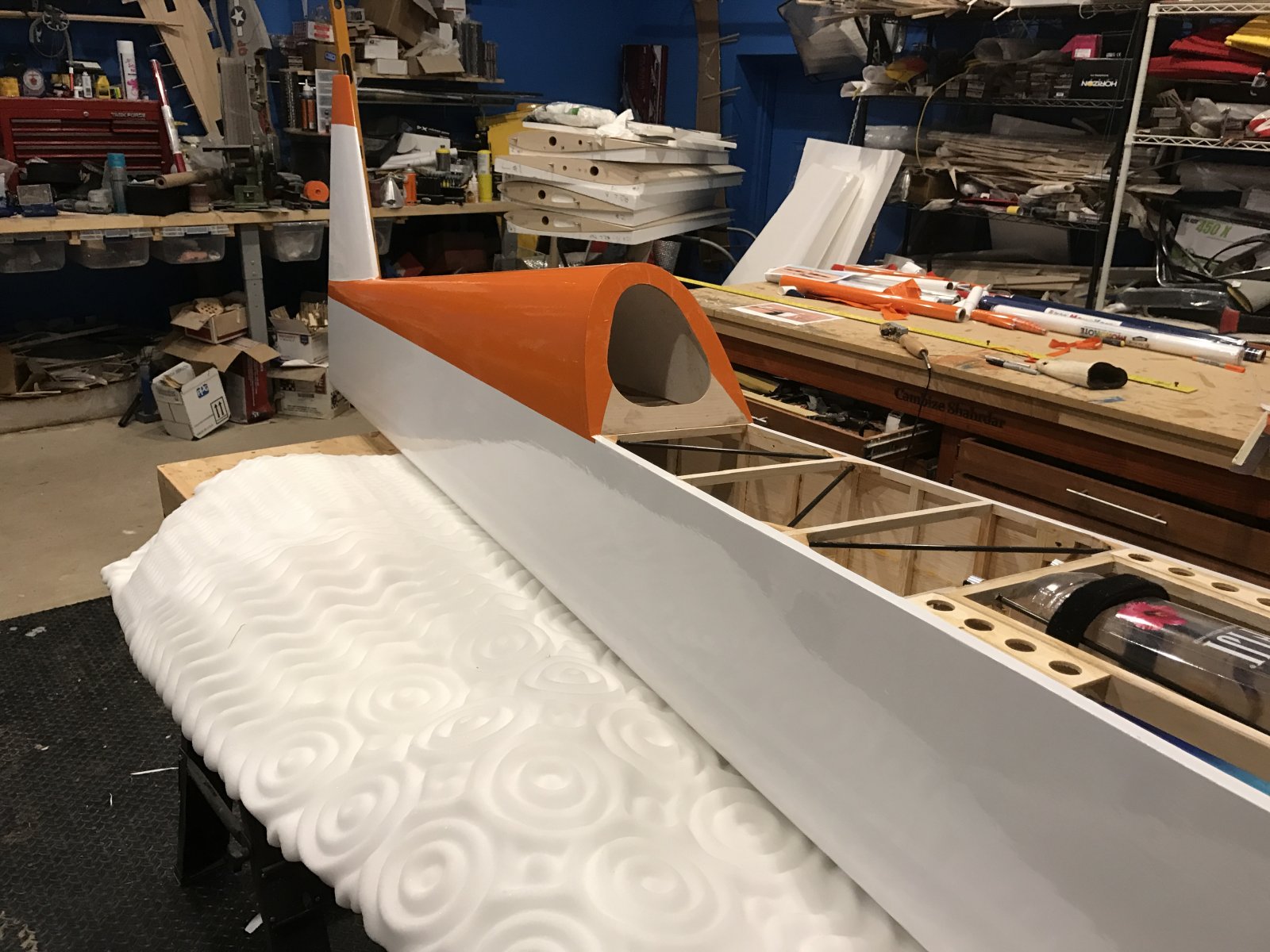

My wife gave me the green light. I told her, what I want for Christmas is the opportunity to finish covering these two airplane! She said: "DONE!!" What a wife, I tell you! Used a lot of tricks learning from @Mark Boguszewski. The trick with the mineral spirits is amazing. WOW, that really helps remove the last of the balsa dust. I first used an air compressor, then a tack cloth, and then a clean cloth with mineral spirits. Thanks Mark!!!
View attachment 92238 View attachment 92239
One question did you Run the Ultracoat down into the round holes or cut it flush with bottom if you did, did you do anything special to stick around the edges.
Yes, this is a good question. This is something I learned on my own, purely by accident. This is a problem, and I learned to use an old soldering iron, and poke into the hole, and use the side of the iron, to melt the covering onto the side of the hole. This seals it, and no worries of the covering coming undone. Has worked on the the airplanes I have covered doing this, and not once, has the covering come undone in these areas after hundreds of flights.
