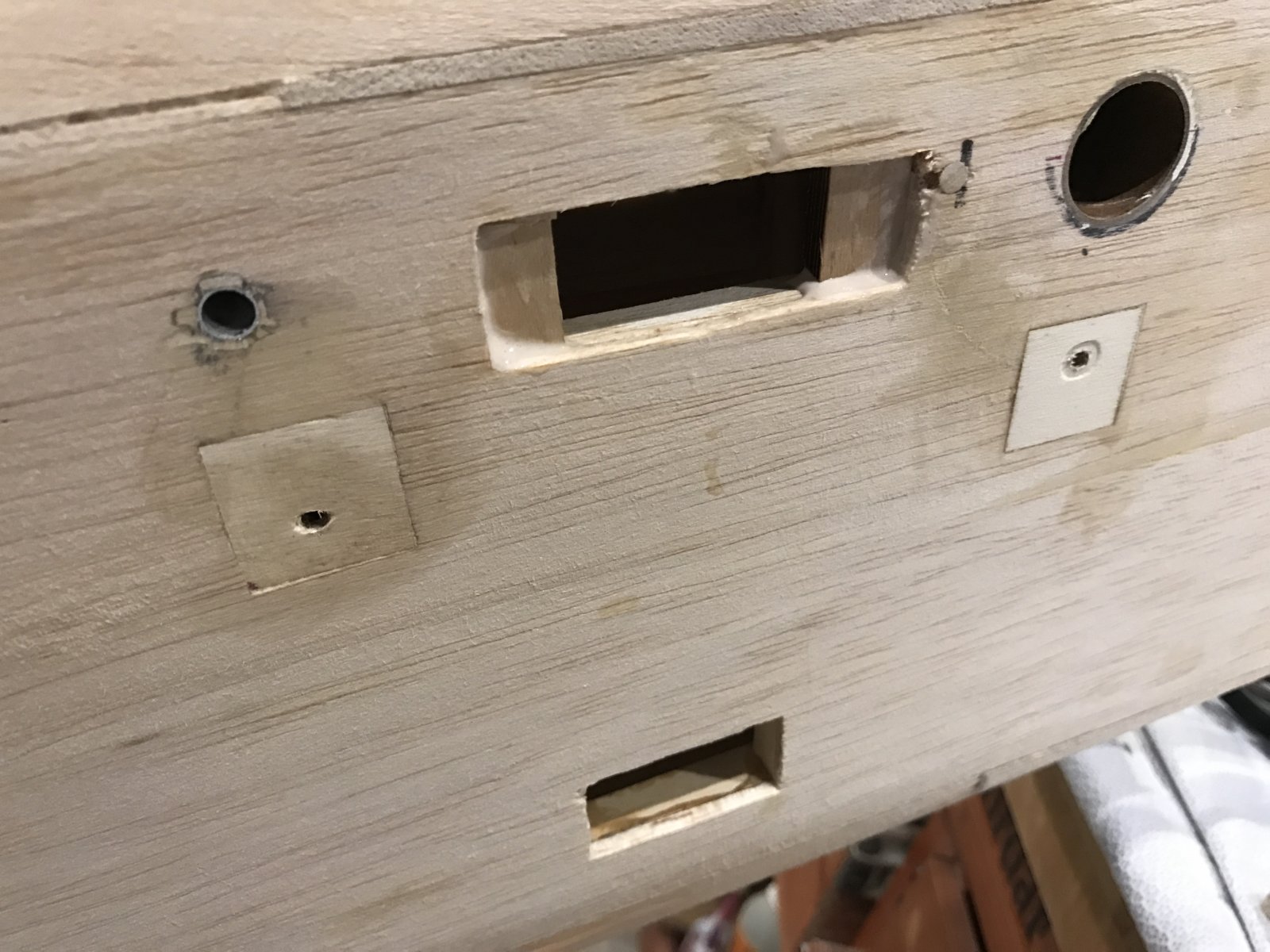

I am doing something to make it easier to remove the stabs and not lose the servo extension inside the fuselage.
I first installed these plywood blocks in the opening by the tail of the airplane. this hole is covered by the root of the stabs.
I will then make a lid, that screws on to the plywood blocks, with one screw, on each side. once the airplane is covered, then I can install the lid, which has a rectangular hole cut out, to screw on this MPX socket. SO, i just plug in the MPX into the fuselage, and do not have to worry about losing the extension in the fuselage.

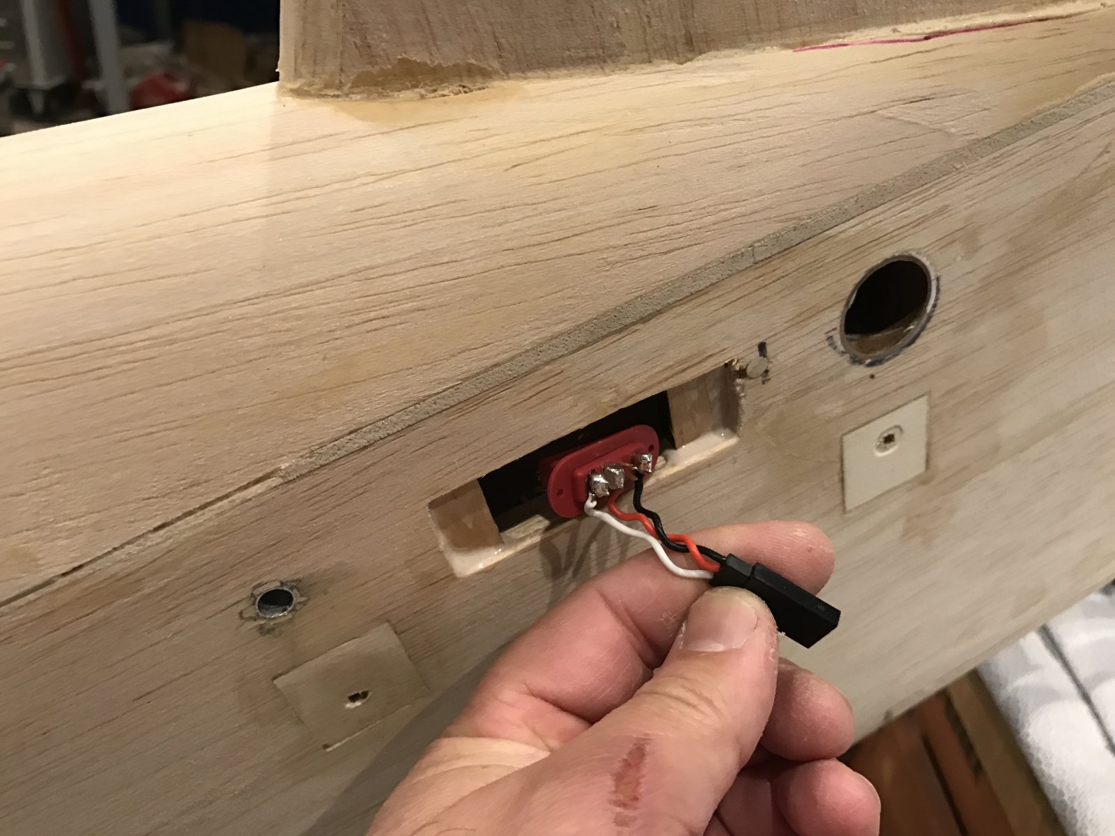

Still need to make the lid, just so you all can see the position of the plug, and my left thumb, after I burned it 2 weeks ago with the iron, as I was covering the stabs. (OUCH)
Rusty 73
Ouch to your thumb you have been applying vitiam E to help the scare tissue heal .
Those wing plugs are a good idea like the soldiering .

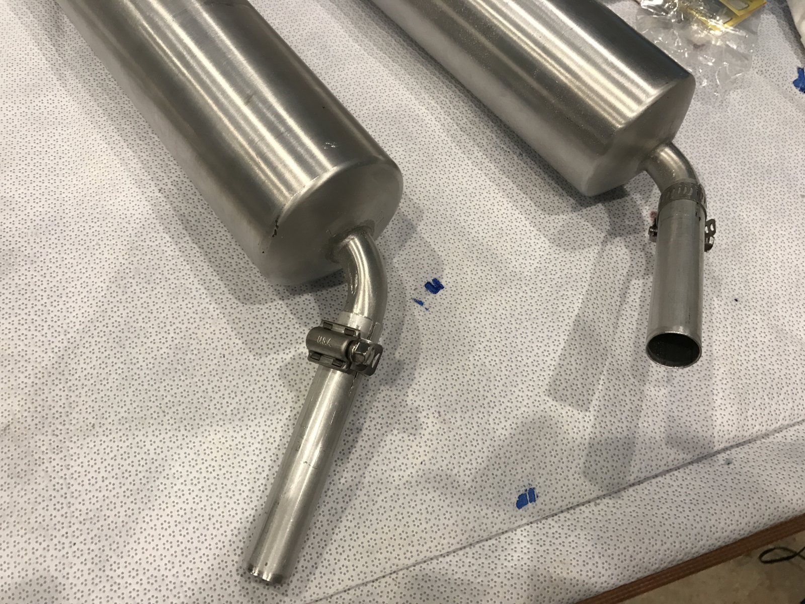

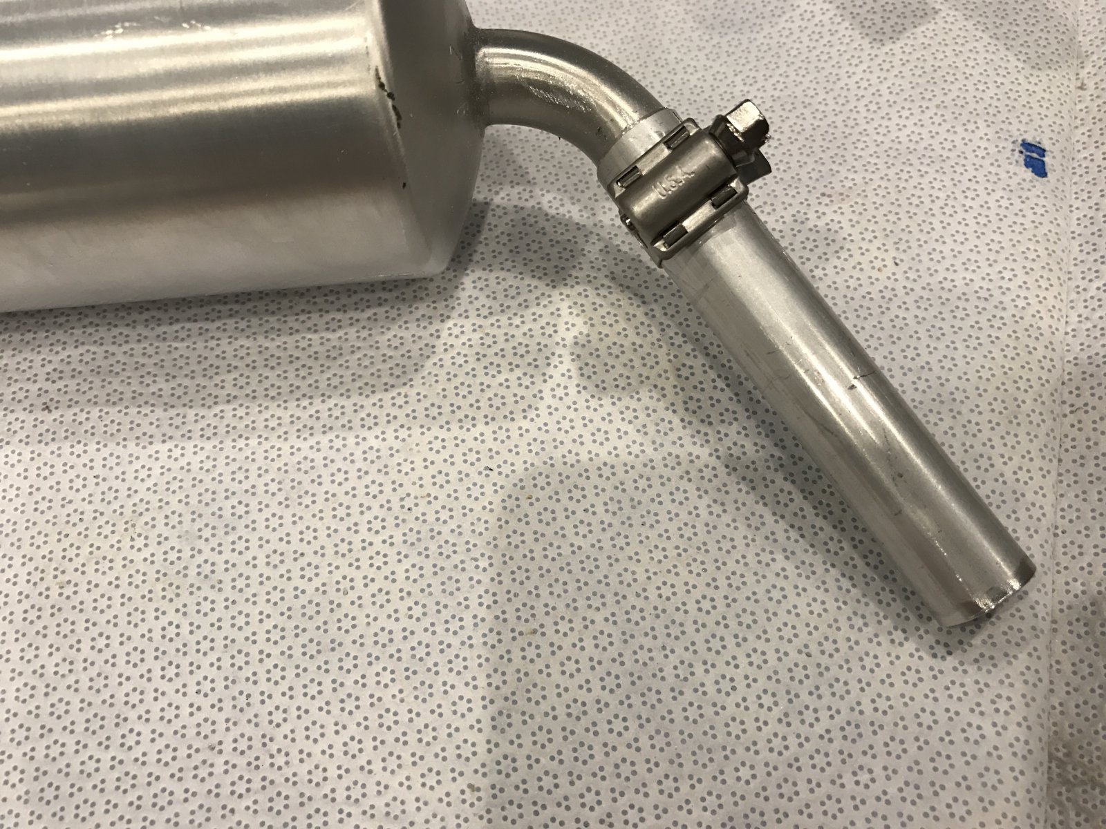

Finally was able to make my stinger extensions for the KS 1090 tuned pipes. These are thin walled aluminum. got them McMaster Carr. the stinger is 18 mm OD. I was able to find something that was almost 18 MM ID.
View attachment 92195 View attachment 92196
Those clamps will do the trick , maybe so high temp loctite between the wall will help the clamps keeping it tight .
That must have been painful. Done it my self once the worst one when I once grabbed a soldering iron that was falling of the workbench. Will not do that again.

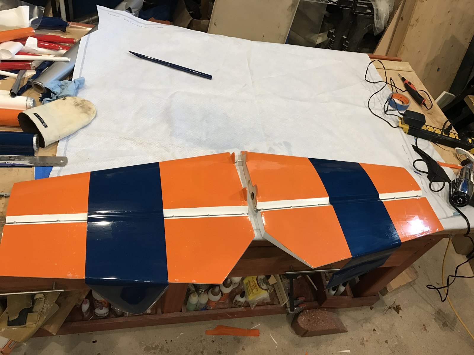

Just finished covering the 2nd set of stabs. I am using the Tom Wheeler trick to adhere the Insignia Blue to the orange, using Ammonia into a Windex Bottle.
Once this dries, then I can cut off the excess and then do the stripes on the top.

Not sure the method for ultracote but for monocote you can spray it down with windex (that has ammonia in it) and place your top piece of covering over it. Get it in the right place and squeegee it out. Let it dry overnight then you can go over it lightly with the iron to seal it all down. The ammonia activates the adhesive in monocote.
