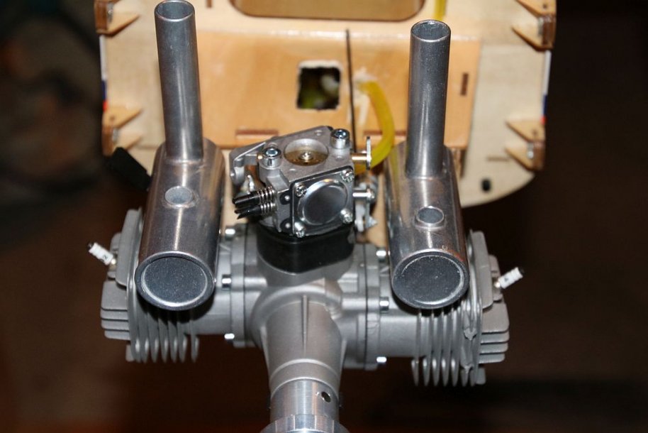

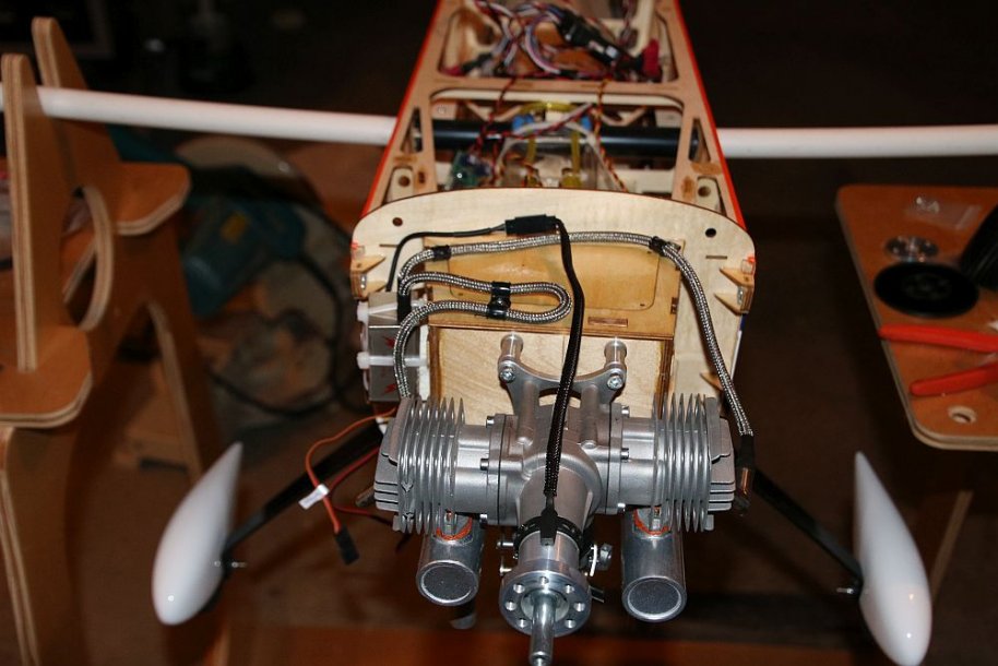

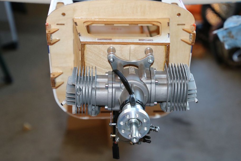

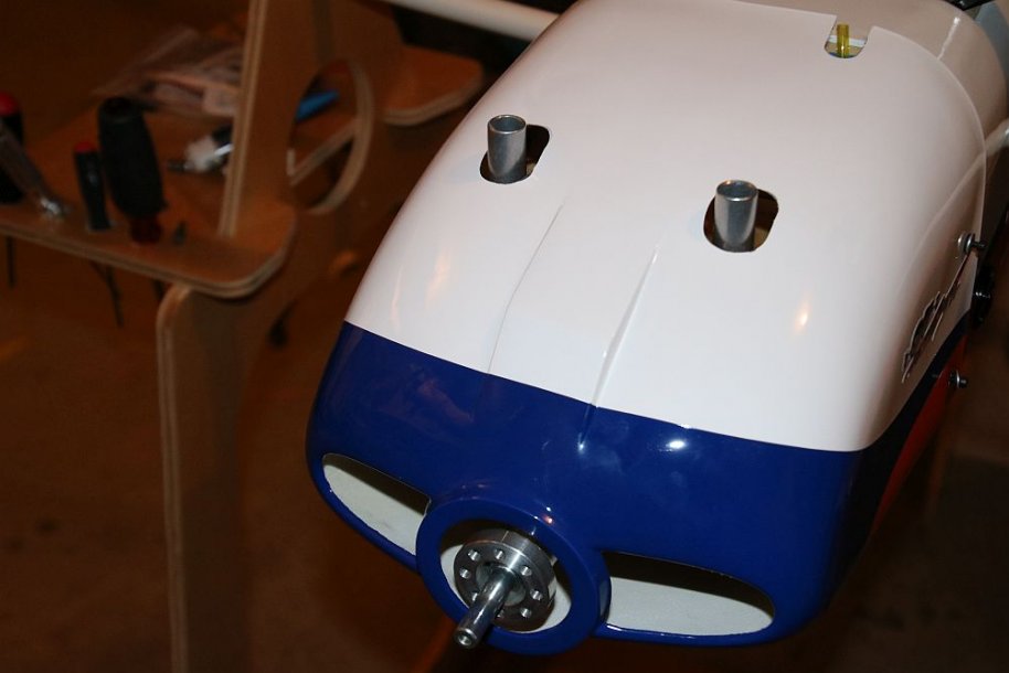

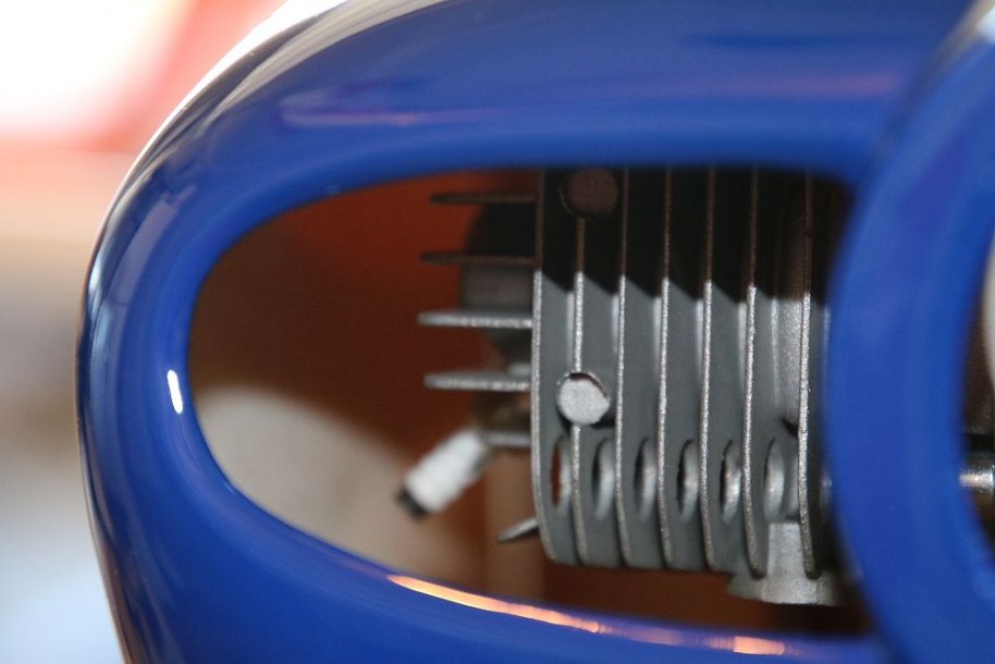

Here is the engine I am putting in. Should be enough power. Kind of hard to see, but there is plenty of room in the cowl to fit without cutting a hole for the plug.

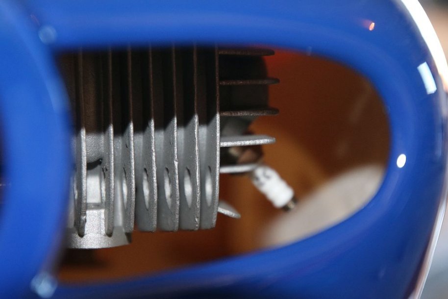

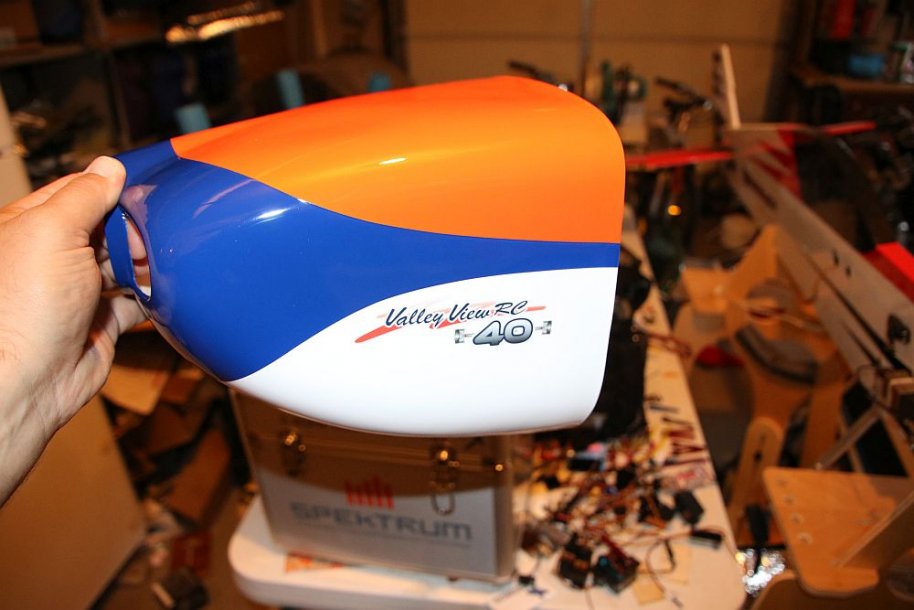

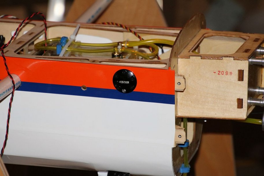

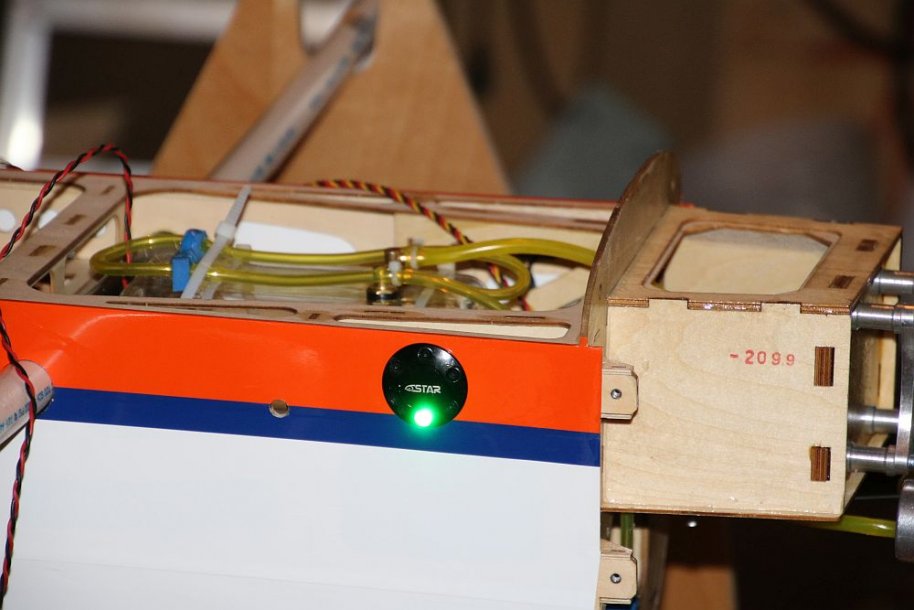

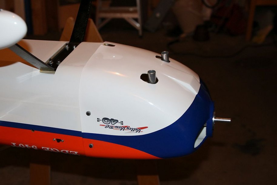

I did this with my kill switch light on my last build and liked it so much I thought I would do it here also. It works great and is nice and clean.

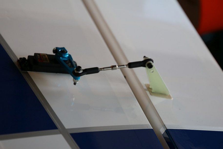

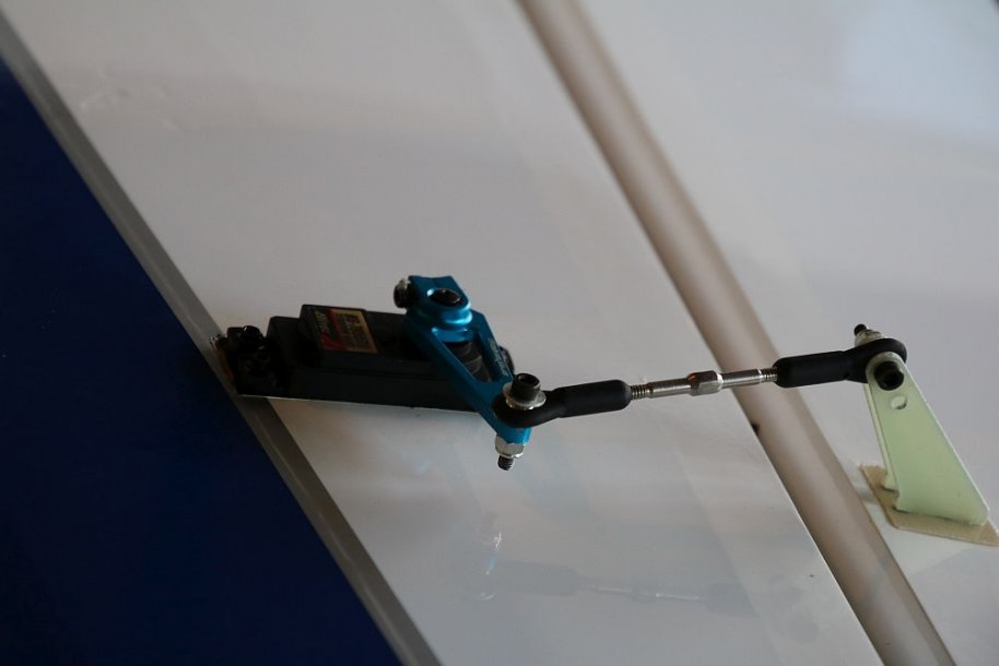

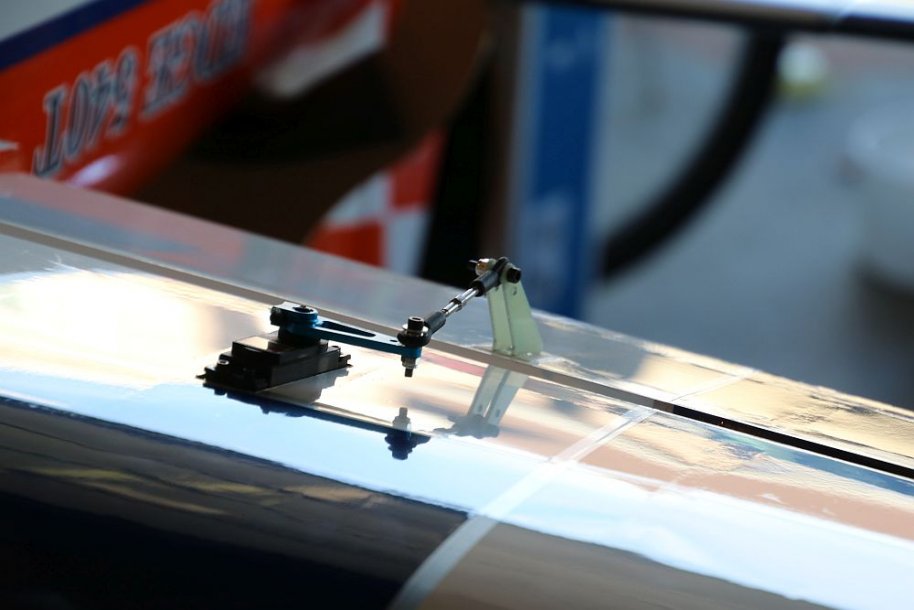

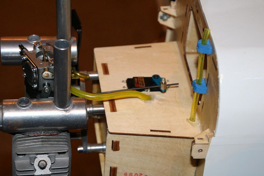

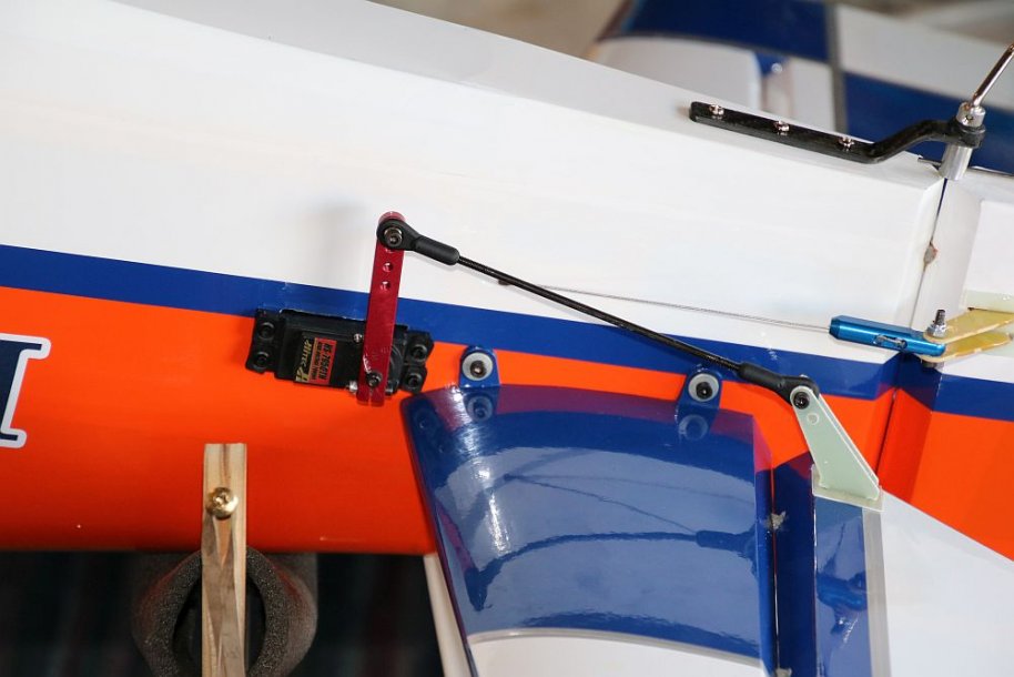

Had to get a little creative with the throttle servo install.
Hey you're going to love that little twin! I got one that's running like a top. Did you carve a bit out of the carb spacer/reed block to get the throttle linkage to clear? It's way to tight in there to get a decent ball joint and screw through the arm.
ericb
Team WTFO
I did have to do that. Glad I wasn't the only one who had to do that.
