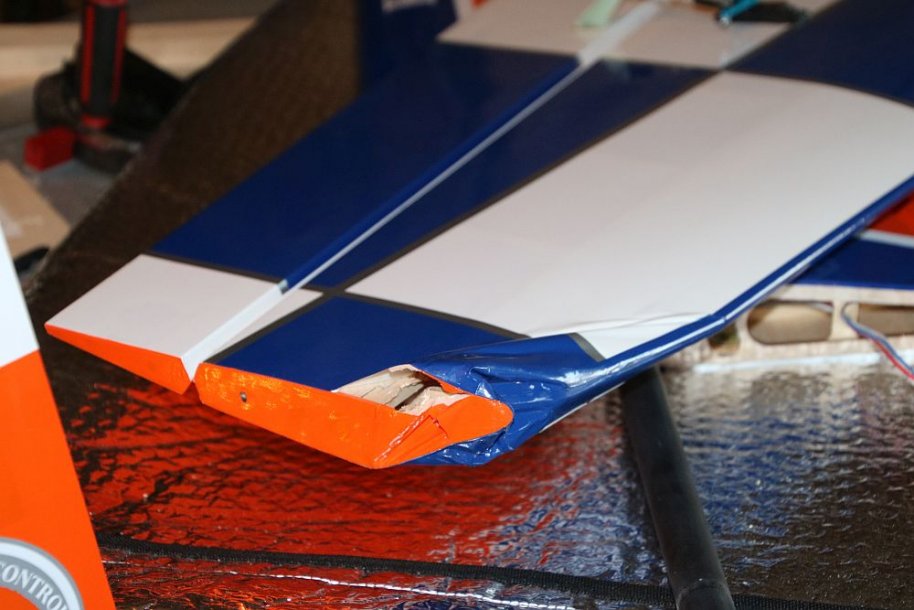

Bad news is I am looking for another airframe.:very_angry::very_angry::very_angry::very_angry::very_angry::cryin::cryin::cryin::cryin::cryin:
Might need to do this tonight.:cheers::cheers:
ericb
Team WTFO
The fuse is pretty bad. I would need a new fuse, canopy, cowl, and left wing. By the time you get all of that, I would be better off getting a new airframe. Maybe a PAU Edge next?:brian-banana:
ericb
Team WTFO
On the plus side, I have stabs, landing gear, and right wing if anybody needs them.

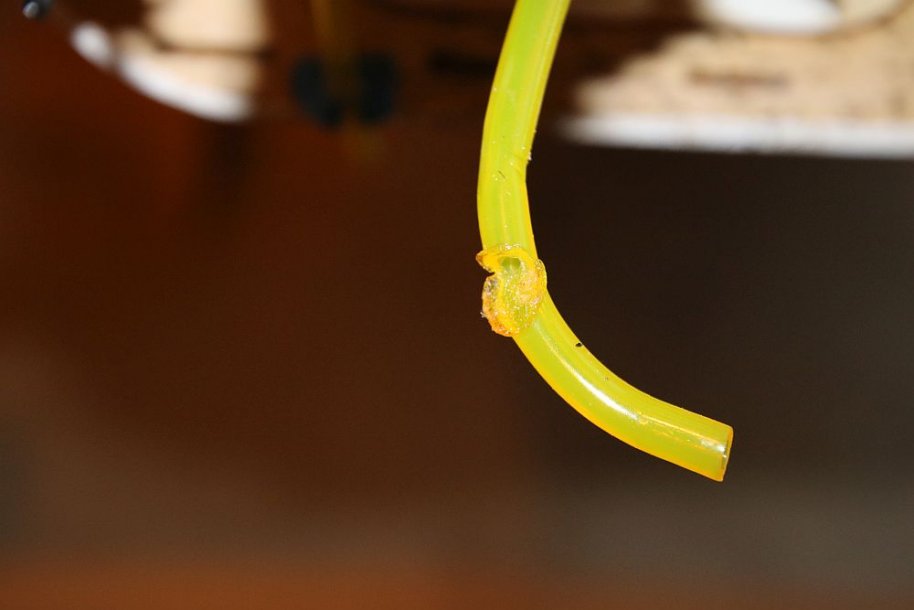

What caused the engine to stall? Mine hasn't ever stalled on me other than when my idle was set too low.
Upon further investigation.....
Stupid fuel line was touching the muffler and melted through. UUHHHGGGGGGGGGG!!!!!
